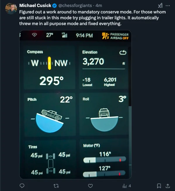

UPDATE: I didn't have access to a trailer, but I went to Home Depot tonight and bought a cheap set of trailer lights. When I connected them, I got a message that was something like "If you're towing a trailer, you should switch to All-Purpose mode. Do you want to?" I tapped Switch and not only did All-Purpose come back, all modes came back, as well as adaptive headlights.
The only thing I've noticed is still wonky (so far) is that the gauge screen doesn't show motor energy/regen.

If you have access to a trailer you might wanna try this workaround...
Just b
@R1Smaximum @StandardR1S_BK You guys might want to try this if you have the ability to plug in trailer lights (or maybe head to the local U-Haul to try) :)
Just bought a pair of trailer lights off Amazon. Just 17 bucks, will be well worth it if this works, and if it doesn’t, hey, I got a pair of trailer lights now!

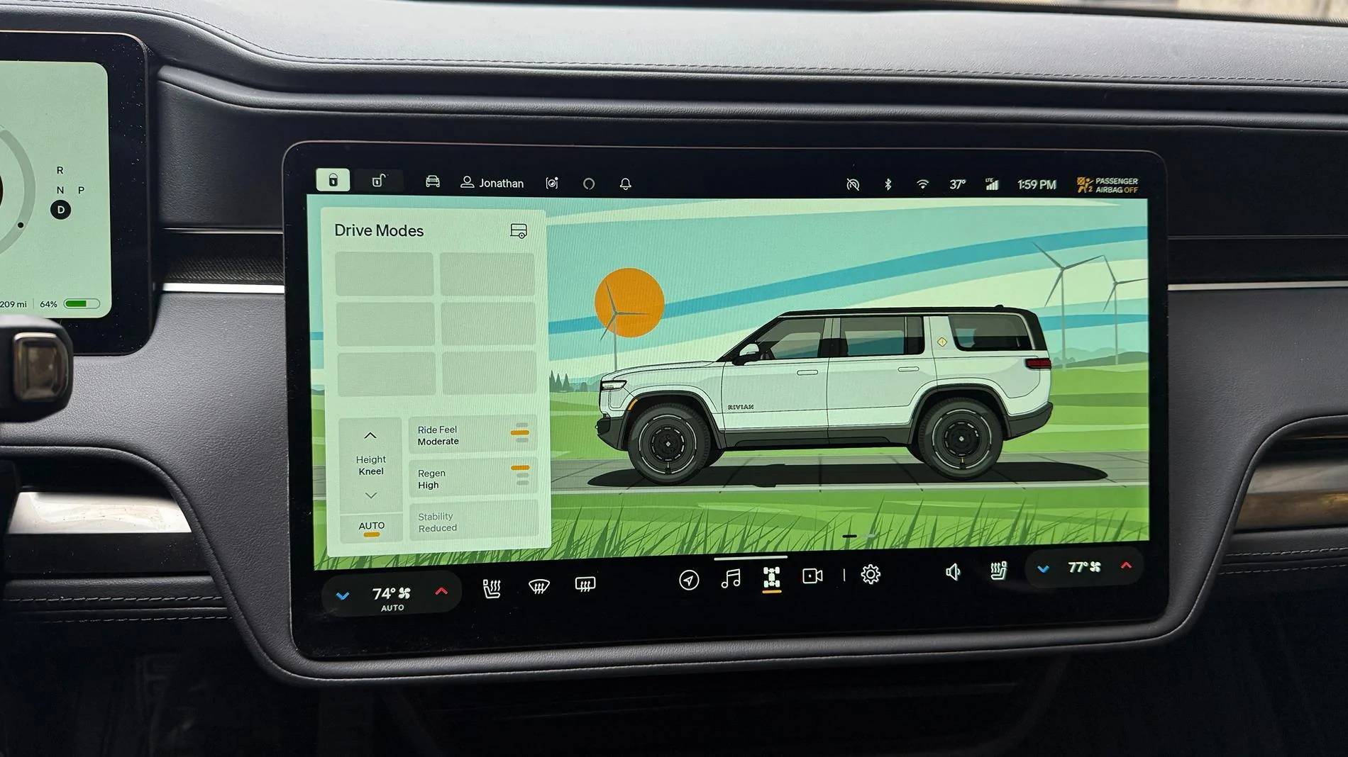

A few nights ago, I was driving our Gen 2 R1S Dual Max, and saw conserve mode was available, this isn’t usual so I was intrigued, thought it was maybe part of an update, I tapped it. Since then, I cannot change the drive mode, all selections are blank, and the powertrain menu is very blank, just shows power distribution, the car is stuck in conserve mode, quite slow and FWD only. Don’t know why conserve mode isn’t officially available on dual motors cause it sure as hell works, but now I can’t get out of it!​
I’ve heard about this issue twice on this forum but regarding sport mode, and one similar case on Reddit with conserve mode like me, I wish I was stuck in sport mode! It seems like an issue with the holiday update since all posts about this are recent so if anyone from Rivian is reading this please look into it!​
I’ve done the two steering wheel button reset, the steering wheel button + hazard reset, all multiple times (waited an hour between the hazard resets), and I’ve let the vehicle sleep, absolutely nothing has fixed it, the car is stuck in this mode.​
Contacted Rivian service about it but quite frankly don’t want to deal with going to a service center for this, is there any DIY solution anybody has found? Or can it be fixed remotely by Rivian?​
Love the car but this is annoying!​
