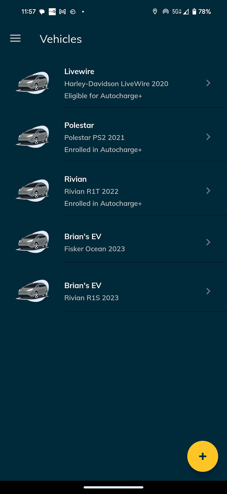

Seems like they suspended the sign up some time ago. No idea why. I had signed up for my R1T but didn't get around to doing it for my R1S. Have not used EVGo since my initial test with it.

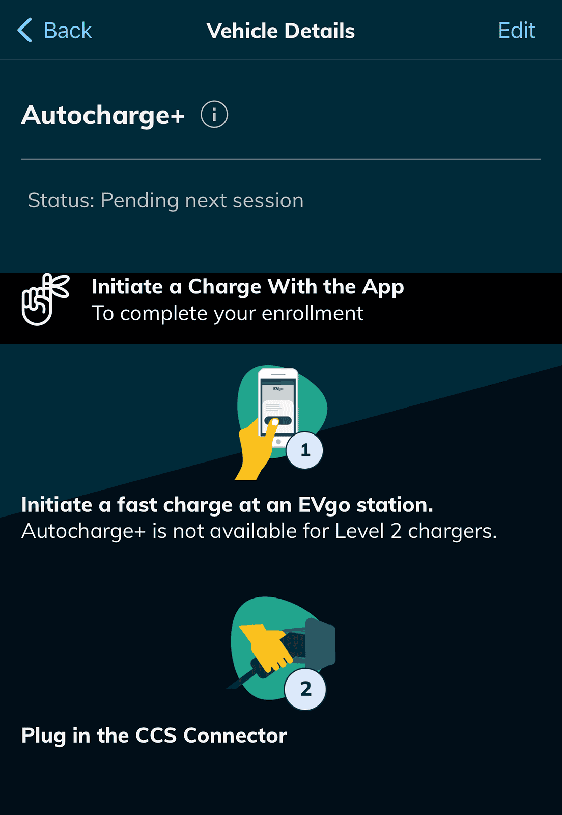

It was at one point. However I recently tried to complete the process and have not been successful. I added the truck to the app, got to the “pending” state that required starting a new charge to complete the process. I have tried at least 2 different EVGo DCFC sites and each time I initiate the charge it has an error and says “unable to enroll in auto charge+” or something like that. I try a few times, then just initiate a normal charge through the app and it works, but still says pending in my app.
