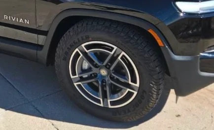

It appears to have Goodyear Wranglers.
They'll have the 3PMSF logo. Just check the tread depth. A quarter inserted behind Washington's head into a 6/32 tread will cover all the space up to his hair. Hopefully we'll get snow so it will mean something to check. In any case hope you have fun.
