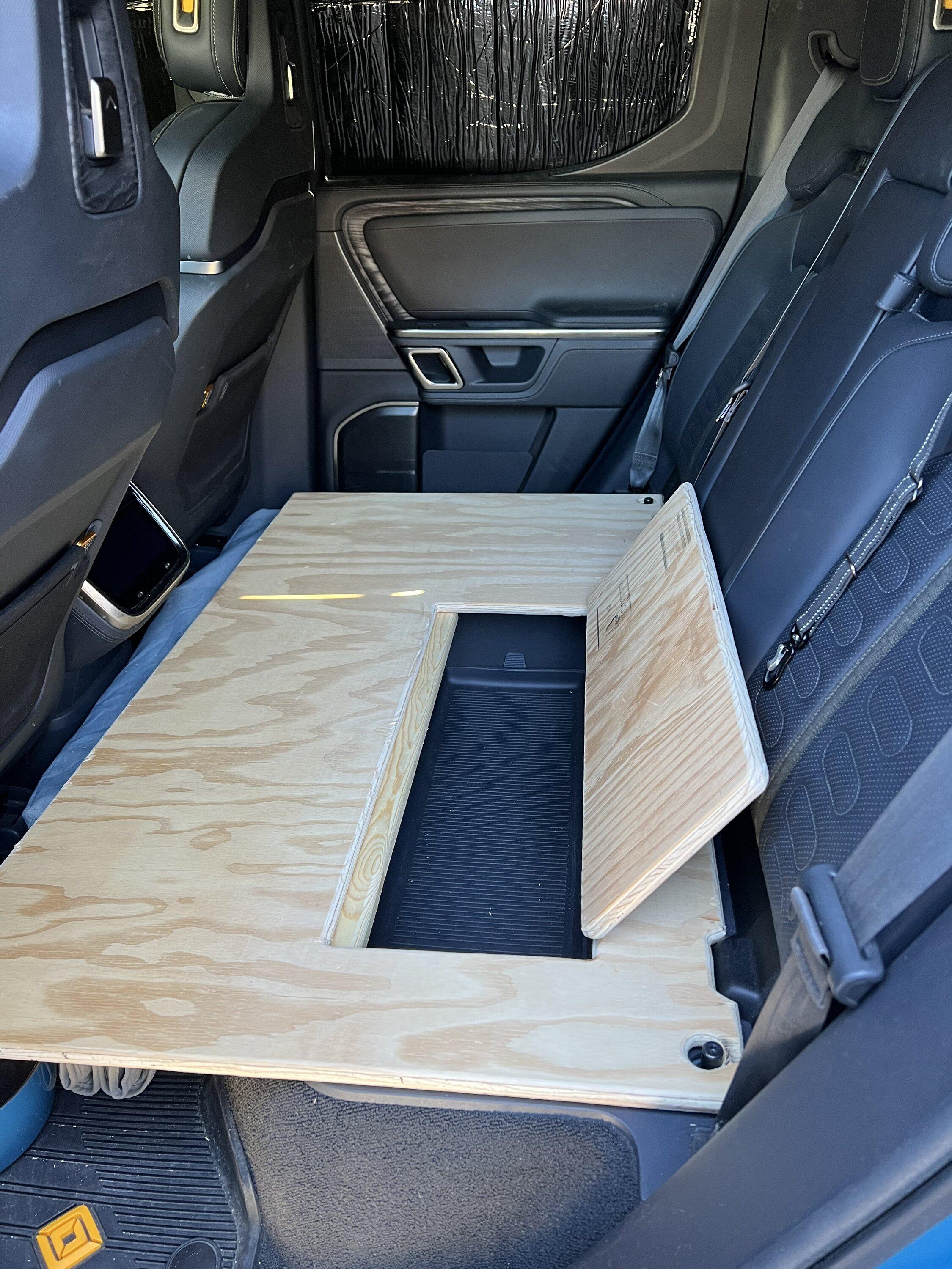

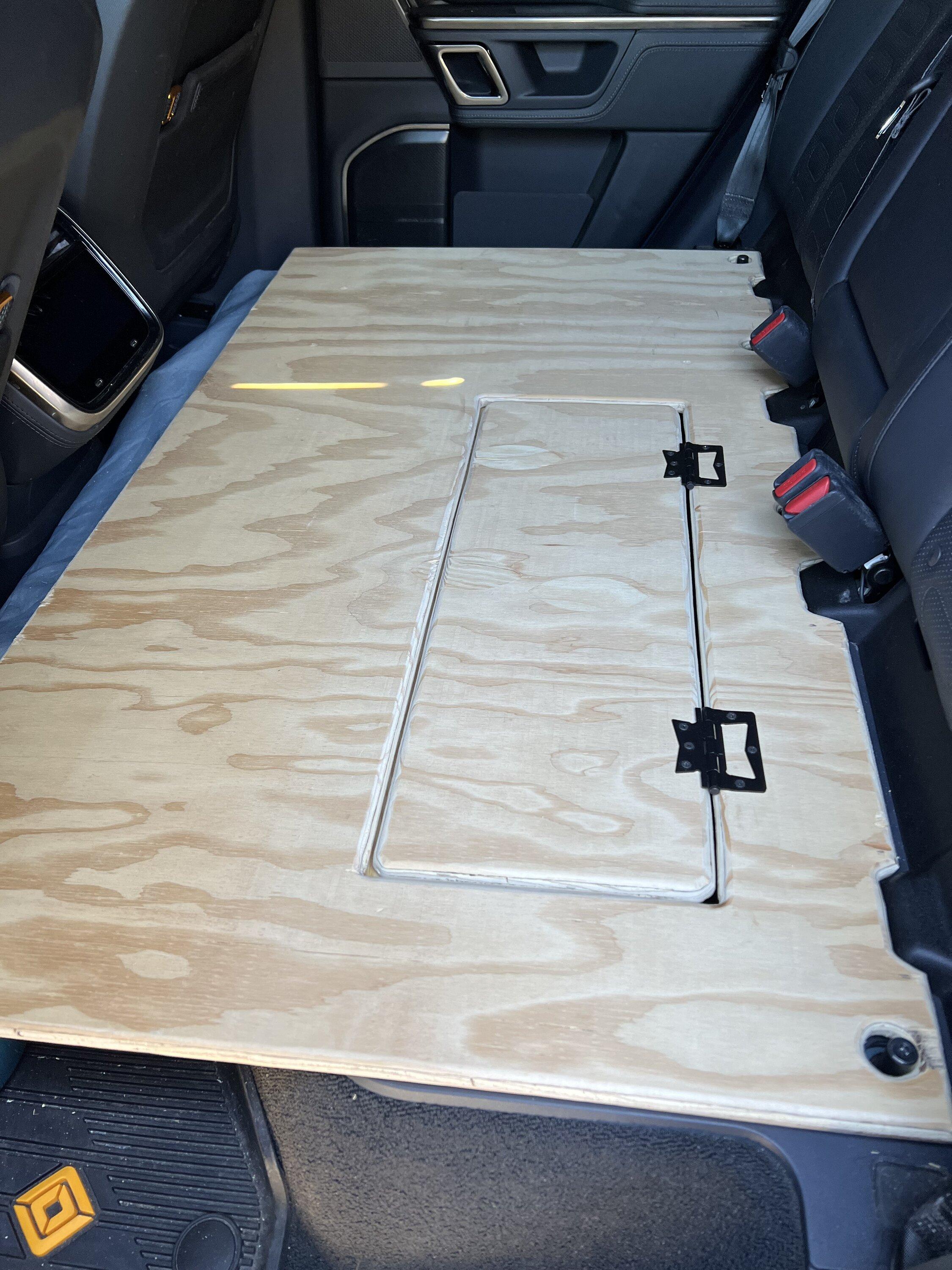

Another progress shot. Latch for the opening is supposed to arrive tomorrow.
I ordered some black automotive carpet too but after playing with the handheld router all morning I’m less sure if I want to use it.

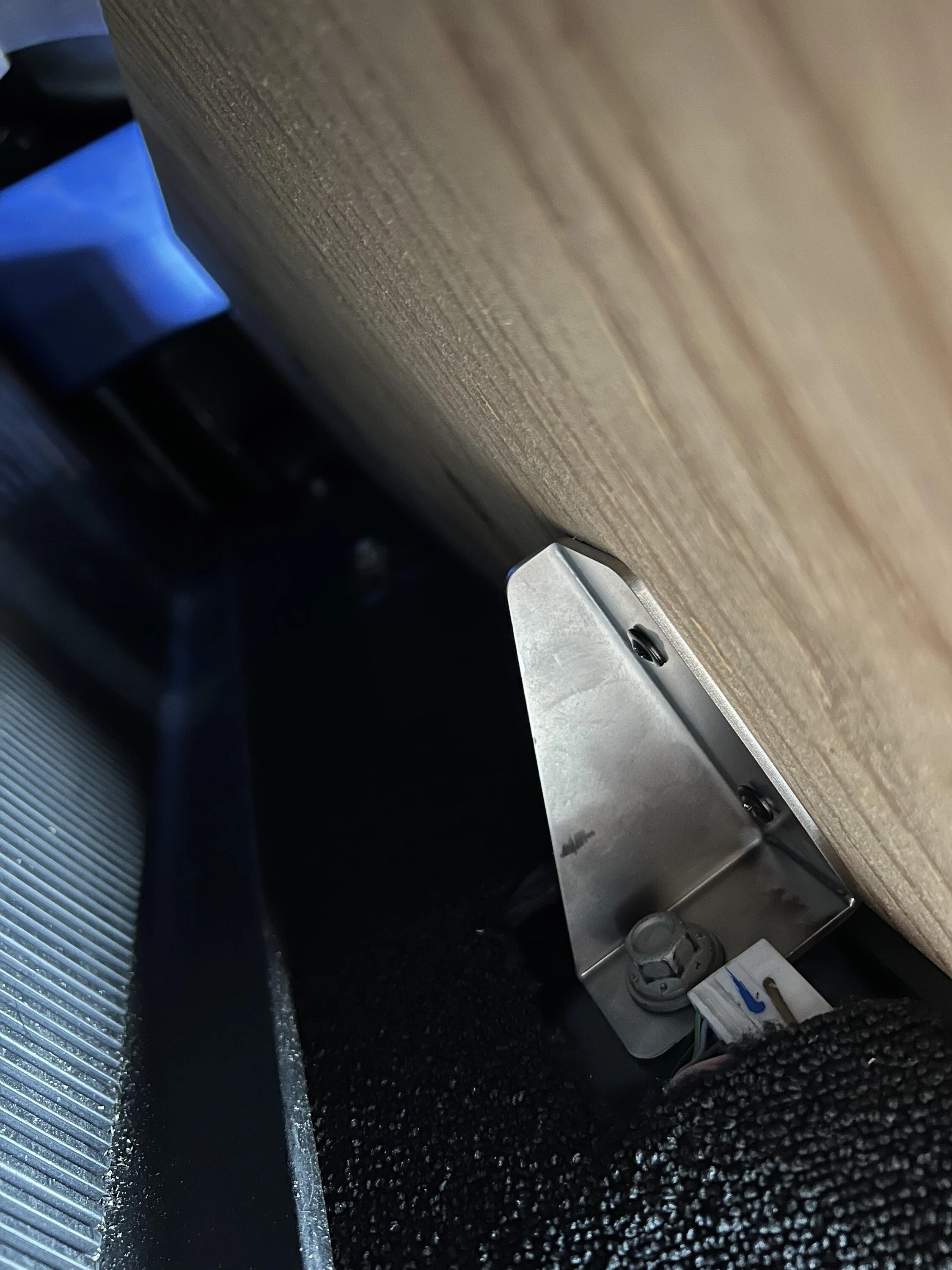

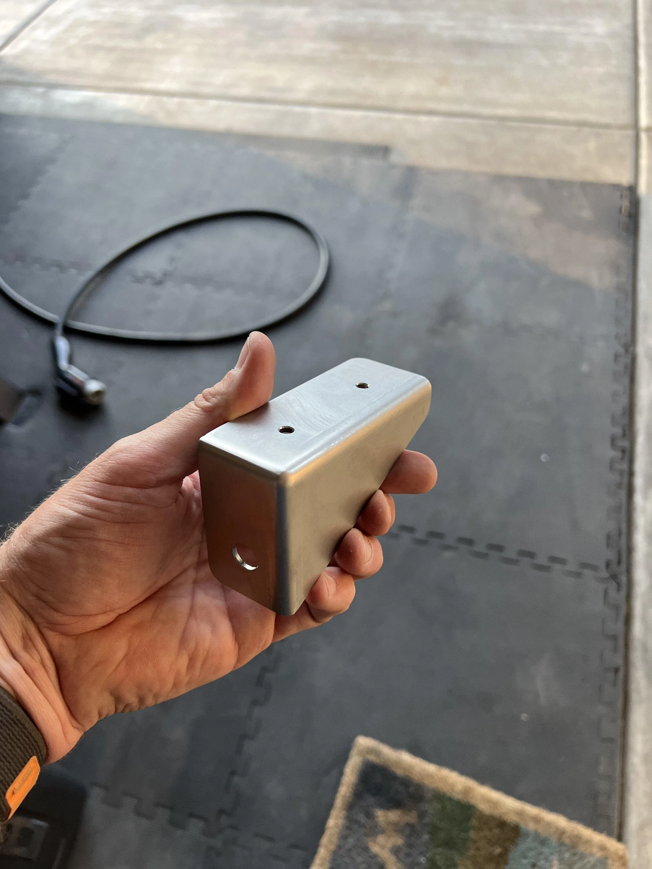

Finally got this thing strapped down thanks to some nice bracket work from @LivingInKaos.
Used the same bolt that holds the seat on either side, I used one on each side but have extra brackets if I decide I need another in the middle.

@jjswan33 I forgot to ask, are you still going to cover the plywood with automotive carpet?
Always here to help :)
