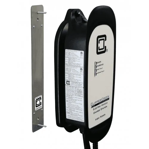

Just to clarify, code requires that any stationary unit (regardless of amperage, etc) with a plug be mounted in a manner that allows tool free removal. There is no way to do that with the ChargePoint Flex.

Since I installed it hardwired, it would not fail for the "fixed in place" (tool free removal) requirement for any stationary equipment using a plug. This unit cannot be plugged in and meet NEC 625.44. It also would not fail for the GFCI outlet required in 625.54 since ChargePoint states that if a GFCI outlet is required by code, the EVSE must be hardwired. The GFCI requirement is somewhat contradicted in 625.22 where it specifies that the required personnel protection system can be located in the EVSE itself.

Maybe it's up to your local department's interpretation, but in my jurisdiction, our Chargepoint Home is screwed to the wall and uses plug-and-cord (Allowable under B for "stationary equipment"). The code says stationary just means it's installed in such a way to permit ready removal -- it doesn't say you can't use simple tools to effect such removal.

The unit under discussion is the ChargePoint Flex, and not manufactured by Clipper Creek.

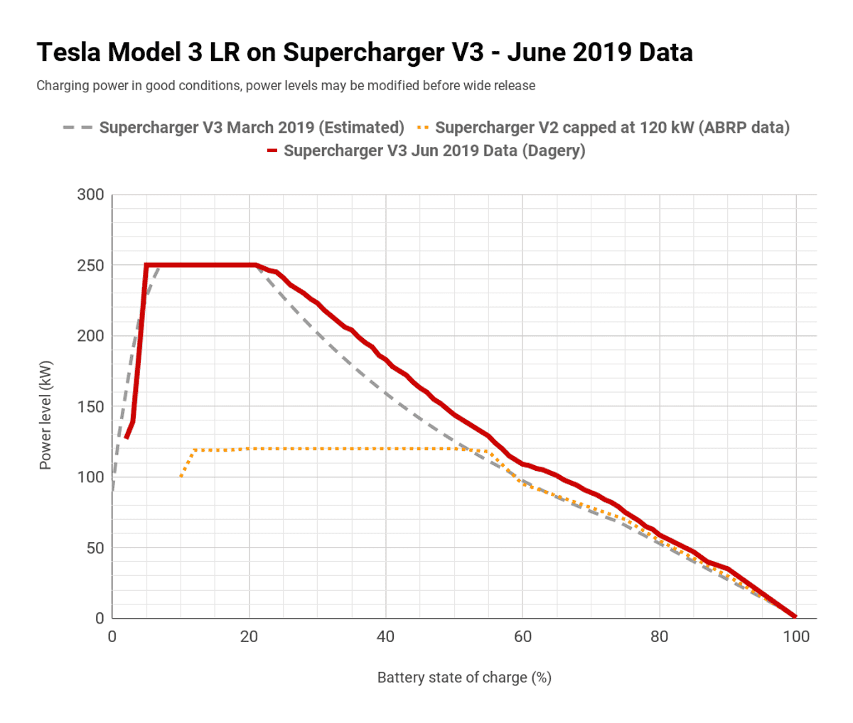

#1. Charging slows considerably as the battery fills. When DCFC on a road trip, it is very likely to be better to charge to only ~80%, and start the charging session with as low a battery % as you are comfortable with (and circumstances dictate).
An example from a Model 3
Rivian R1T R1S Range and charge time for full battery 1605833520872
Rivian is promising sustained charging at over 200 kW. We'll see what that actually means when people get production spec vehicles to test.

They also said 140 miles in 20 minutes. My guess is they selected those exact specs because there is a peak in the curve rate that roughly aligns with that.
That number matches up with charging at approximately 190Kw for 20minutes. That also represents 45% of the battery. Almost all vehicles today, except Tesla, do not have significant taper until reaching between 50% and 70% SOC. so ,if you assume a starting SoC of 10-20% and ending at 55-65%, then the 140miles in 20 minutes makes perfect sense for 200KW charging rate.
