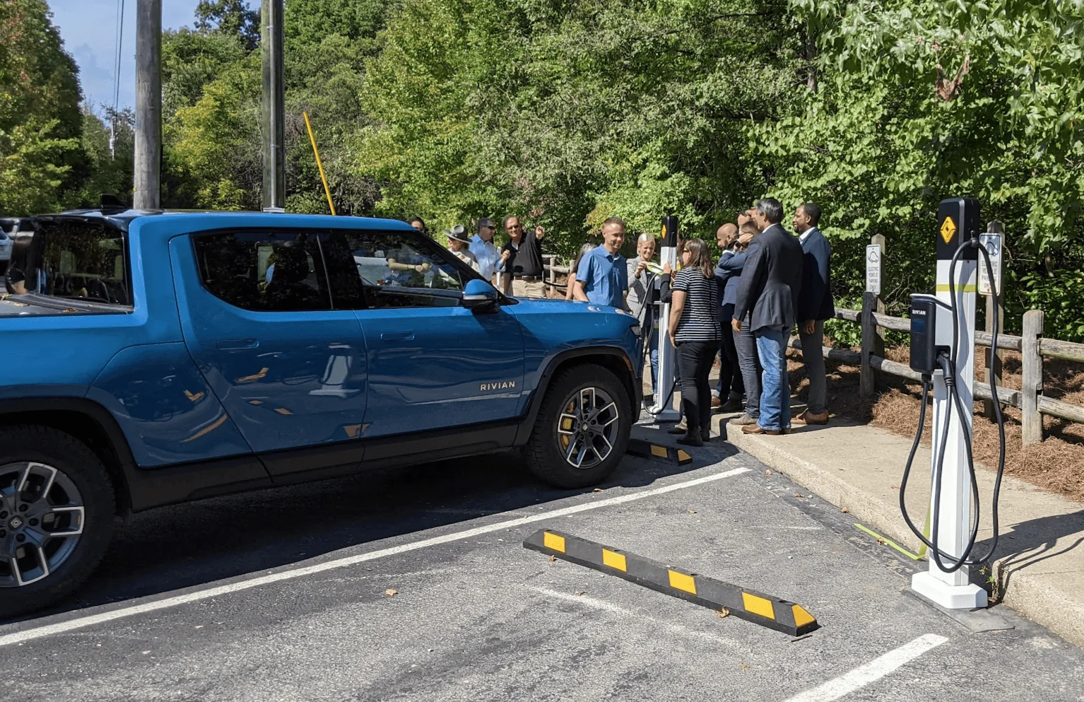

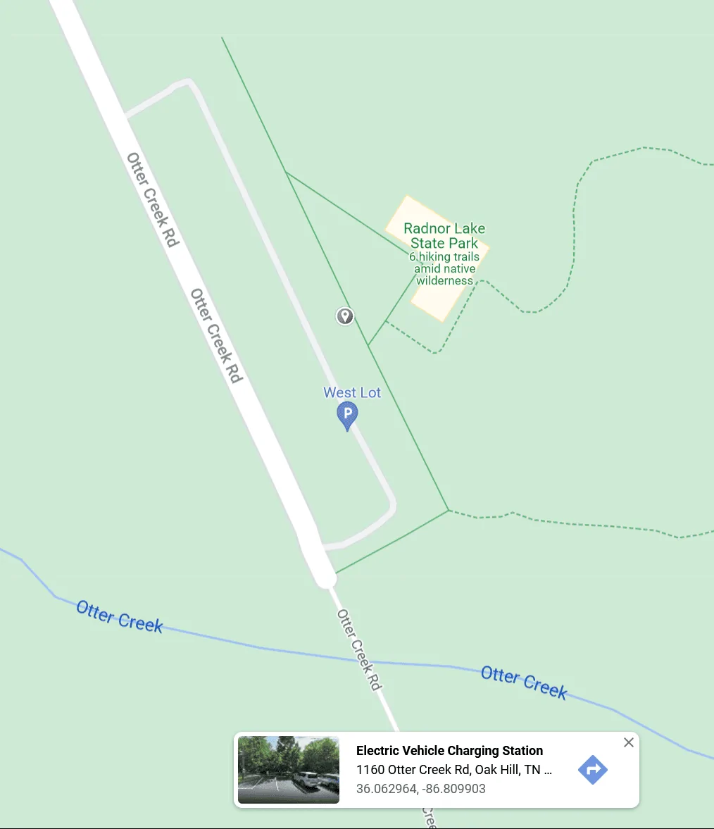

Rivian replaced two Blink chargers with their own at Radnor State Park in Nashville as part of a deal with TN State Parks. Opening ceremony was October 1st. 36.0619989,-86.8097135
Are these L2 or L3?
