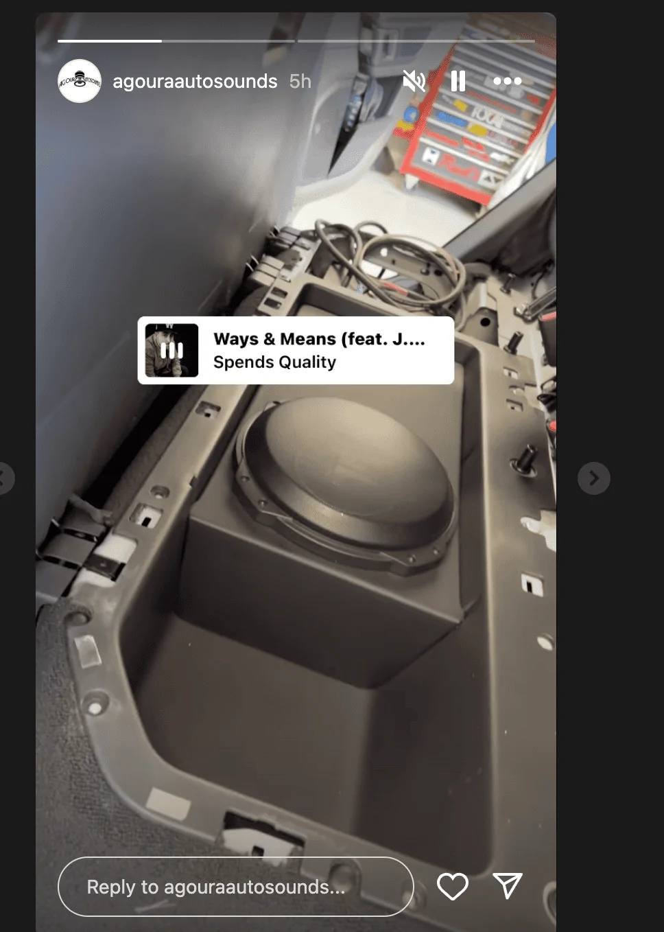

I dropped my truck off for my install yesterday. Excited to see how it turns out:
-Helix Audio V12Mk 2 DSP Amp
-Blam Audio Live 3 way components front - 6.5 power series
-Blam Audio Live coax rear: keeping the tweeters away from driver ear.
-Center channel Speaker - to be named later
-JL Audio 10TW3 shallow sub in custom enclosure under rear seat.
-Alpine mono sup amp
-Sound dampening in the doors and bench seat.
It's my first time working with Agoura Autosounds, and i can say that Jaime is a true craftsman and a pleasure to work with.

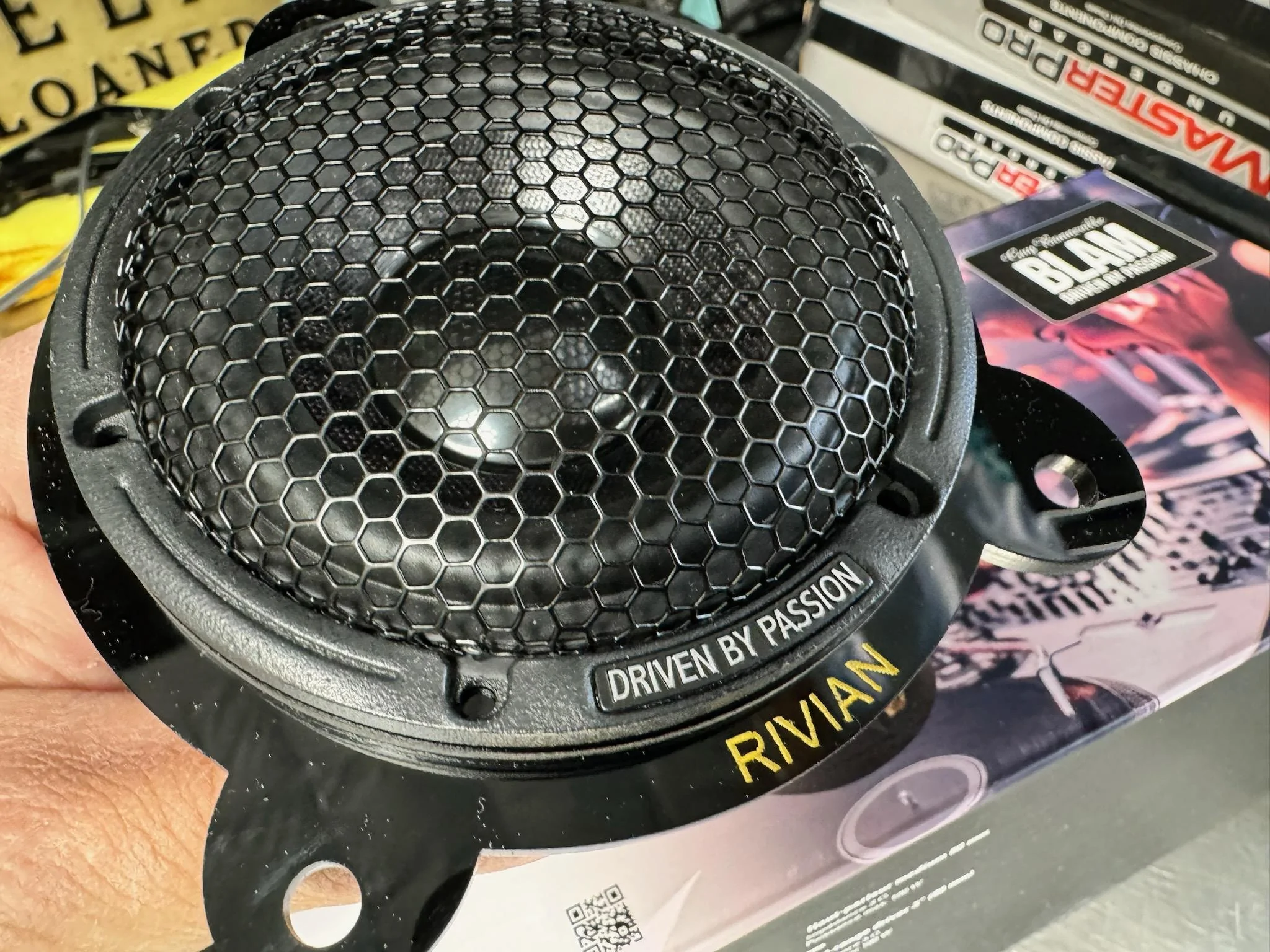

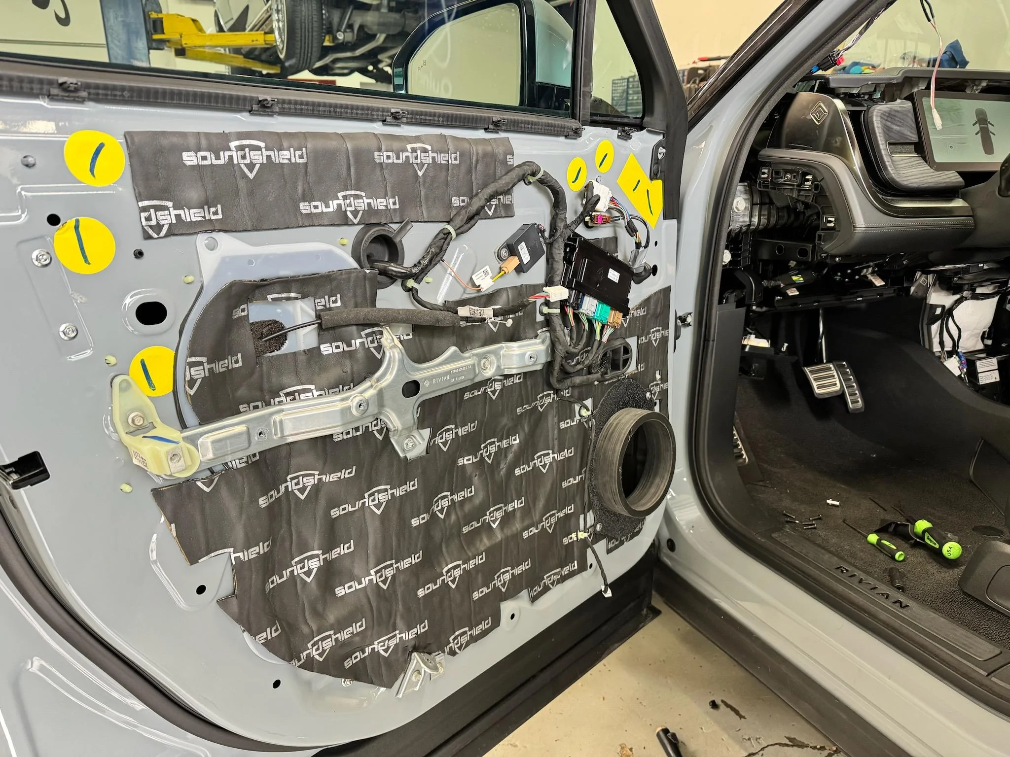

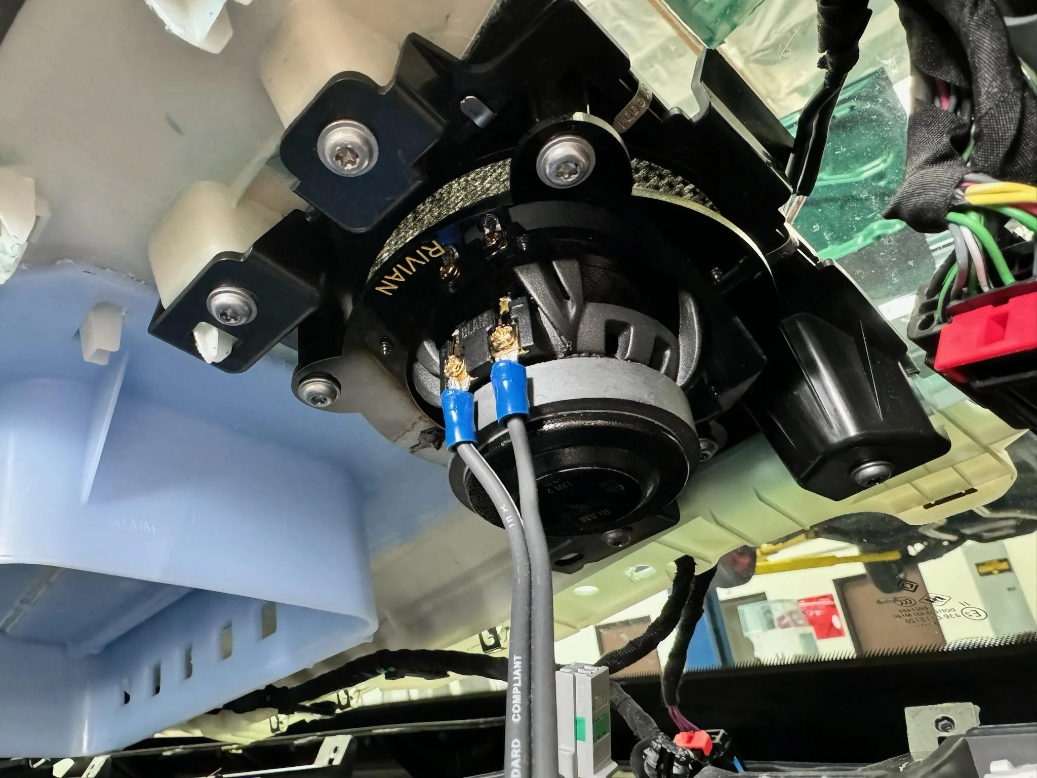

More pics from the install. I'm so impressed by the attention to detail. Juan (owner) adds spacers to help the speaker project into the cab of the body, which helps with acoustics, and adds foam between speaker and door to avoid rattling.
It sounds great, and and the cabin volume is much quieter (which makes the music sound even better).

Well.. I spent a good bit, labor alone was 2500 for 3 days work.. But you get what you pay for, and I've had installs in the past that you could just tell were off.
From what I understand, the issue happens if the amp kicks on with the same timing as the rest of the system, rather than on a delay. The car's not expecting that much of a draw right away and thinks something's wrong. I'm not sure if my dsp/amp is where it got handled or if he added additional components to handle the drop.
As for the noise difference, i am recording about 68/70 db on a smooth road now. Seems notable. Only deadened the doors.

We did pop in different center (Audiotec Fischer Matchup X4), because the 12 channel gave us space. I was initially considering an 8ch, but the 12 channel allowed us to wire each speaker to a channel AND keep fader control. Otherwise I'd have bypassed the center ch, the imaging from a good speaker/DSP can more than make up for it.
Thanks for the words, can confirm that It sounds great. I'm typically a focal fan, and I think BLAM is a great alternative. Really like the highs compared to focal tweets.
I'm coming up on 30 h listening time, after which we'll go back and retune a bit now that the speakers are broken in and I have more experience listening to a variety of music. I'm thinking of trying to cut off some low end from the rear door speakers and let the sub do more work down low. The DSP has a LOT of optionality. I looked at the documentation and decided not to mess with it myself, which is... rare for me.
