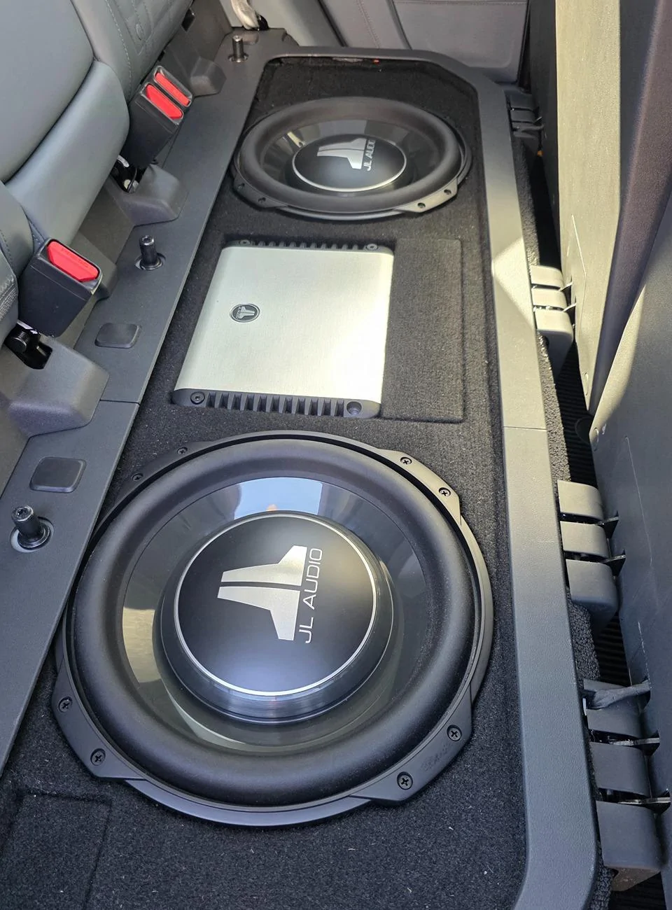

What amp are you going with? I'm looking at adding a second battery to power my JL HD1200.1 because the existing 20Ah battery doesn't have nearly enough spare capacity. I immediately triggered the 12V service warning the first time I turned it up! ?

Once installed, I'd recommend hooking a multimeter directly to the 12V battery and play a very bass-heavy song at high volume. If you see any considerable voltage drops, it might be worth investigating a second battery.
My personal option, I think you'll be totally fine with a 250W amp, though.
