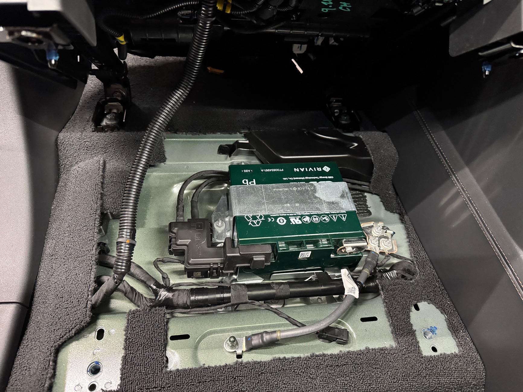

Thanks! Removing/tilting the seat back was easy. Now for the fun part...

Is that battery laying on it's side now? From this view it looks like a regular top mount SLA battery just tipped on it's side?

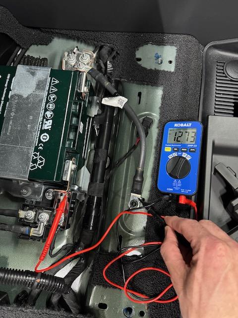

Sure here’s another view.

Did you tap into it? Looking at doing that to add a 12v (cigarette) plug in the front.
too busy with work. Just had time to finish running the power wire to the amp location. Will try this week.

Have we confirmed that it's a SLA? Could it be LFP? The plastic bit on the top seems unnecessary unless they have a BMS for it in there. Having it inside the cabin also make a better case for LFP since its a little less exposed to elements and easier to heat.
Says Pb on top which stands for lead. I’d guess it’s still SLA
? we can always hope. LFP is the way to go. Switched my travel trailer battery over ...the only challenge is charging them when its below freezing...for that reason heating provisions are also needed. I understand why Rivian isn't doing it though.
