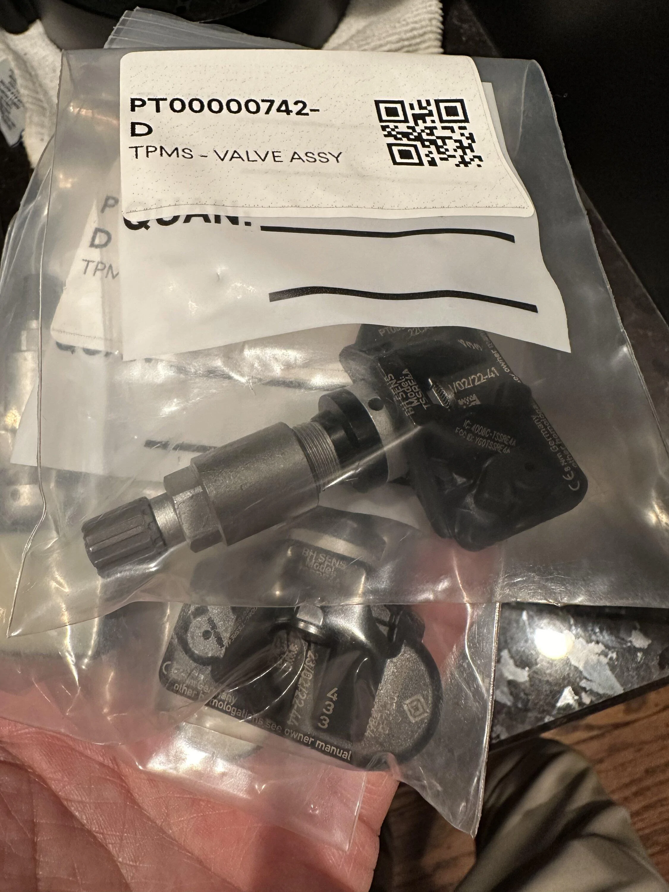

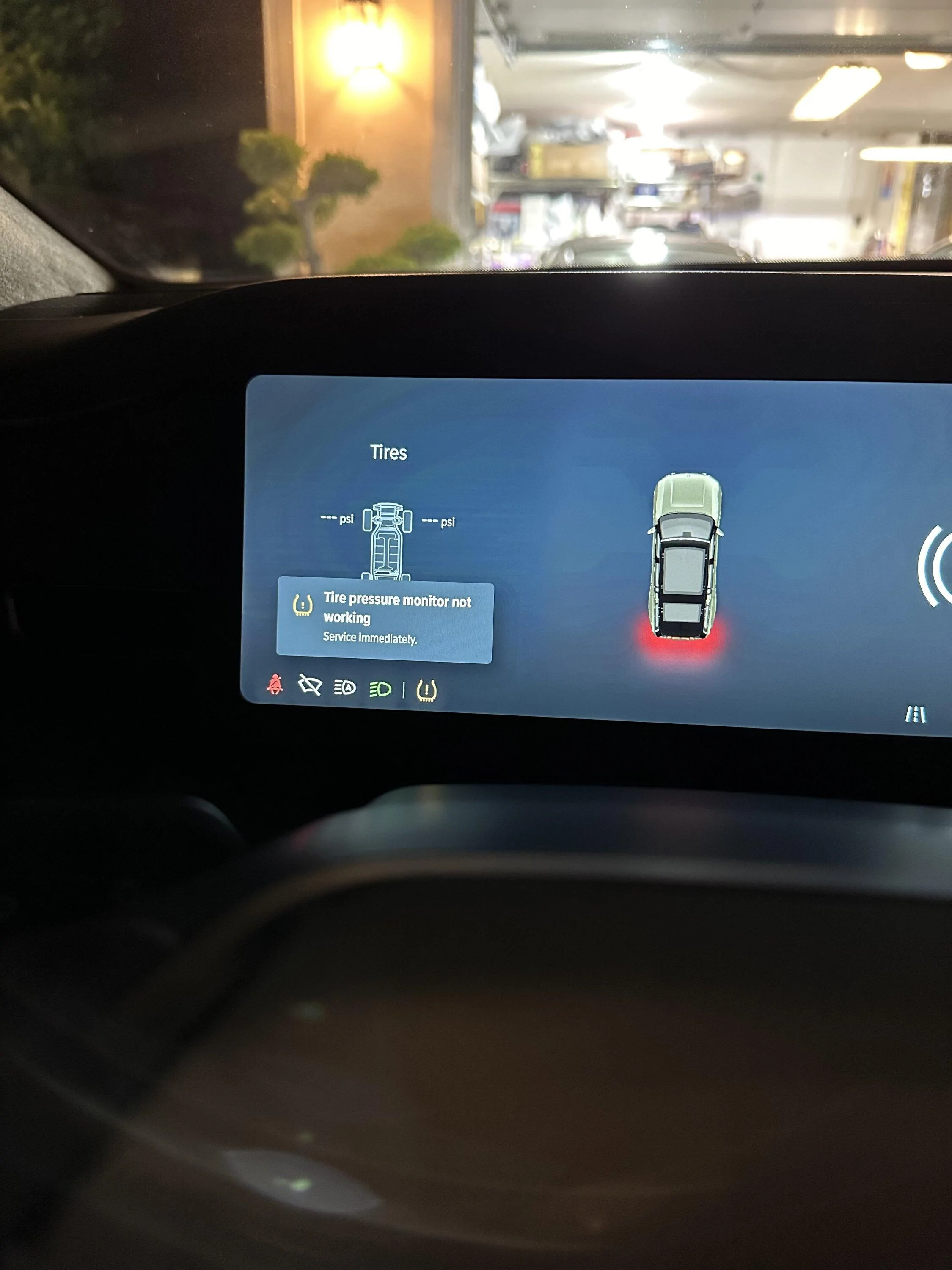

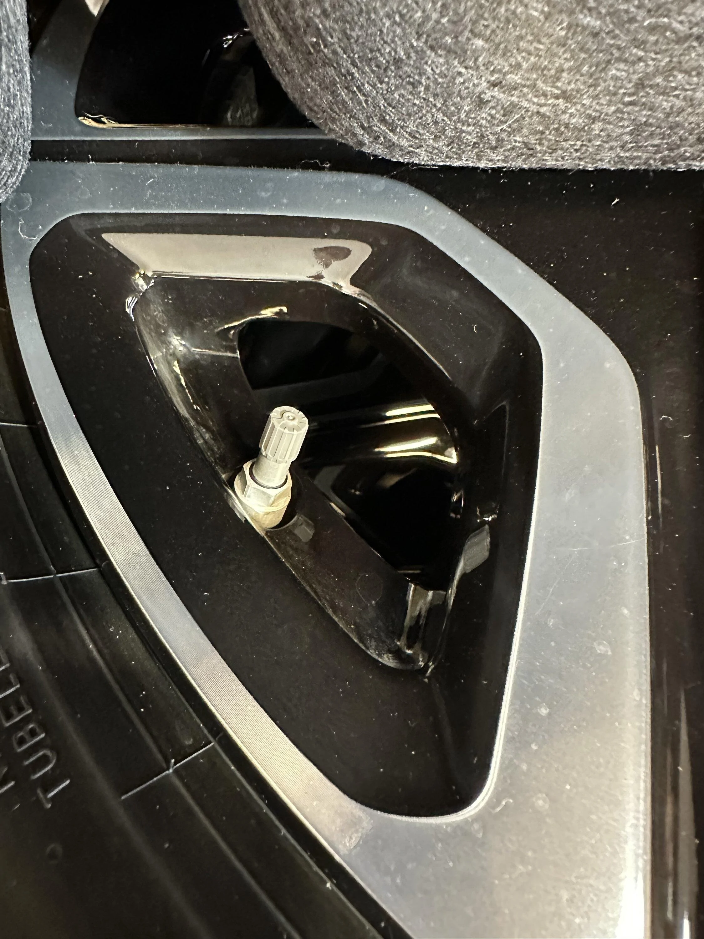

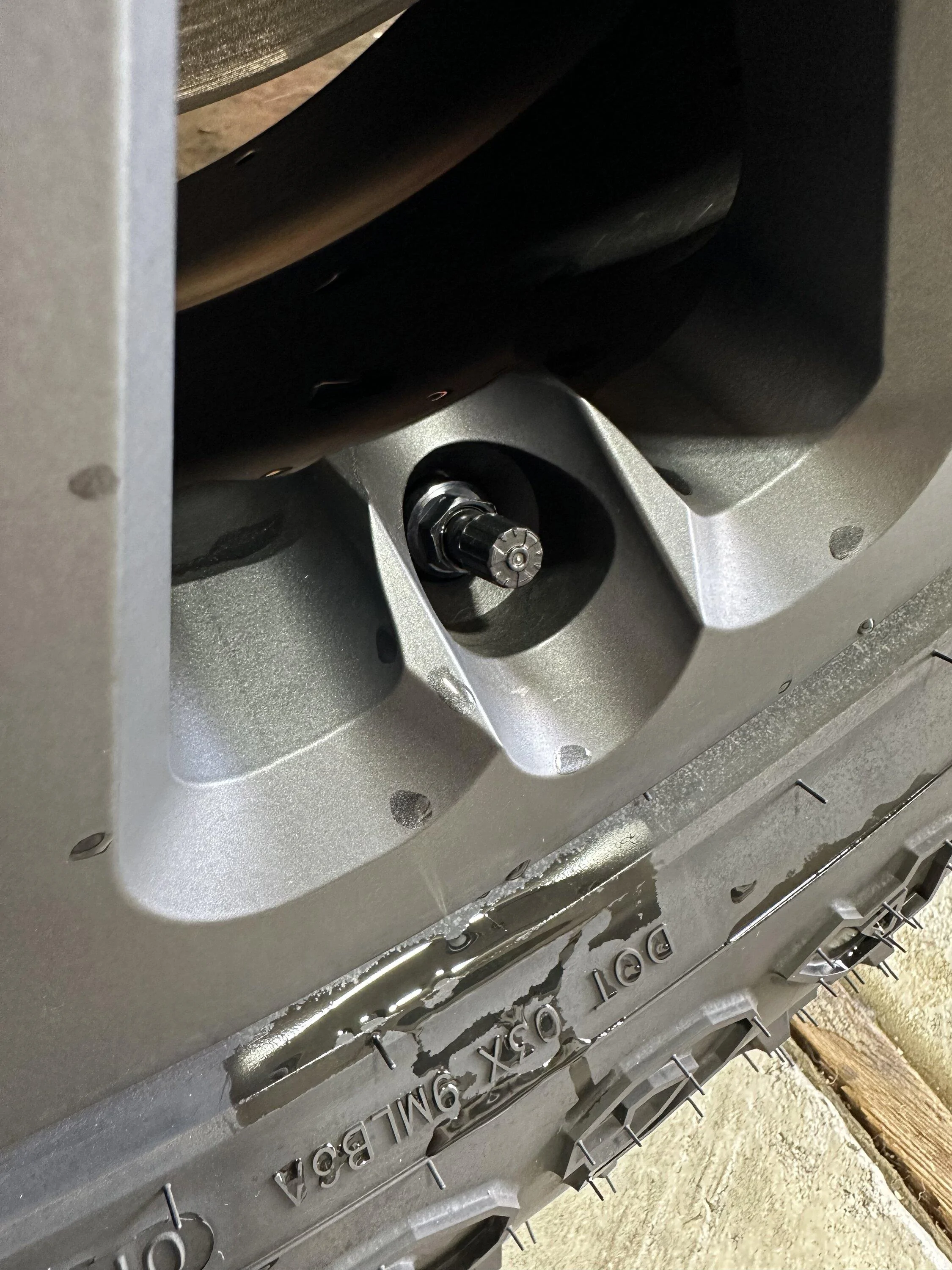

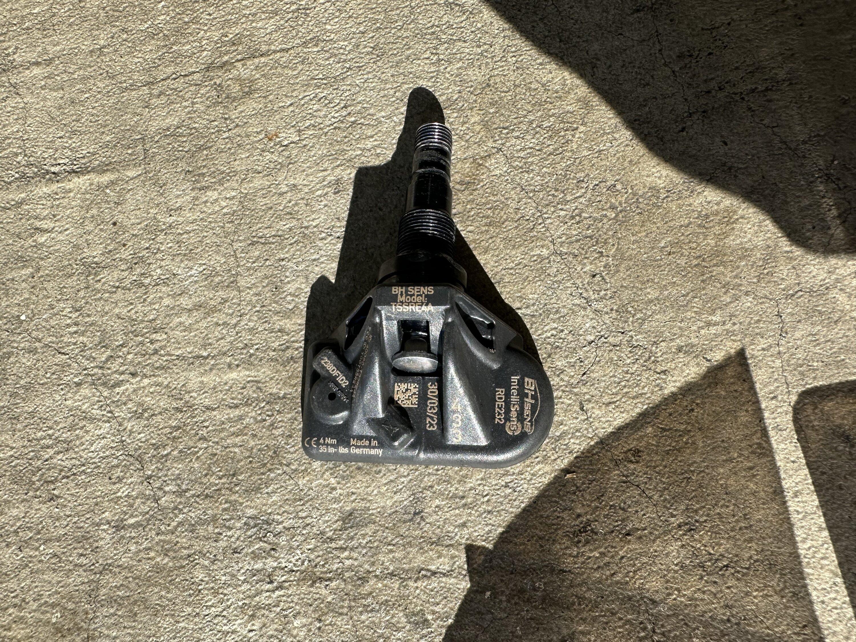

So I've been having TPMS issues. I ended up purchased the OEM/Factory Rivian Sensors from EVSportline since they are "plug and play" with no programming required. Without really knowing what to look for I just took their word and had them installed. I got an error the first night and figured maybe I haven't driven enough. The next day I drove it to work to put more miles on and even did a reset to see if that would resolve the issue, still no luck.
Rivian R1T R1S R1SKY Launch Green R1S Build Thread IMG_1328
I started emailing EVSportline support, they asked me what color the valve stem was and I said it was black and they confirmed these were correct and were direct from Rivian. My 22" Sport Brights have silver stems so I was still skeptical.
Rivian R1T R1S R1SKY Launch Green R1S Build Thread IMG_1340
Rivian R1T R1S R1SKY Launch Green R1S Build Thread IMG_1338
I was then told 3 times over the span of 2 weeks of emailing back and forth to drive more and to reset my car. If that didn't work I had to schedule an appointment with the Rivian Service Center to fix this issue. I was waiting for them to offer to send replacements, but I had to ask and when I did they flat out didn't even acknowledge my request lol. I thought that was bit ridiculous that I had to basically deal with it myself, I bought OEM TPMS that were supposed to automatically connect from the get go. I also couldn't book a SC appointment because they were booked out completely. I eventually called they were way more helpful and said they would send me new sensors and help straighten this out after explaining my experience with the email support.
I got the replacement TPMS and of course they are silver stems and have Rivian logo stamping on them. So they did send me the wrong TPMS sensors despite telling me they were the correct ones.
OEM silver stem TPMS
Rivian R1T R1S R1SKY Launch Green R1S Build Thread IMG_1500
Wrong black stem TPMS
Rivian R1T R1S R1SKY Launch Green R1S Build Thread IMG_1517
I got them swapped and within 5 mins the TPMS error cleared and were reading the PSI at each wheel.
I waited for a resolution to type this whole thing up because I didn't want to drag this thread down with updates.
Eventhough my initial experience was bit frustrating with EVSportline they ultimately righted the ship and the phone support was really helpful. I just want to share my genuine experience and I really wanted to share this incase any others need to order TPMS they at least know what to look for before installing.
I now need to chase up EV Sportline once again to get reimbursed for the $100 to get the TPMS swapped out.

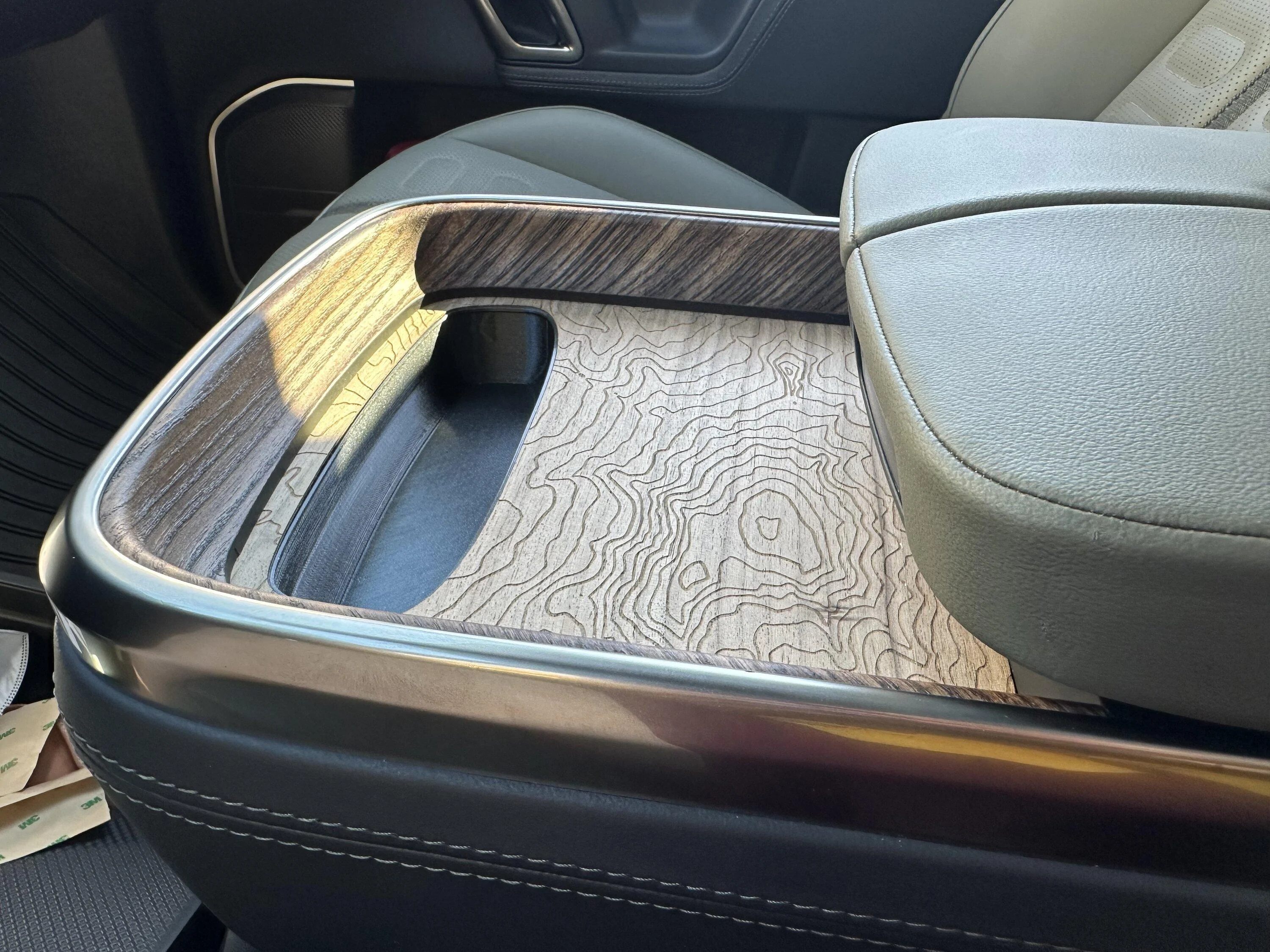

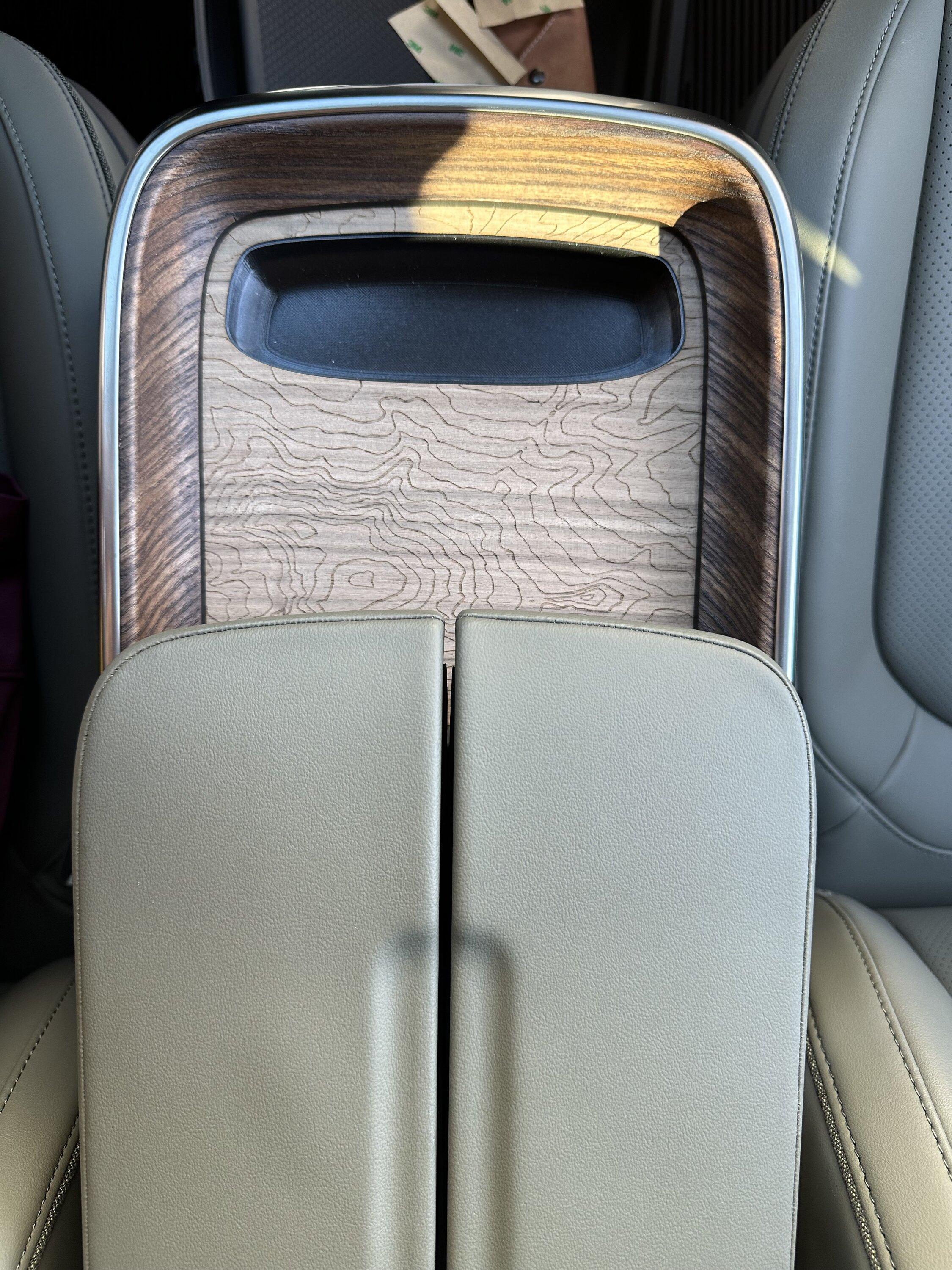

I also added the S00nish Premium Phone Charger. It took a bit of time to just get it all lined up right, but in the end it looks great! I went with the raw walnut color since in my opinion it seemed to go best with the FE interior.
Rivian R1T R1S R1SKY Launch Green R1S Build Thread IMG_1352 2
Rivian R1T R1S R1SKY Launch Green R1S Build Thread IMG_1351
The only issue I have noticed is when the charging pad area gets too hot from sitting out in the sun it won't charge. I tested this by putting a towel over it on a hot day with the car in sunlight and the charger worked! So maybe it's time I consider nano ceramic tint for the windows.

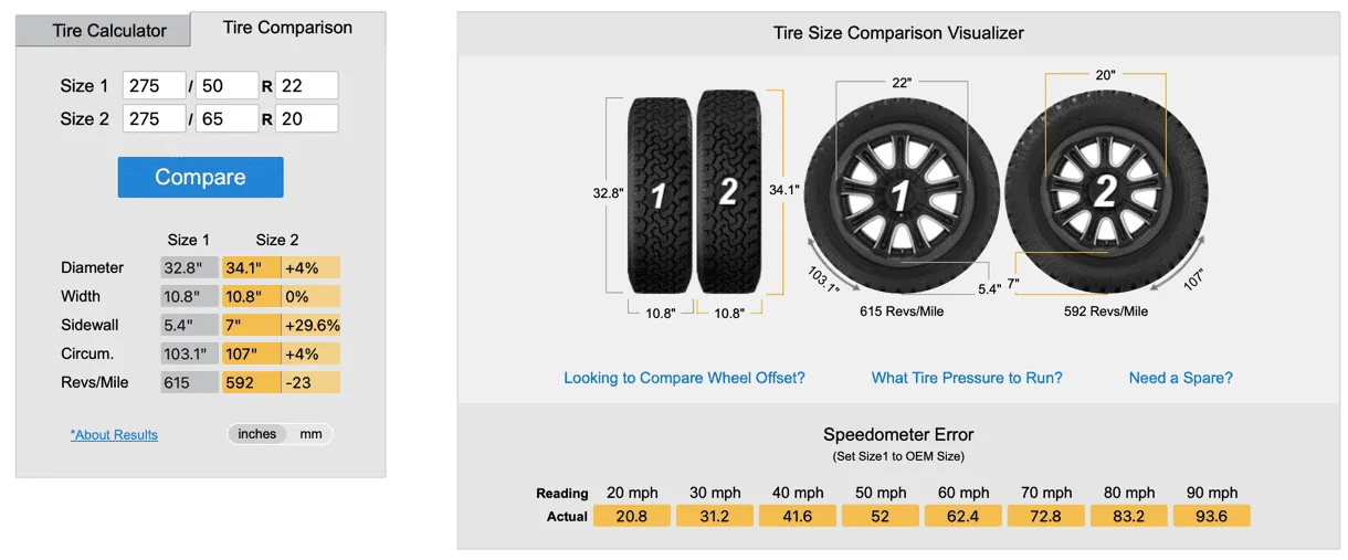

In the old days when you changed wheels/tires from factory set you had to change the little transmission speedo drive gear accordingly or your speed and odo reading would be out considerably...dont know how this works with the comuter on wheels???
R1SKY
R1SKY
Kyle
Jul 14, 2023
73
SF Bay Area
991.2 Turbo, 997.2 GT3, 1966 GT 289, Lucid Air GT
This is true, but also depends how drastic the tire changes are. Since I switched from a 275/50/22 to a 275/65/20 the speedo difference won't vary too much. Though I should get a set of OEM 20" ATs and get the service center to recalibrate the car for the 20" wheels as I am sure it accounts for other changes beyond just the speedo.

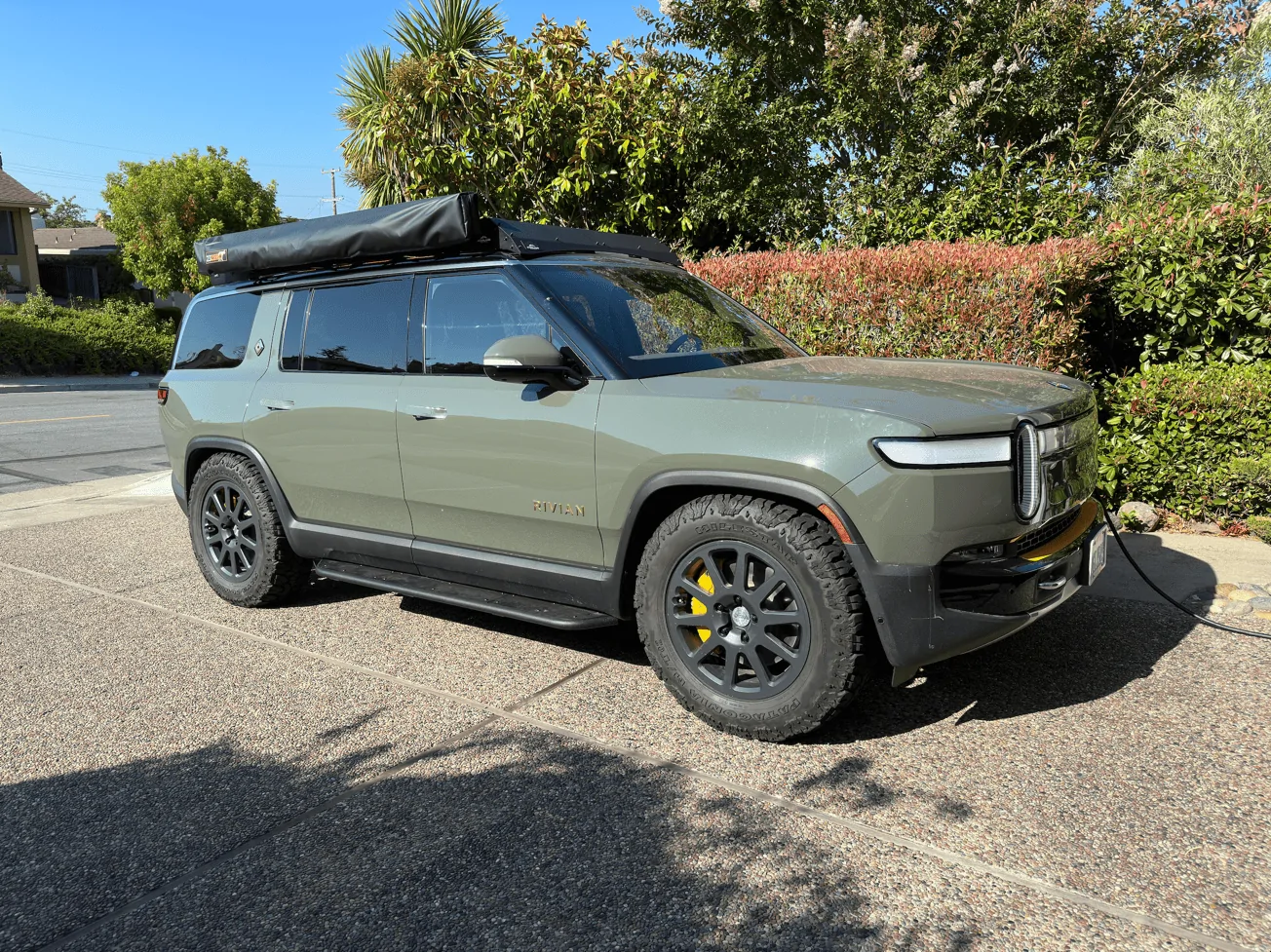

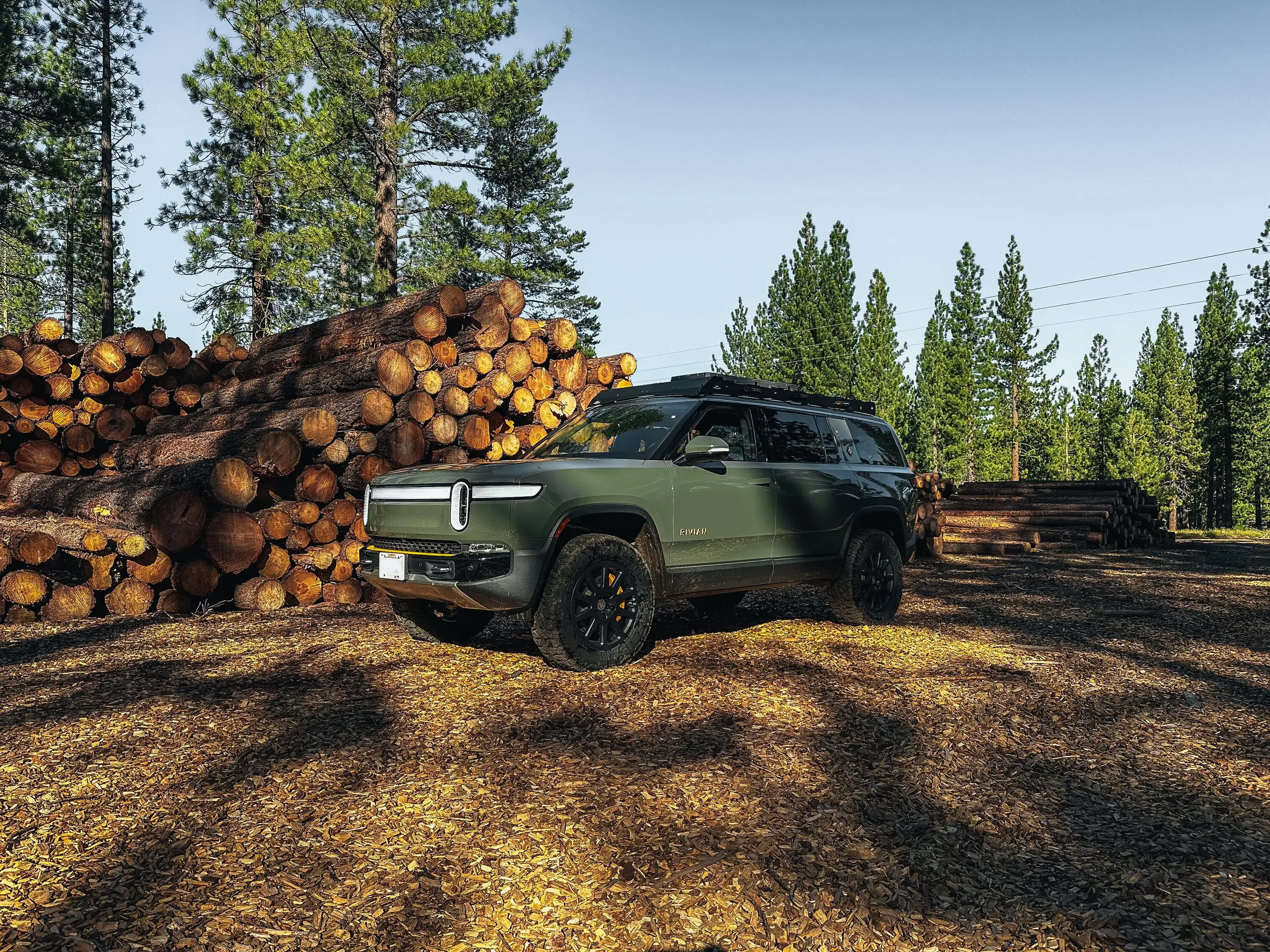

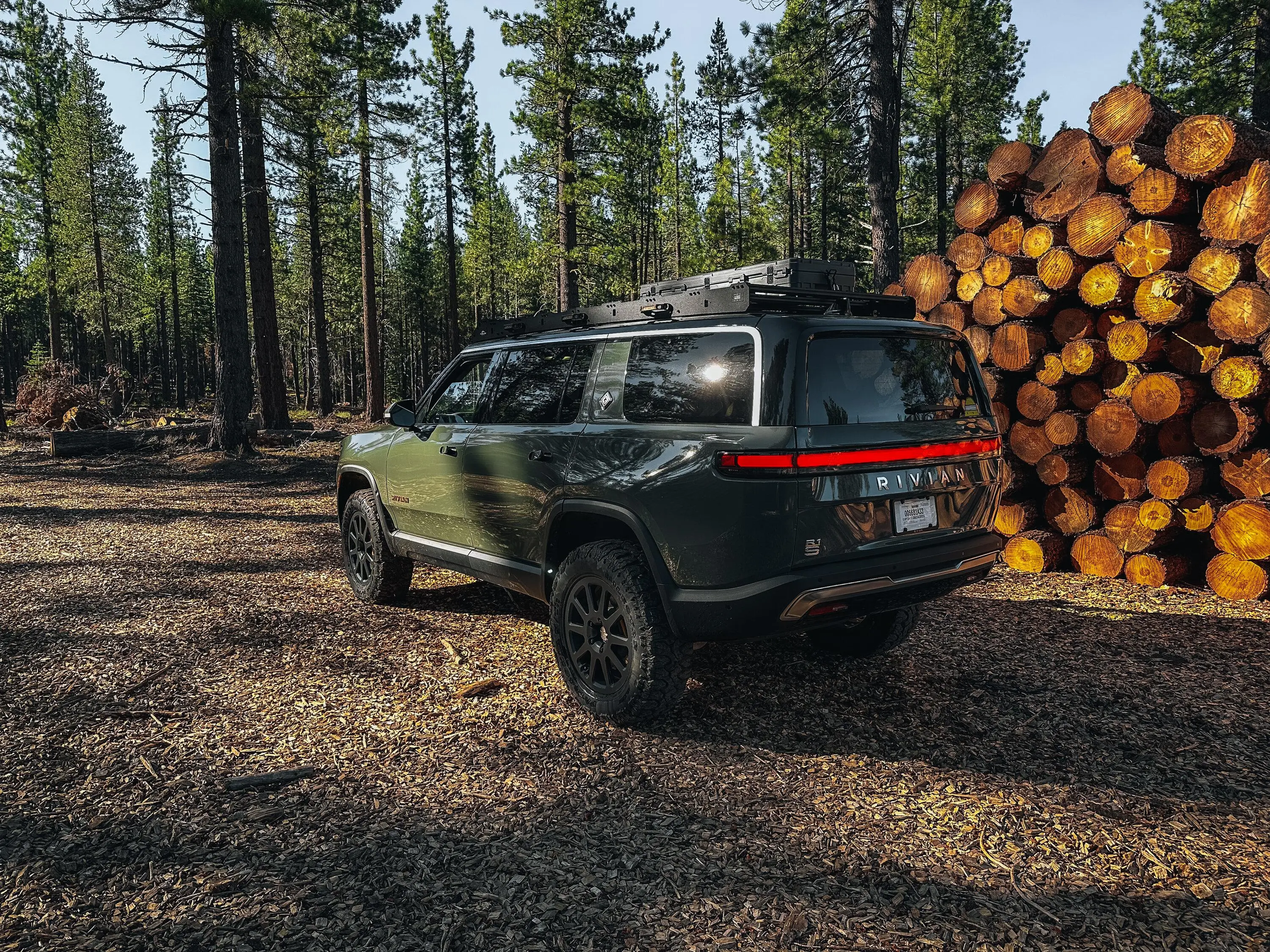

It's been a while since my last update.
Ended up in the South Lake Tahoe are and got a chance to do some exploring and try out the Sacramento RAN stations for the first time.

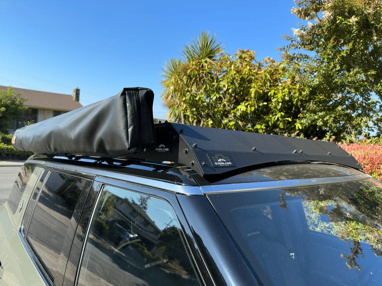

I've added the Overland Ruff Rax Roof Rack, super excited with this now that I get some extra space up top for storage. I no longer have to have recovery gear stored in the car.
I've also added the 23Zero Peregrine Full size 180 Awning. I thought about a 270, a few of my friends have 270s, but I didn't think it'd work considering the liftgate comes up pretty high and would cause some clearance issues and I was not willing to run taller awning mounts to clear it as I'd like to keep the vertical clearance down if I can.

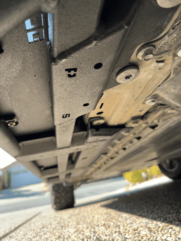

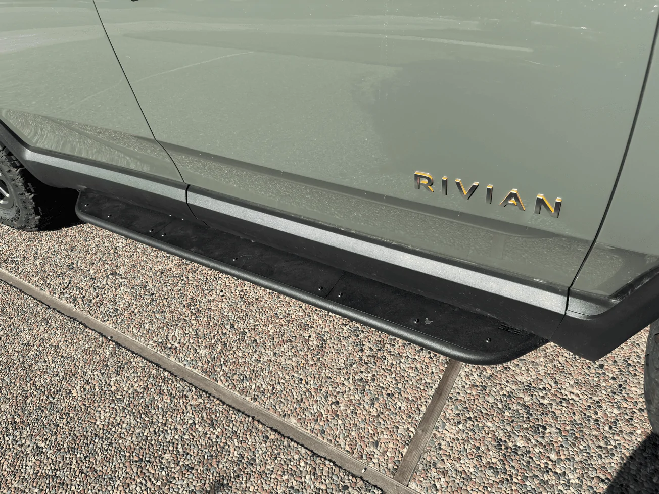

Another addition is the DCE Rock Sliders I am happy with them and others that frequent getting in the car also appreciate the side step and they provide some peace of mind on the trails. The one minor gripe I have with them is they cover the rear jack point and I know you can lift from the slider rail itself, but if you ever need to take the car into Rivian for some sort of Servicing they will not lift the car unless they are off. So I had to re install them again when I go it back from the SC. Not the end of the world, I am pretty quick getting them on and off now with the impact.
I also got the rack lights, which will be next project. I've picked up a SwitchPro 9100 so I need to figure out how I am going to route my wires.
