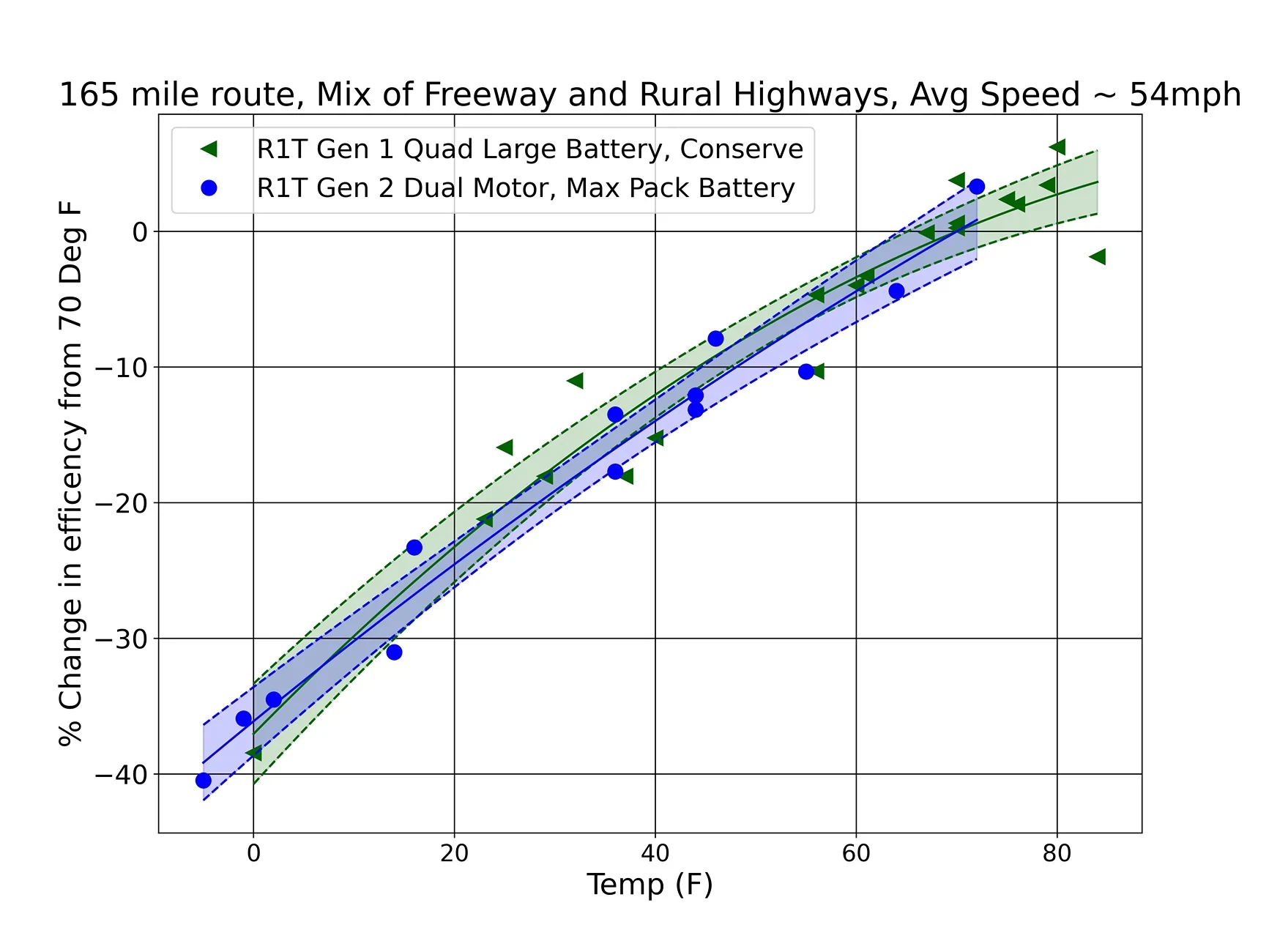

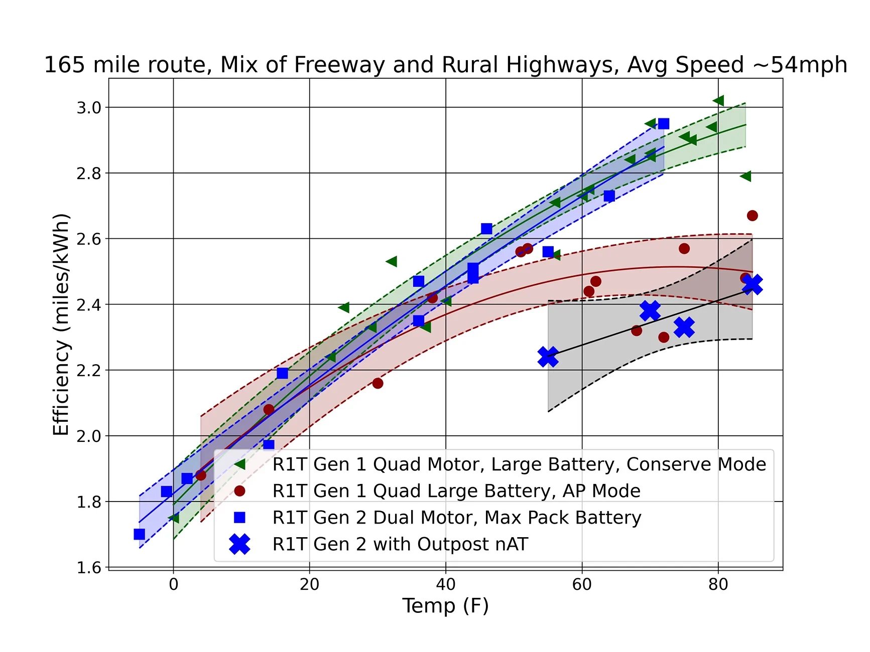

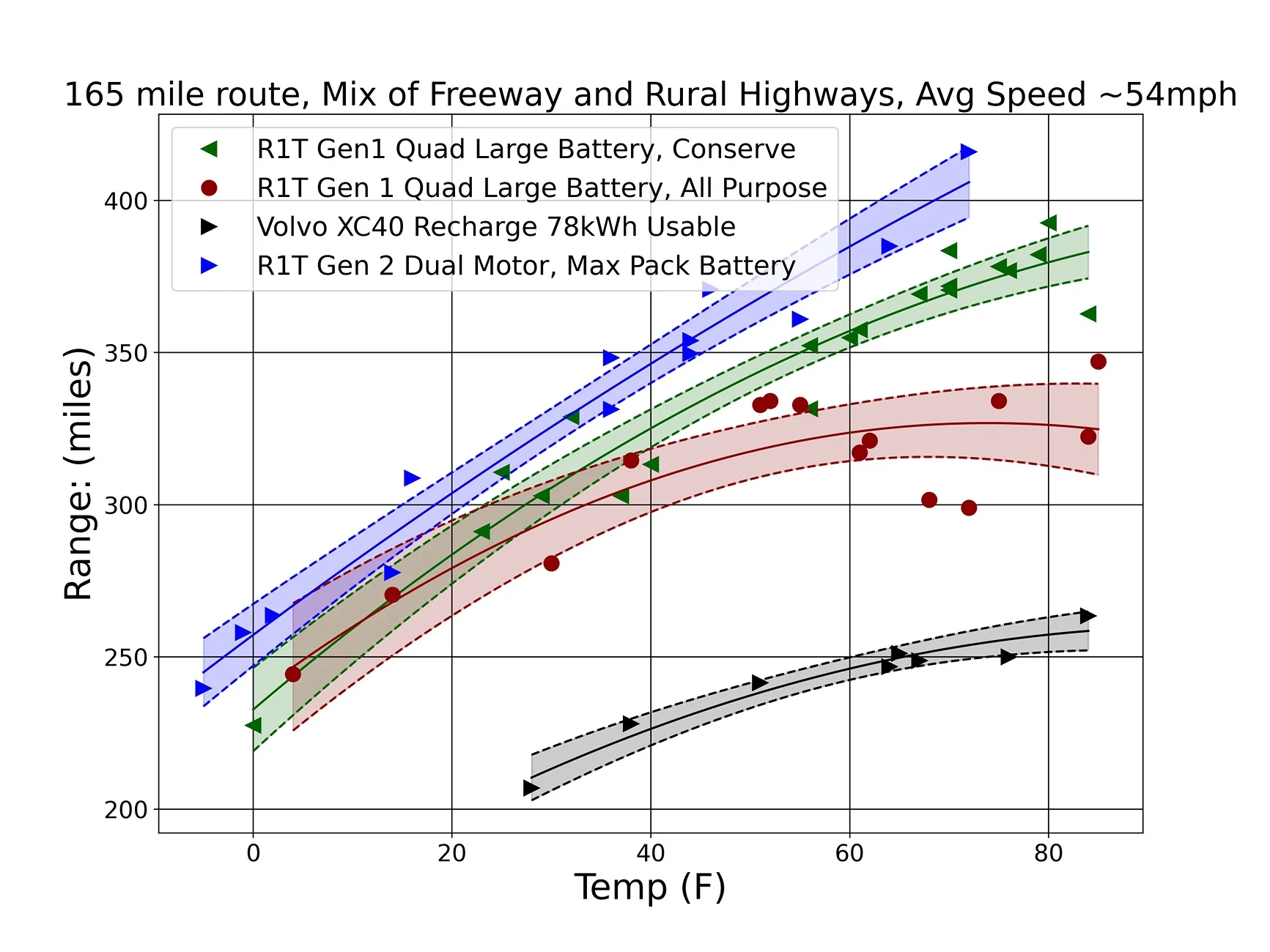

From my experience with 70k+ miles mostly in Michigan, the expected range for Winter (0-40 degF) with highway driving is ~200 miles on my Gen 1 Large pack. If you are trying to plan your charging for the range that you need, here's what I do:
1) Take the number of miles you expect to travel
2) Multiply that by 1.5 for worst possible case efficiency (meaning ~33% less from most ideal temp, from what I and @Budman have witnessed)
3) Charge to that amount of miles.

I'm 45 miles from Normal. Put 90,000 miles on two gen 1 quad Ts and now my second Tri gen 2 (total of 40,000 miles on them). My gen 2 trucks get better efficiency than my gen 1s by about 15 percent. I know if you don't precondition the efficiency really nosedives.

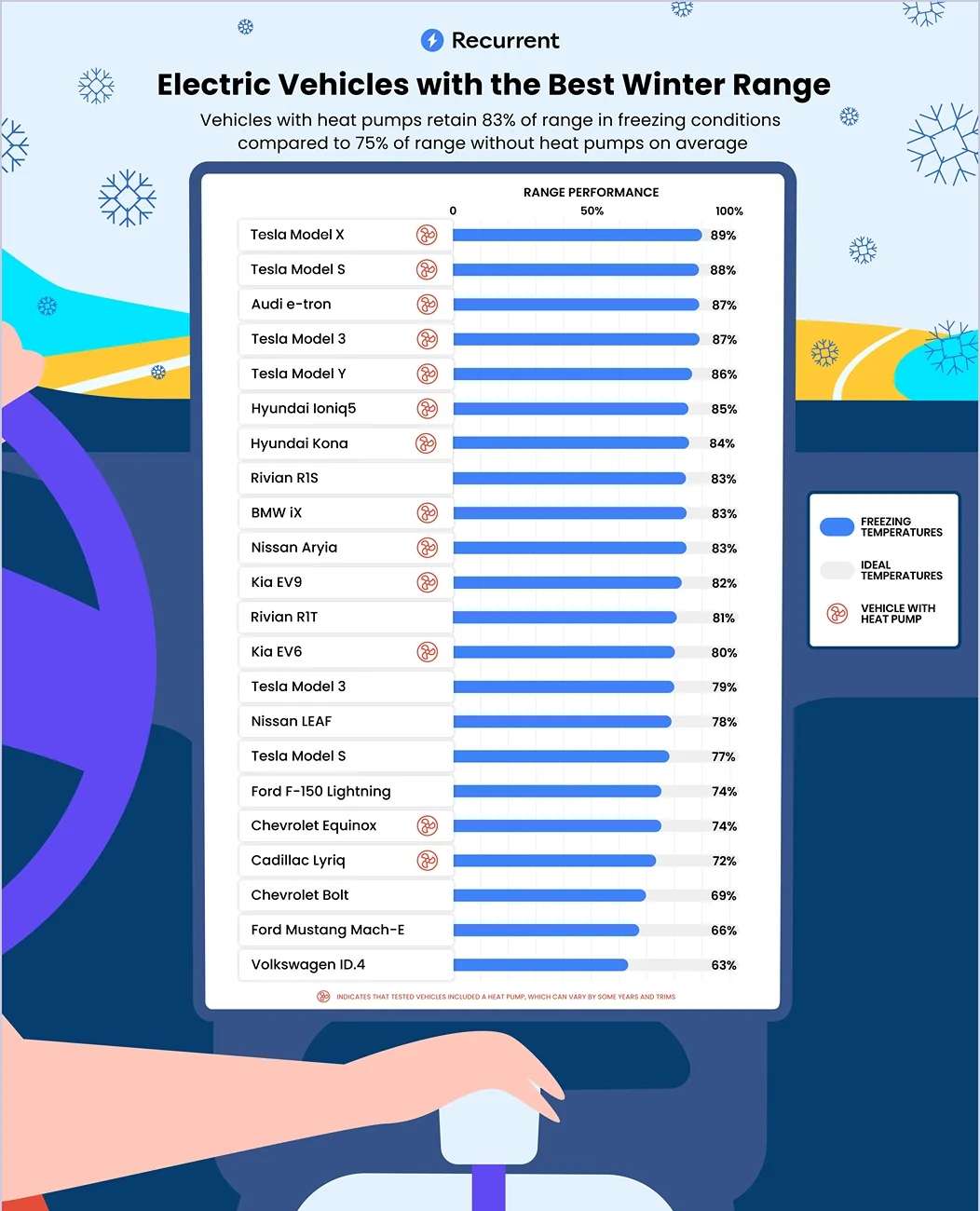

Happens to ICE vehicles too, but people tend not to notice because ICE cars aren’t sold by range, and until recently tended to not have visible range estimates. Same with towing range reduction.
If you’re somewhere it gets really cold, you’re probably familiar with block heaters, to help mitigate this. Same with EVs, leave it plugged in and configure it to precondition. That tells it to warm everything up using grid power by departure time to minimize cold-soak losses.
