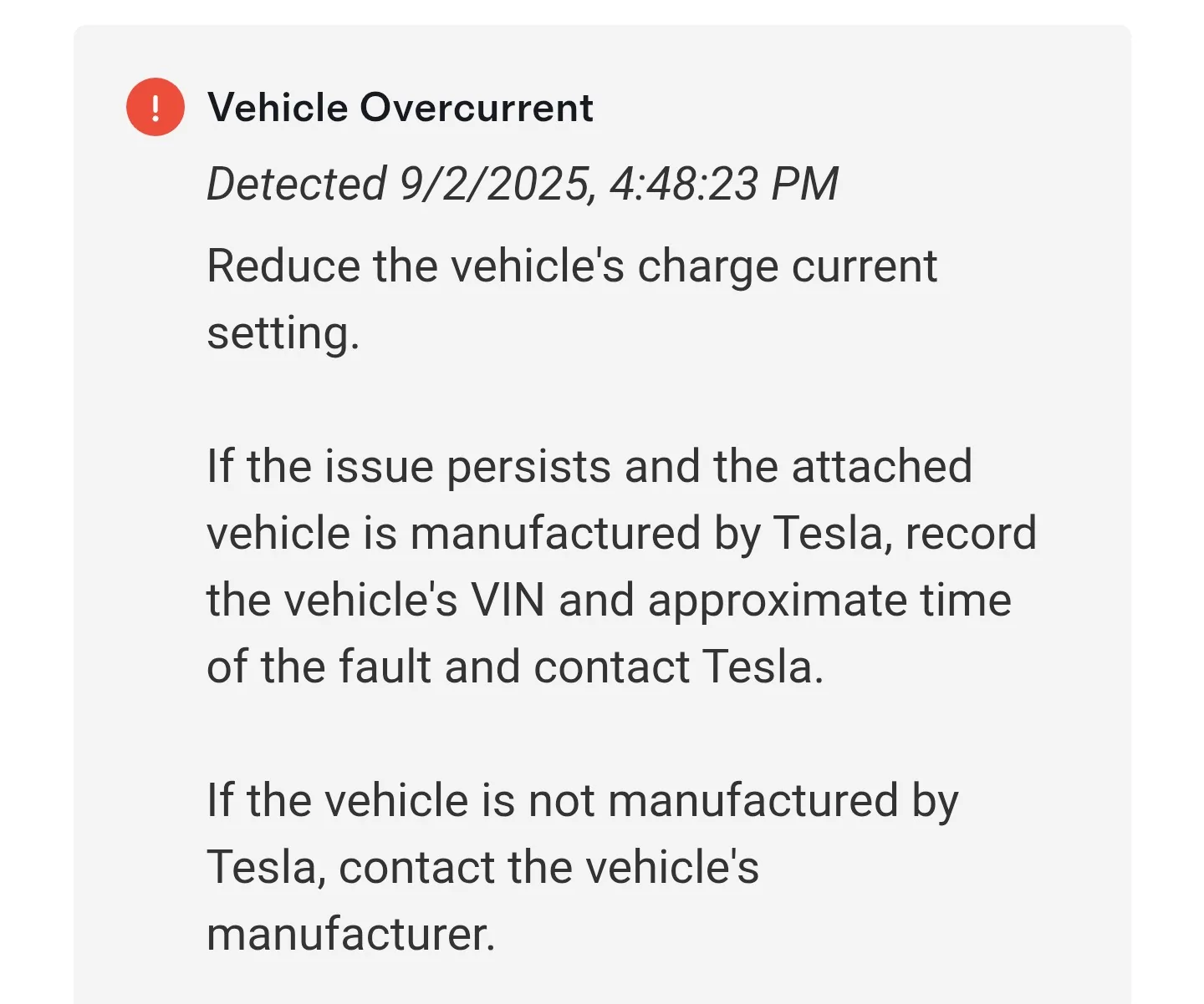

I'm having this same issue with my Gen2 R1S and a single Gen3 Wall Connector. 60 amp breaker. The wall connector is configured to limit at 48 amps. Both my wife's model Y and and my R1S correctly display the 48 amp limit while charging. The Tesla charges without fail. The R1S faults the wall connector after 30 minutes. Doesn't matter if it's hot or cold.
I just finished playing around with the Tesla One app (the locally hosted web interface has been phased out). The wall connector has the latest firmware. This appears to be a Rivian problem, not a Tesla one.

Does it help to reduce the charge current as stated?
