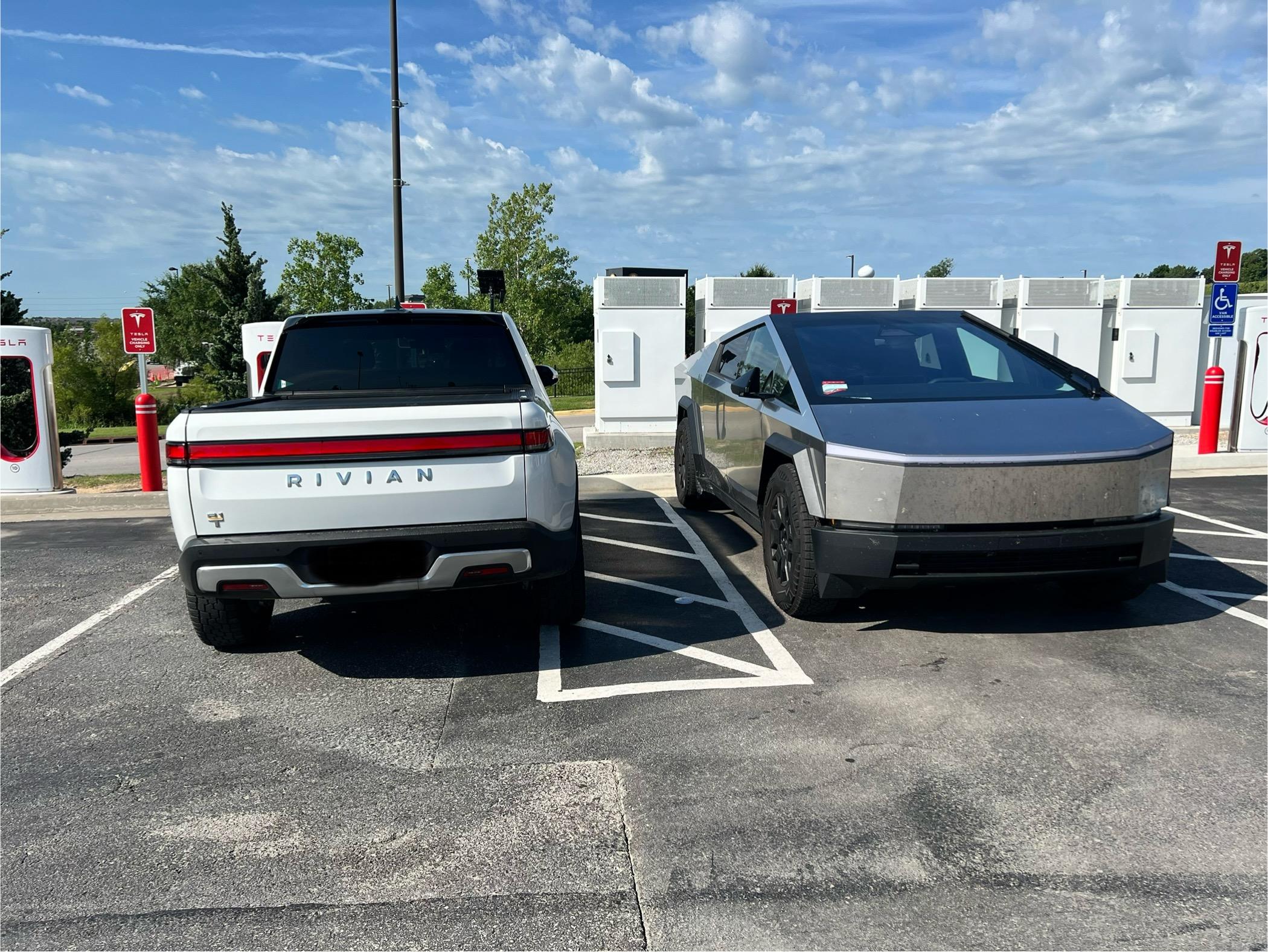

Received my A2Z adapter yesterday; got to try it out this morning - worked perfectly! Only negative thing was I wound up parking right next to a dumpster for my first supercharger experience.
