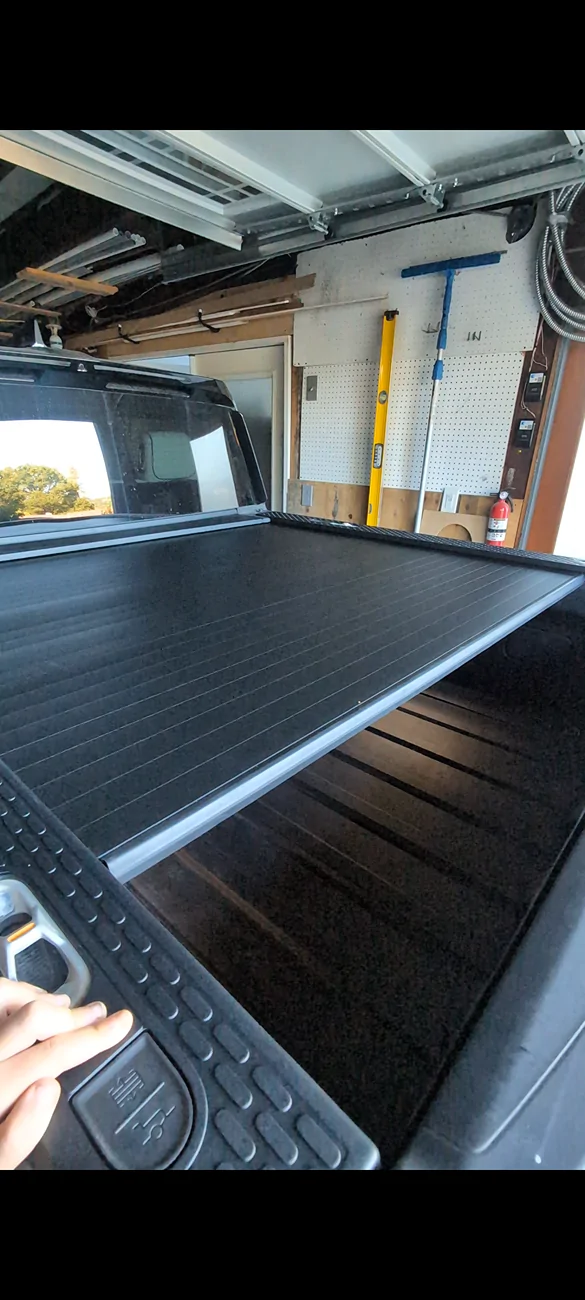

Don't know what your mean by sturdier. Feels reliable, it's very quiet and feels solid. The slats are surprisingly stiff, I was expecting something I'd be afraid to put too much weight on or bump but they aren't fragile (I wouldn't stand on them but they feel like they could probably support my weight, maybe....)
Thanks. By sturdy, I mean strong/solid and less likely to break. Looks like that so good.
Now, I’m less reassured by the second part of your response, the short supply piece… My appointment is less than two weeks away. Fingers crossed.

Ah yes so you can absolutely retrofit v1.5 or v2 to your car. I paid $2,400 parts & labor. So not too bad considering the manual cover on the gear shop is $1,800 and the powered one parts cost was $2,000. ( so $400 for the labor )
