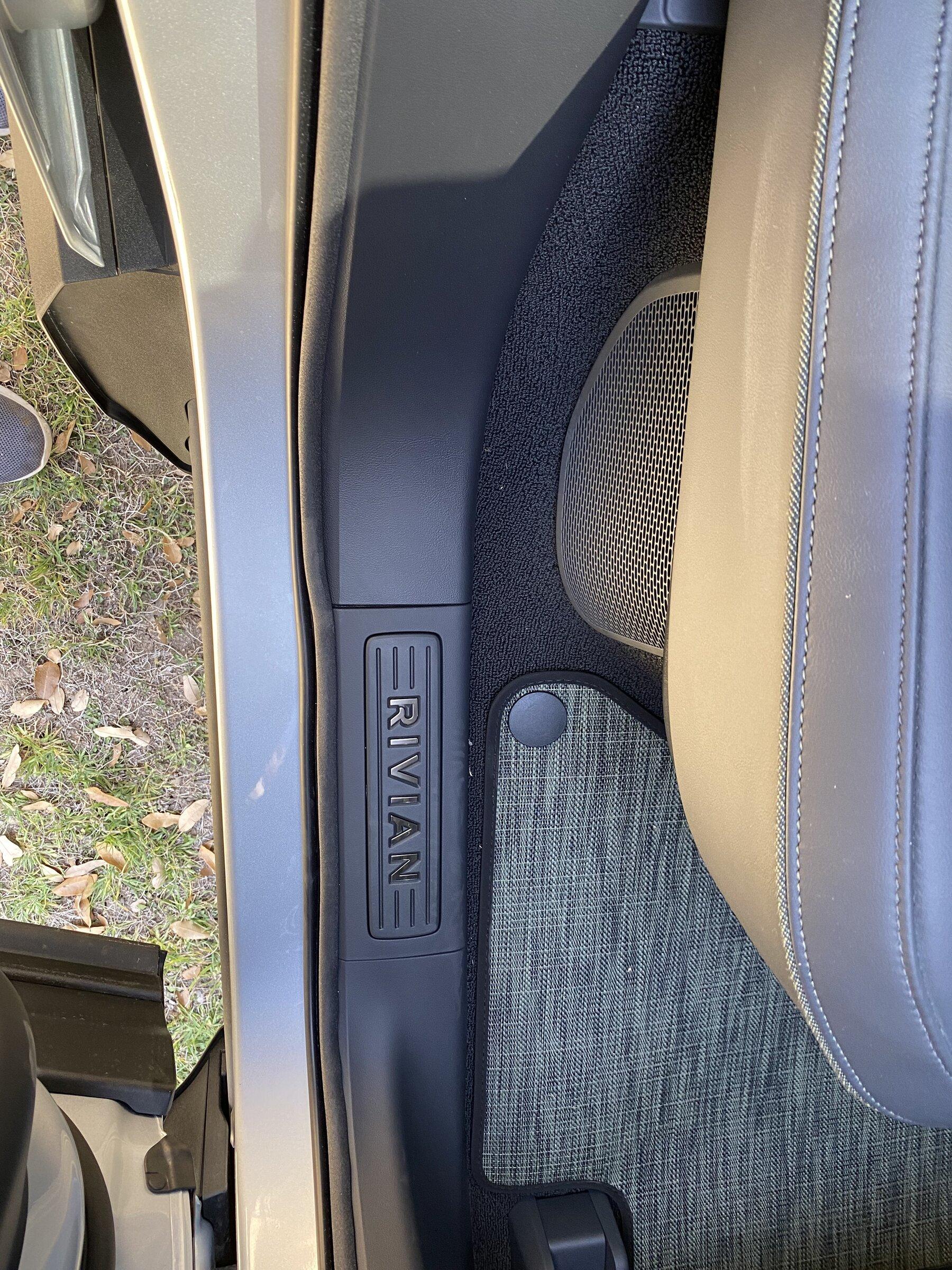

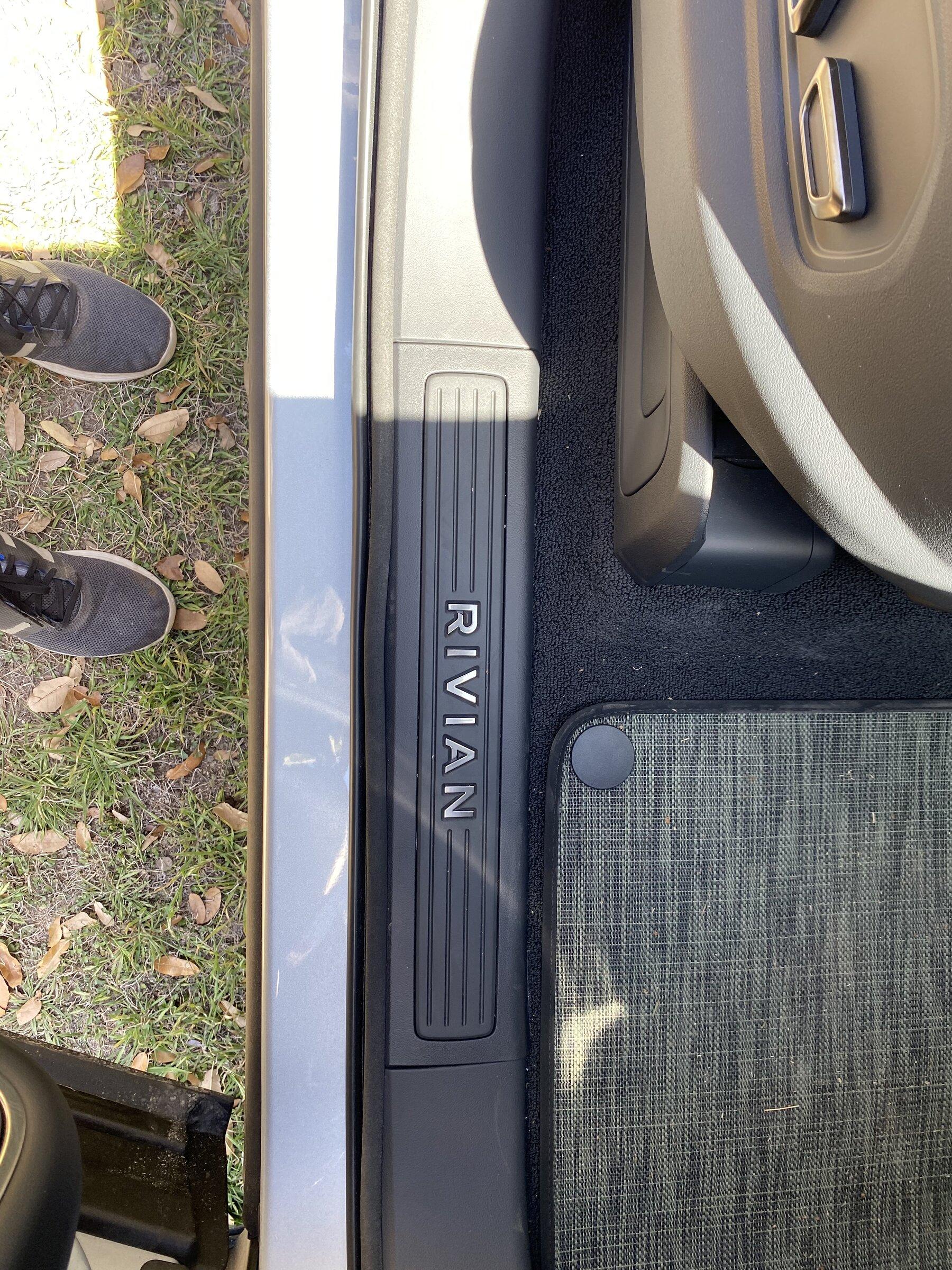

DaveA
Nov 17, 2020
2,546
4,685
The weatherstripping on the passenger side of mine was wavy, so when the weatherstripping inside the door itself hits the inside of frame it isn't sealing. Mine is at the service center for many things, but that was one I asked to be fixed, and according to the service agreement has been taken care of.
