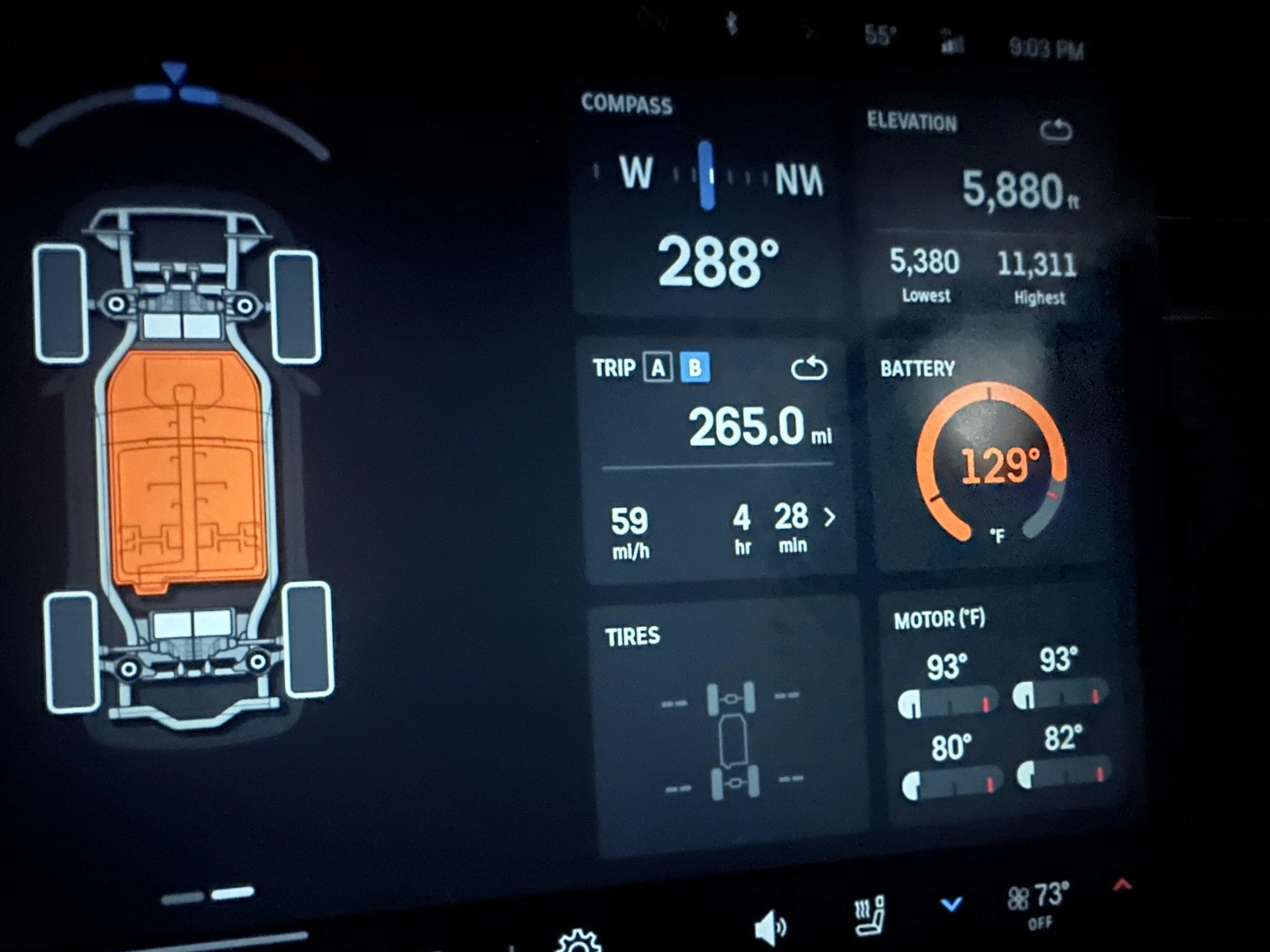

The Rivian fast charger stopped charging my car a little before 80% because the battery temperature was too hot at 130 degrees.
I had driven 4 & 1/2 hours non stop (other than construction delays) in Conserve mode 265 miles, arrived at the charger with 30 miles of range left (10%). This was on October 21, shortly after the software upgrade came available, so I have no basis for comparison on monitoring battery temp, but I’ve done this same drive over 20x without this issue, in much colder and much warmer ambient temperatures. There’s at least 30 minutes of downhill cruising before arriving at this RAN charger. Vehicle had probably been charging for 40 minutes to an hour at this point. I drove away and it’s temperature dropped quickly.
I take it you didn't get your Rivian home before Midnight and it turned into a pumpkin?
