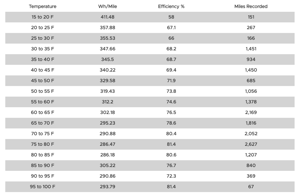

To echo @sub 's comments, here are my stats on my 2018 Model 3 AWD. I have the least efficient Model 3 AWD before the heat pump, so it will have toaster-heat (more accurately resistive heating) just like the Rivian. I run blizzaks as my winter tires which are quite sticky as far as winter tires go, and run wider than stock sticky summer tires which is certainly a factor in these low efficiency numbers.
Below is all drives over 10mi by temperature. Random anecdote ... sadly reminded me I haven't been skiing since my oldest arrived 3 years ago.
Rivian R1T R1S Official Cold Weather Driving Thread (Tips, Tricks, Tears) 1632885053182
My point is - I imagine the range hit projected is likely accurate to slightly aggressive (real life will be less of a hit) but better to prepare for the worst.
@yizzung you mentioned you have destination charging on both ends, so your likely worst case scenario will be a really quick charge mid-trip (he said assuming one is on the way) as you can roll in relatively low (as low as you feel comfortable) and be confident you'll be charged when you need you car next.
