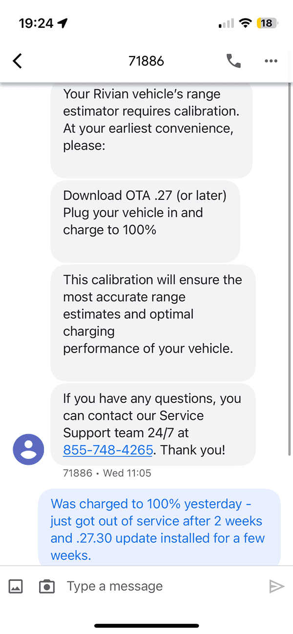

Not exactly for service life. It is about maintaining proper battery calibration. Basically to keep BMS happy, not the cells themselves. Most wrongly assume LFP packs can and should be charged to 100% all the time for battery health and it won’t degrade much if at all. This is not really true, unfortunately, and manufacturers are adding to the confusion by telling consumers to constantly charge to 100%. I know Rivian does because I’m getting constant notifications, texts and actual human calls to charge to 100%. The app will even change my max charge limit to 100% despite setting it lower. Annoying, but I get why
