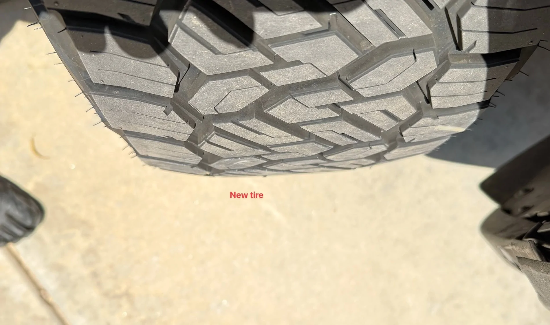

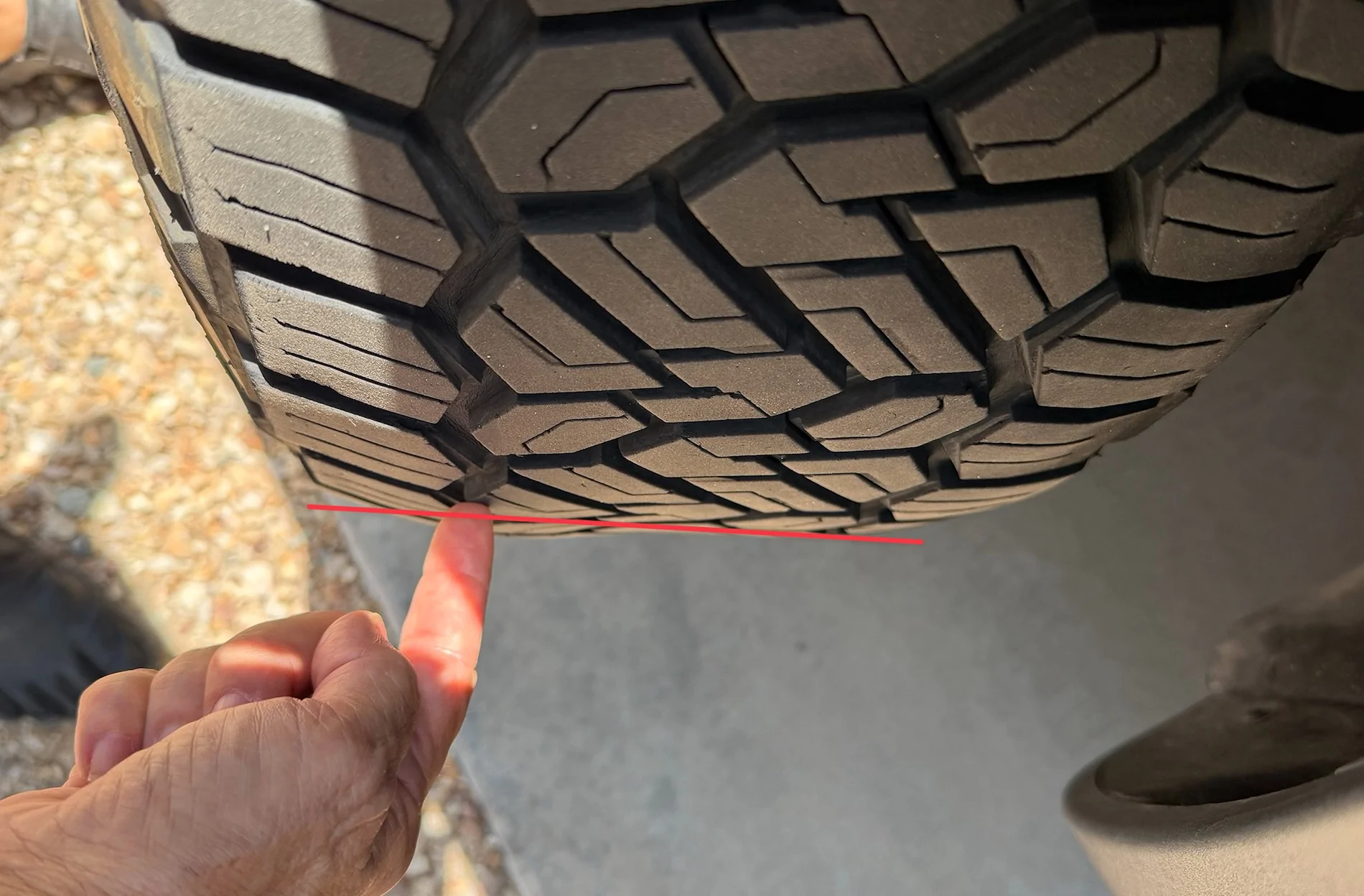

At this point I have PTSD and was in denial when I felt the first tiny hint of a wobble and pull. Then I went through the other stages of grief, fear, and loathing. Anger--WHY ME? Bargaining--maybe if I drive cool, it will fix itself. Maybe I'm just imagining it. I guess I accept it, but going back to anger for a DOT/tire warranty complaint/pissup/something. I think at this point I want to insist on a refund for the extended warranty replacements, and that the manufacturer pick up all costs. Is that unreasonable? I haven't done anything terrible to these tires. Some off-road, but mostly sand not rocks. Light towing, under 3500. Not that many launches.
There's also a super interesting thing about the Rivian suspension. A left tire with an inside separation pulls right. The angle of the suspension arms is such that the inside of the tire is on the right side of the pivot. Normally a separation pulls to the side of the separation. This led to much more confusion, since it wasn't the right tire that was separated in the last three cases. These have assymetrical sidewalls so there is an "in and out" and this implies they have a specific defect area. OTOH the first separation was right front outside tread, and also pulled right as expected.
