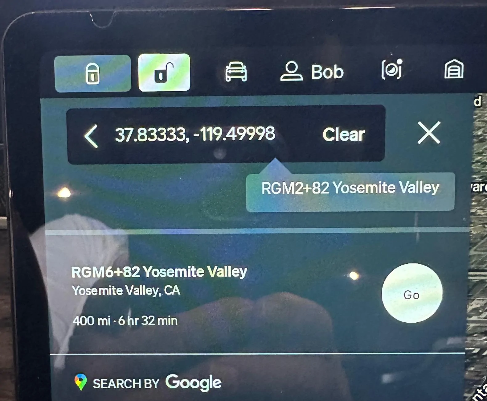

If you know the decimal representation you can just enter it in the search bar of the Rivian Navigation.
Here is an example:
Rivian R1T R1S Navigate to GPS coordinate? IMG_0861
Here is an example:
What I find strange is that Rivian shows the Plus Code for the lat/long, but it doesn't let you enter a Plus Code when searching for a destination.

Thanks Bob. I was using Degrees Decimal Minutes because that's how the race and my two Garmins are now formatted. I converted everything to Decimal Degrees and it works perfectly. Crazy to think how easy life could be with uniform standards :rolleyes:. I appreciate the help.
