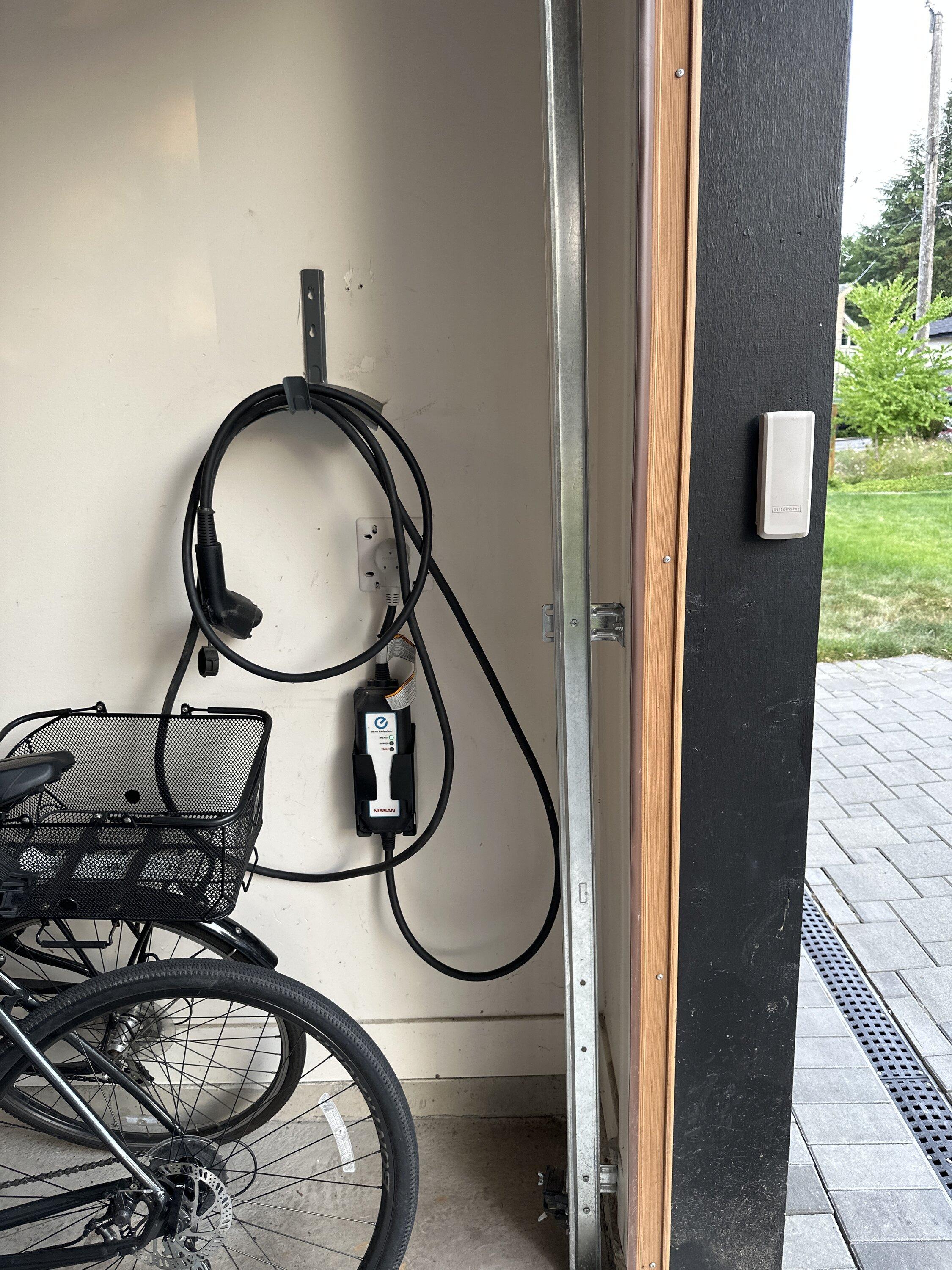

I have my plug near door, cord is 20 feet long, goes under door during charging at night, been fine for 5 years now

I just have been using the portable charging unit that came with my Nissan leaf, it works fine, but will definitely take much longer to charge the Rivian when I get it, thinking of buying a proper charger that will charge faster, 240Vplug said it’s not recommended to run cable under garage door, but I don’t know why? Doesn’t seem like much pressure on cable when garage door comes down and garage door has rubber seal that acts as cushion. Has anyone had problem tuning cable under door?

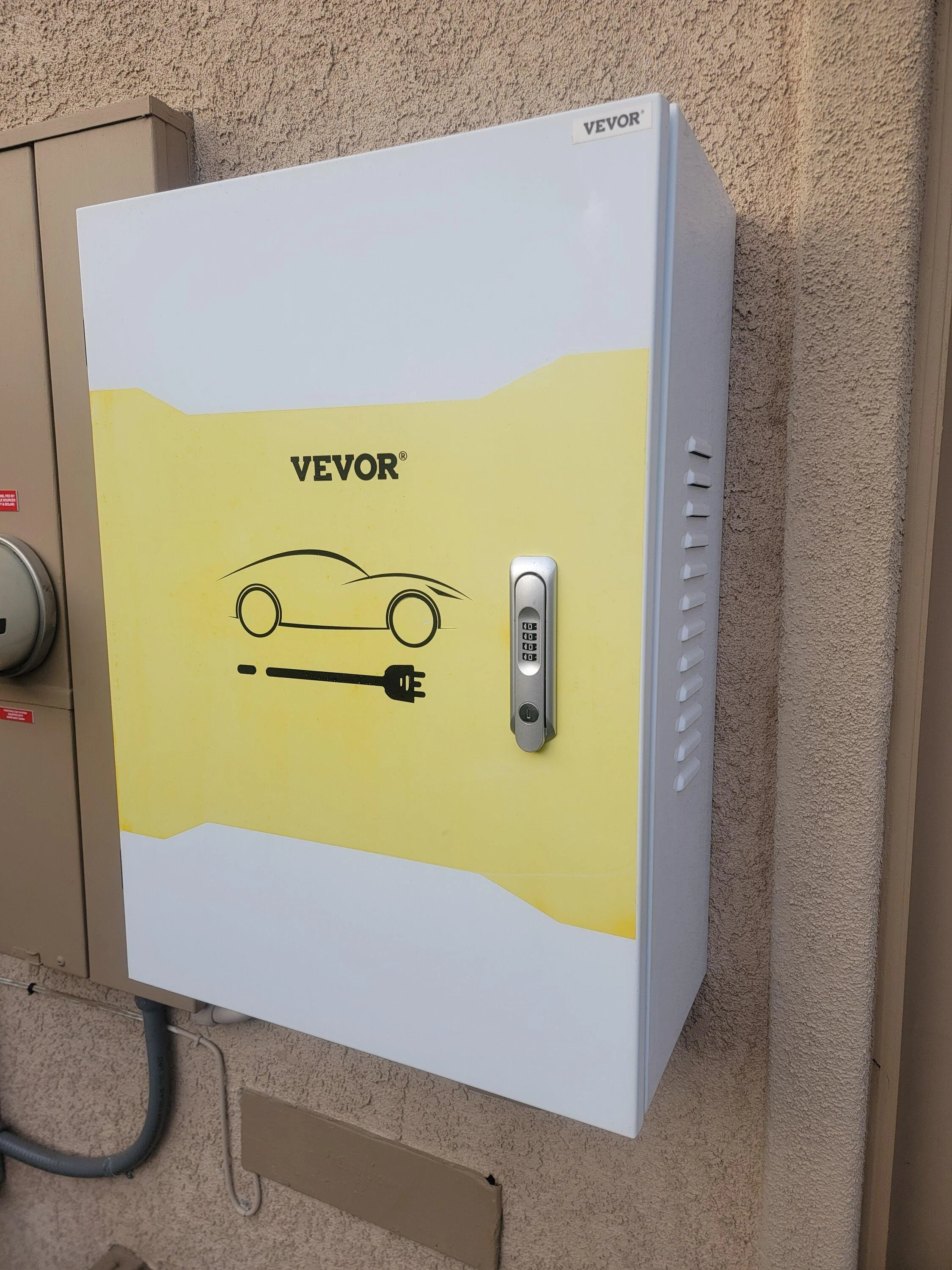

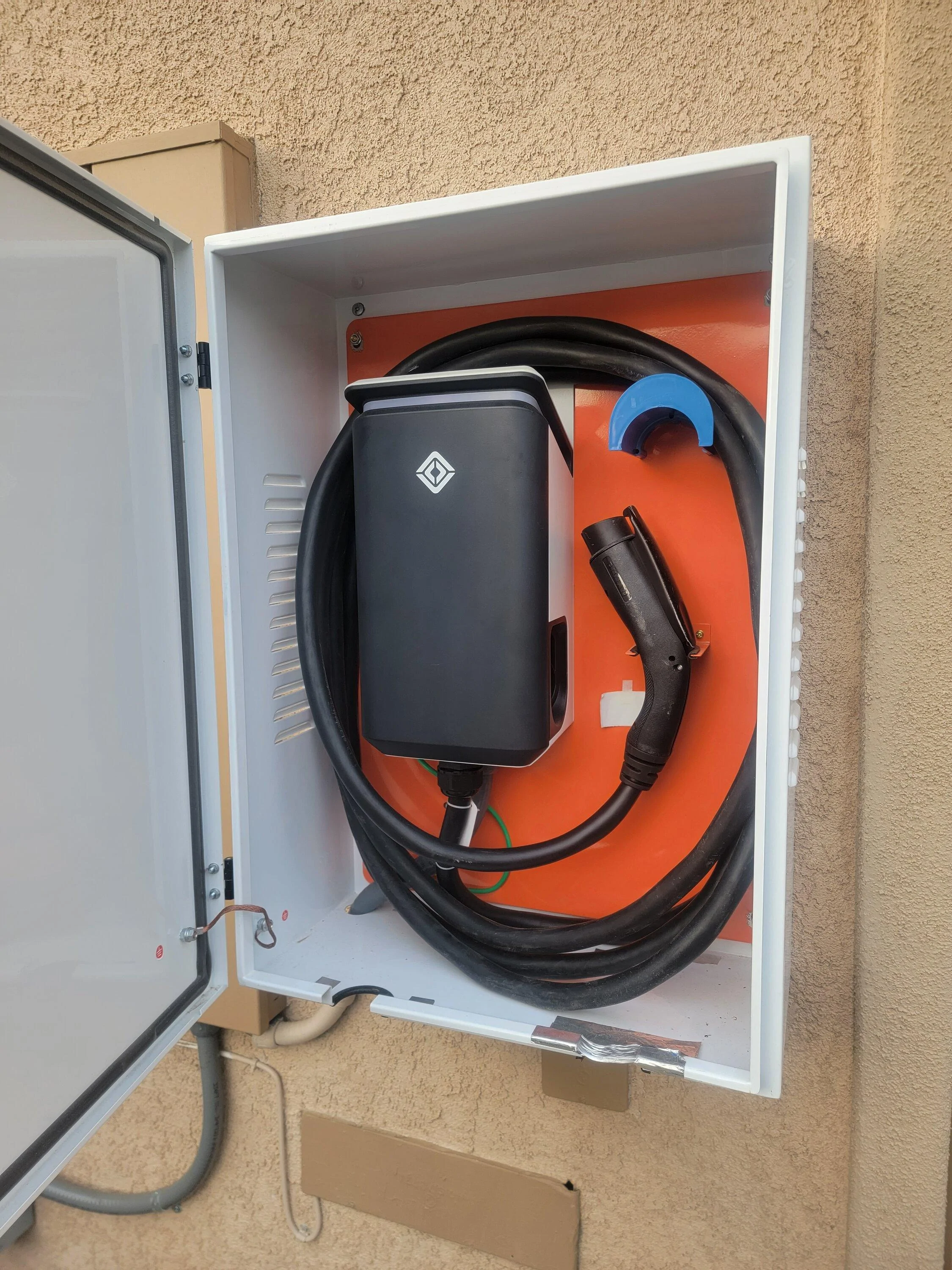

This works well for me. Before this box was a cord under the roll up garage door, R1T parked in front like others have posted. No problems with that either. This is more pro looking. Self installed.

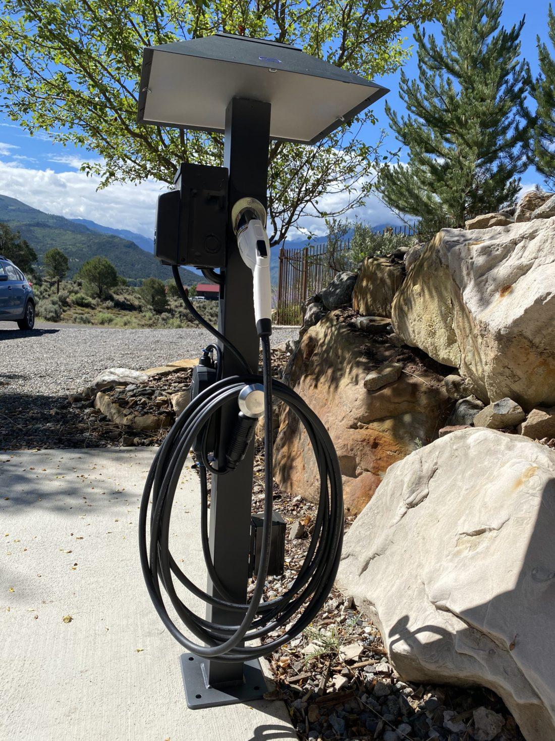

I am switching over to a Rivian charger now. Installed on my front circular driveway. Should have the Rivian charger in by next week. I was not happy with any other options so designed this mount. It has a roof to help keep weather off, the roof has built in lighting that is charged by solar cells and added the stainless steel rods to hang the cable on, which I like better than using the body of the charger.

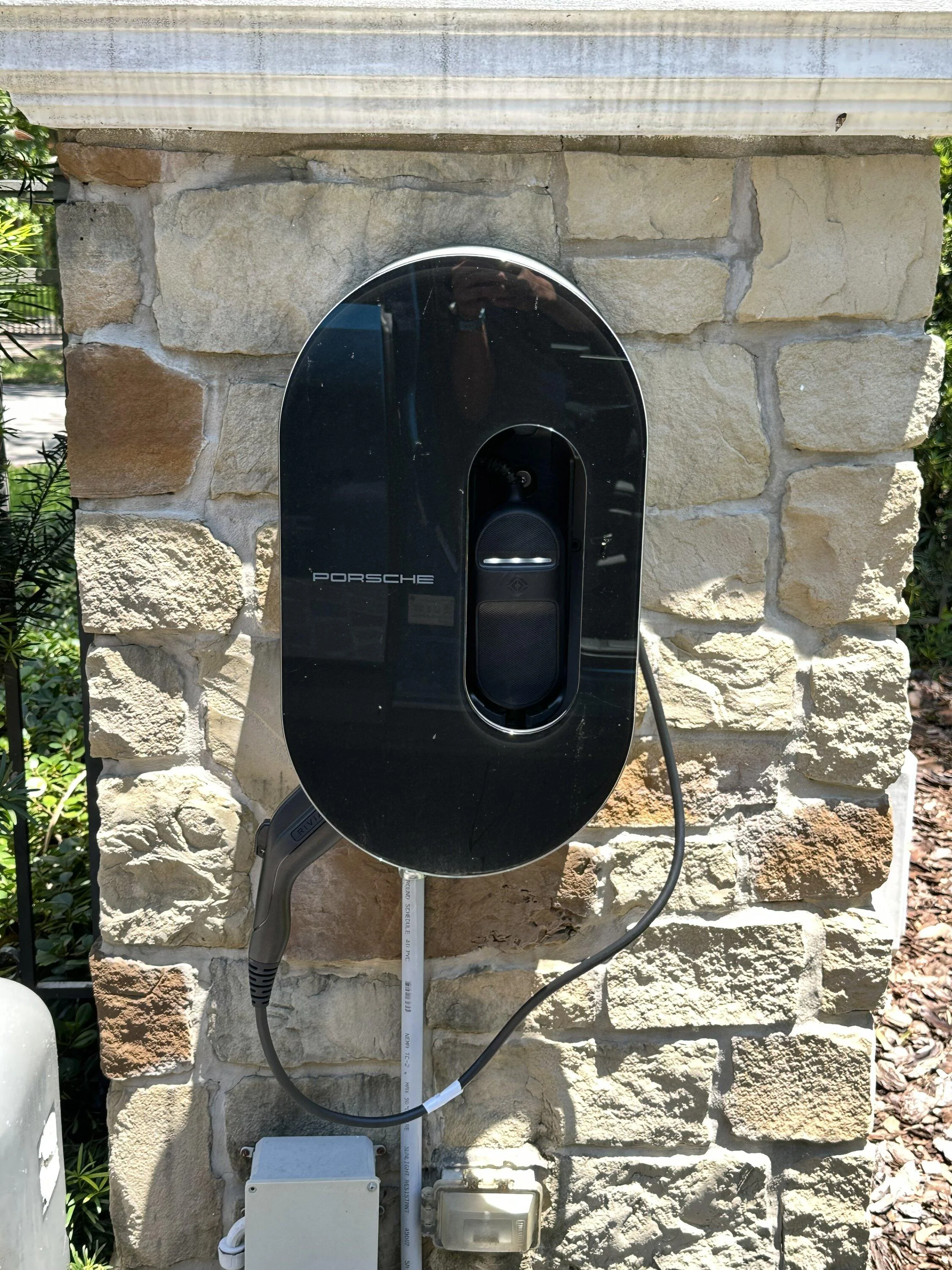

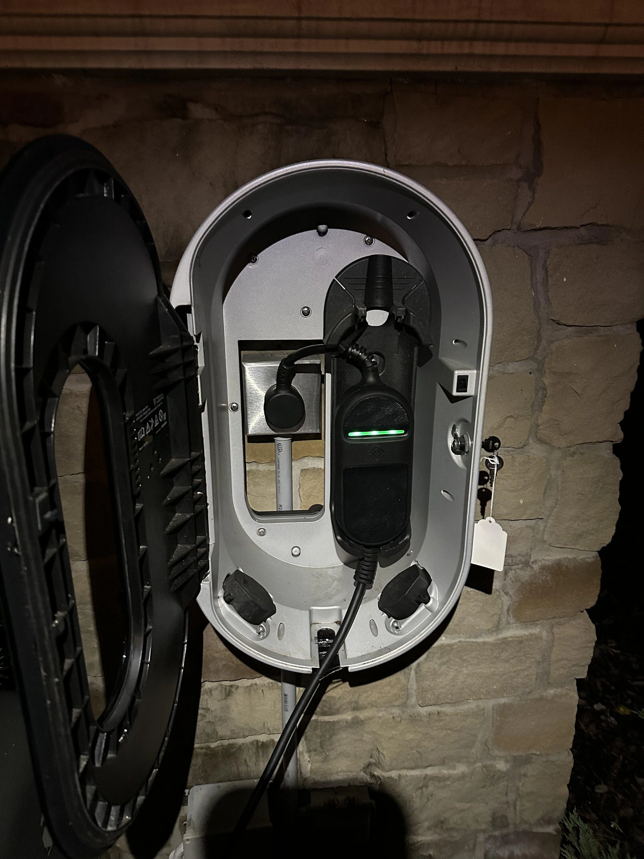

I repurposed my old Taycan wall charger housing to use the Rivians charger while I wait for the wall charger. Will post a pic after I install the Rivian wall charger today
