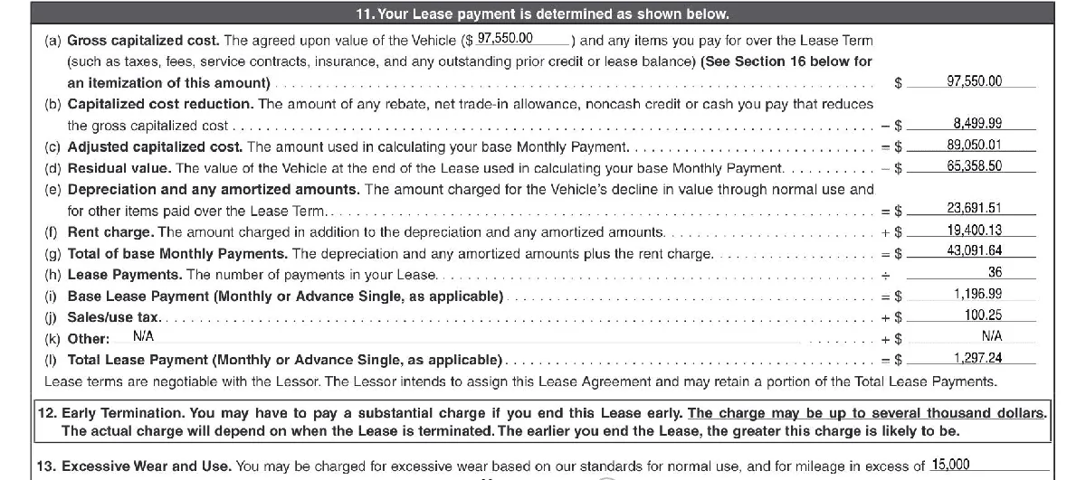

67% residual for 3 year lease with 15,000 miles.
Br careful getting a lease just to pay it off quickly. You will pay sales tax (if your state has it) twice if you buy the lease out. When you take the lease out it is included and then when buy out residual it is paid again. You eat up $7500 savings fast paying the fee and sales tax a second time. Plus the interest equivalent portion of the lease payments you make. Leases only really make sense if you get a purchase price advantage to do it or are using it as a business expense.
100% true. Everyone needs to do their research based on their state.

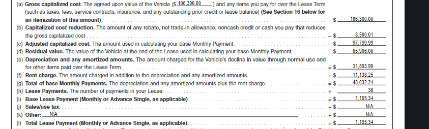

Alright, back with some details, and it seems like due to the rent charges it may be a bit cheaper to buy it outright. I just took the base monthly payments plus the residual value, which is roughly 2k above line a
any other ideas here?
https://www.caranddriver.com/auto-loans/a44002991/lease-buyout-taxes/
From what I saw on my lease in state of GA - the sales tax charged is prorata based on the depreciated amount over the lease term. It is not the full amount based on the net sales price of the vehicle. So does not appear that you pay sales tax twice - at least in terms of the full amount twice - yes you will pay sales tax on the residual value of the vehicle - just as if you bought a vehicle for that price. That is of course specific to GA - your state certainly may vary.

so when you say it may be cheaper to buy outright you mean you pay $106,300 outright vs if you kept 36 months and bought at residual for total of $8,501 + $1,915 * 36 + $65,906 = $117,426 is that right math? (though the lease has a $7,500 credit built in which I assume is included in the $8500 down/cap cost reduction?)
