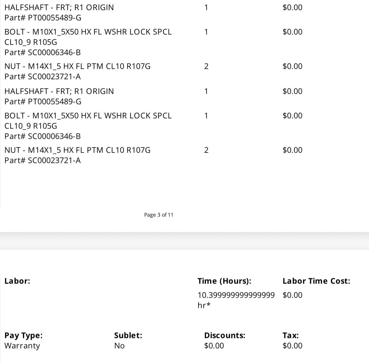

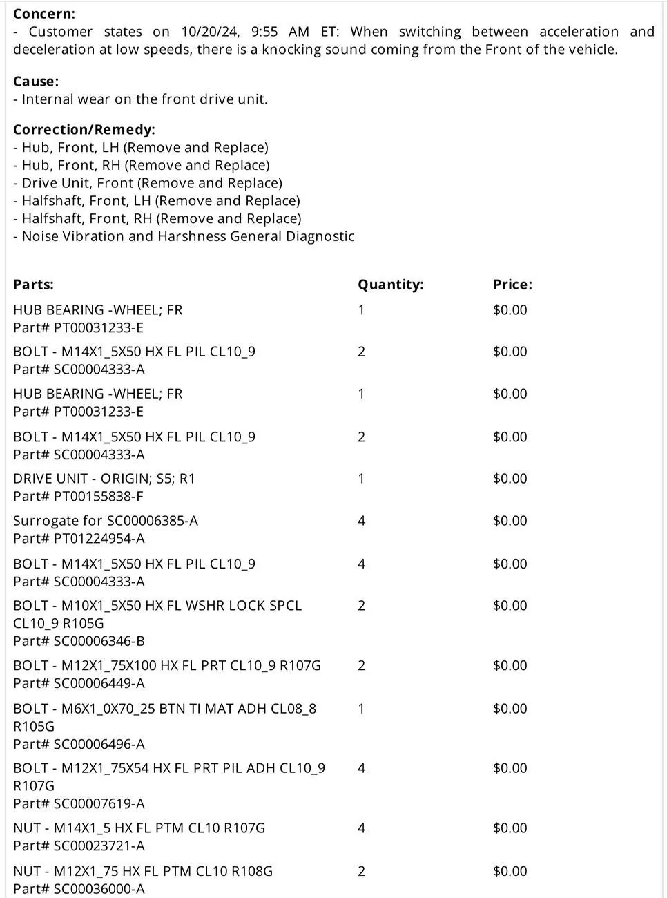

Just a quick update on this issue - finally I had time to let my truck to SC. As you see, I first noticed the problem in Oct 24. The problem was resolved by replacing the Front Drive unit (gear lash), Halfshafts, and Hubs.
The truck is great now. I never did any off-road or launching; I was easy on acceleration.
SC was amazing, but I ask myself - how all of this happens to the 29k , 2 years old truck in the first place?
I also think that many trucks developed the same issue, but they are drivable, and most of people do not pay attention to the knocking. Maybe I am wrong
