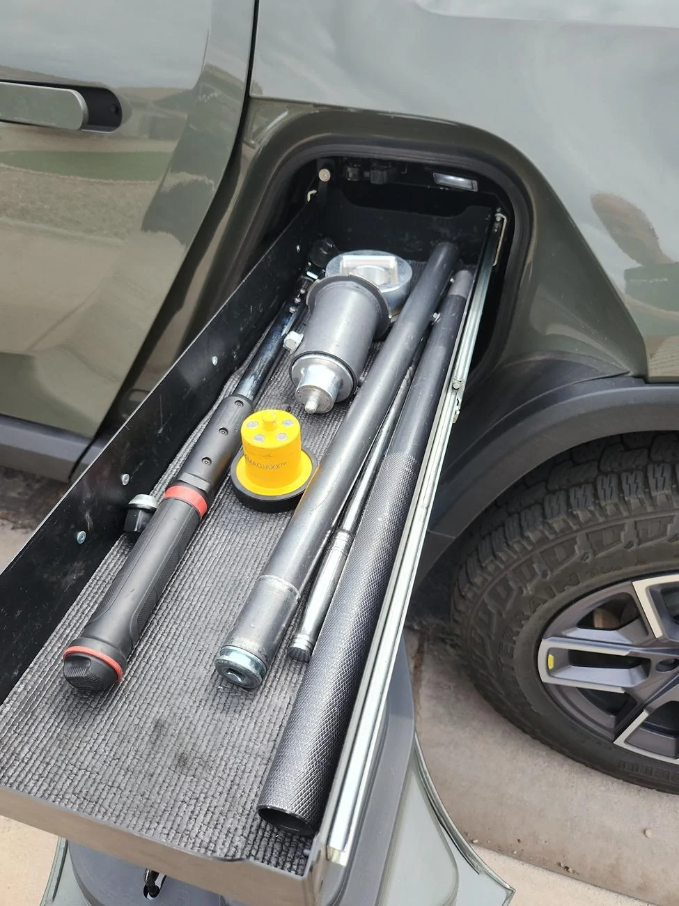

Picture below is from Rivian Field Service, who did a pre-emptive 12V battery and knuckle tightening on my wifes R1S. Look what I spotted in the slide out trey! ;) Even Rivian knows.
(this sentence added for clarity) I was telling the service tech about jack pucks and he laughed and said, "come take a look! Far easier to use than ours."

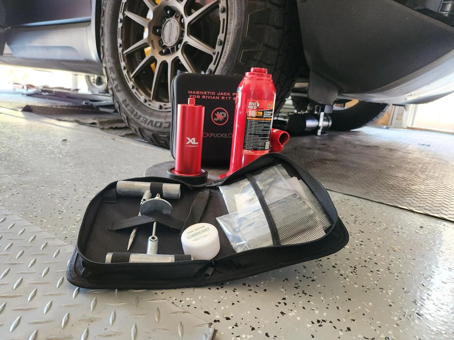

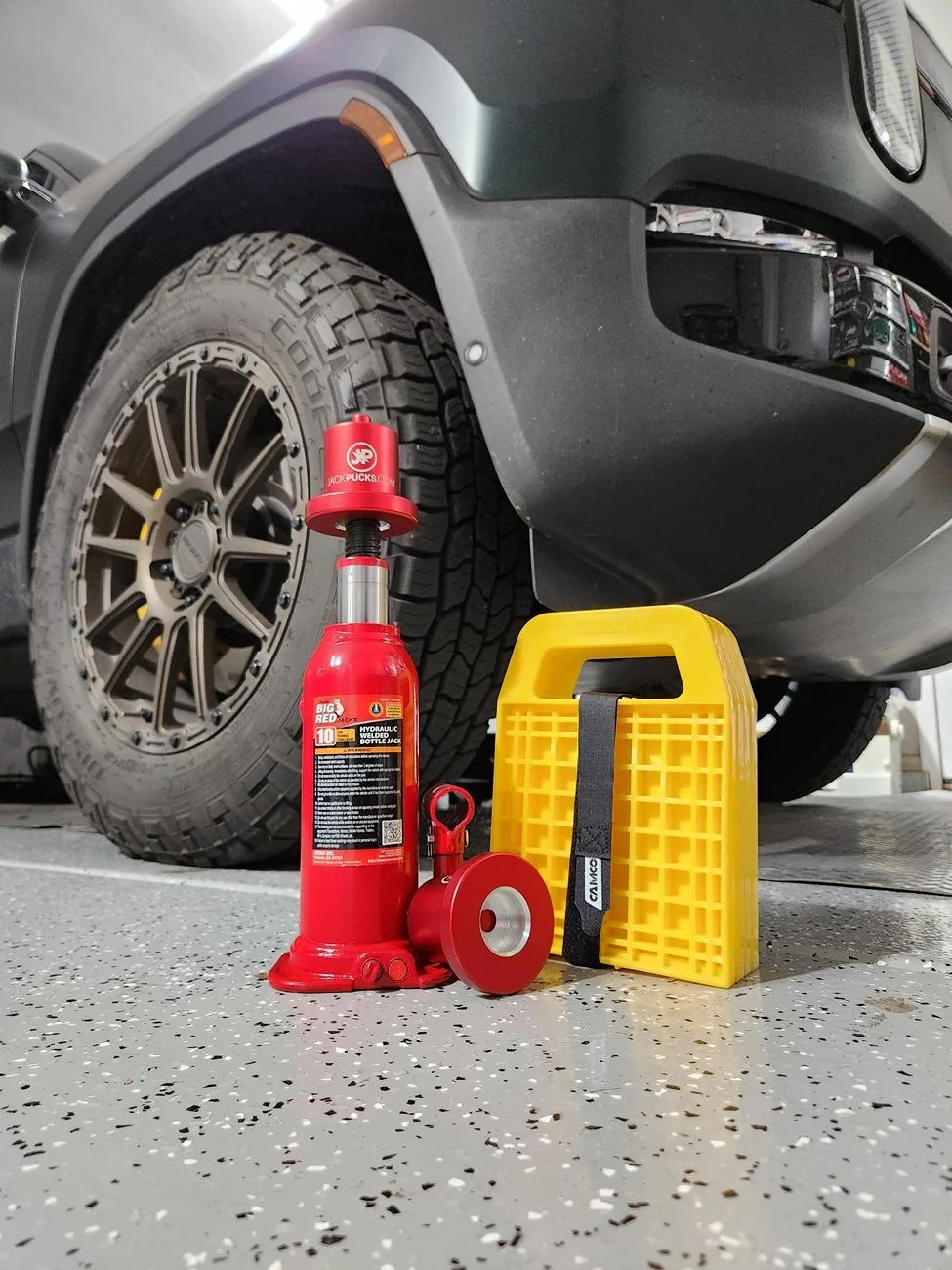

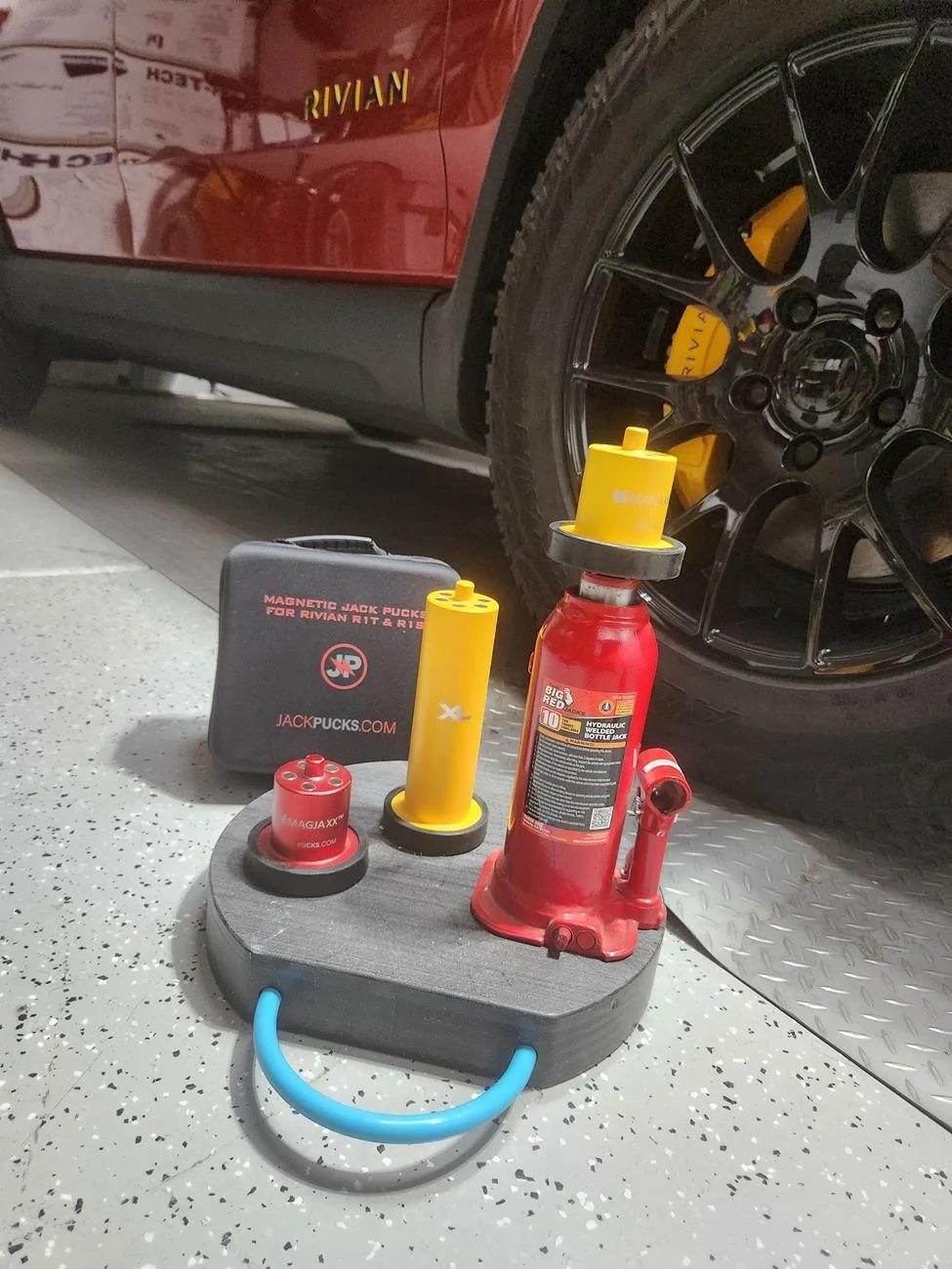

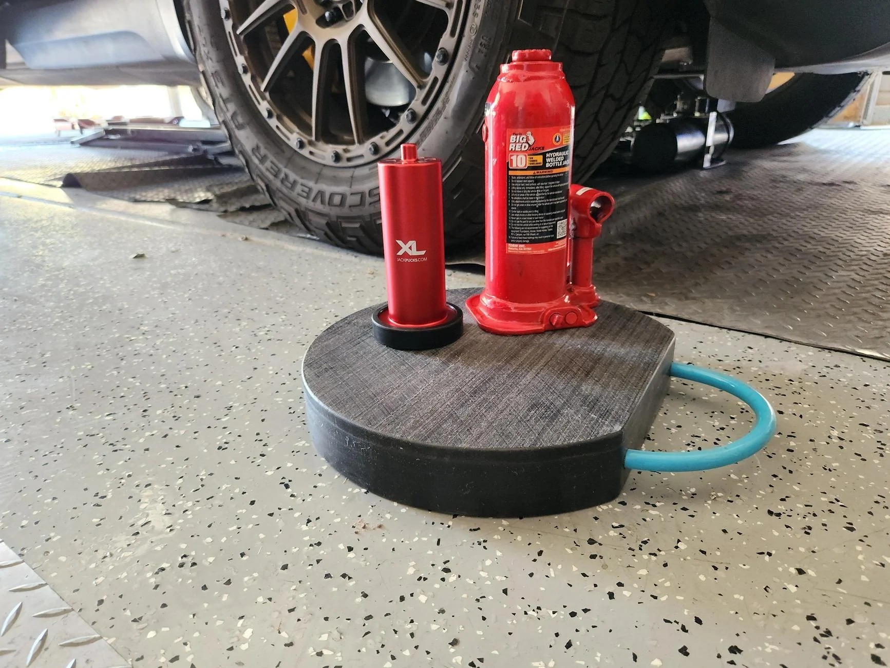

We both carry a tire plug kit, and I carry the larger RV jack pad below. My wife's R1S has the smaller yellow RV jack pad (pictured), but it can deform slightly under load. Works in a pinch, but it isn't pretty.
Road Warrior RV Jack Pad 2" Thick
Camco Jack Pad (deforms a bit under load)
Tire Plug Kit (sure there are better ones, but it has worked twice)
