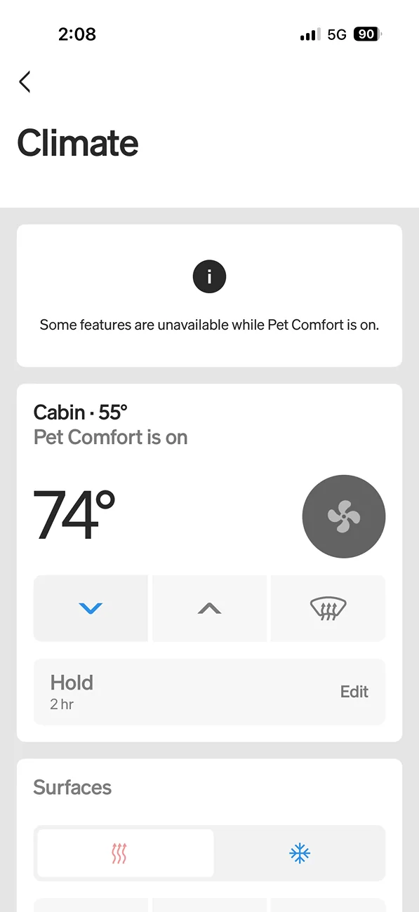

With temps in the teens here in NY, we lean heavily on Pet Mode to keep our little buddy warm while we are out and about. Lately we have noticed that the temperature drops slowly after we initiate Pet Mode. Nothing life threatening, but an inconvenience and concern. I don’t know how low it will go if left for a long period of time.

I noticed a decent discrepancy in Cabin temp and set point temp as well in the Southern California mountains this week.
In the past I recall the Cabin temp and set point temp have been within 1-2° pretty quickly after setting.

Not on pet mode but just regular heating, noticing significant discrepancies between set point and actual temp here in MI. System seems to heat then switch to cooling mode. Been fine up until this upgrade.

I noticed difficulty in preconditioning earlier today with cabin temps not rising past 54 in 25 minutes of operation. There is significant ice accumulation below the windshield wipers resting position that is partially obstructing the vents there. I wonder if this could be contributing?

Have any of you tried a hard reset?
Yes. I have. The problem seems to be intermittent. The heat worked fine going out last night. Failed to work properly during the time we were in a restaurant, then slowly seemed to get better on the ride home. Failed again this morning during preconditioning.
