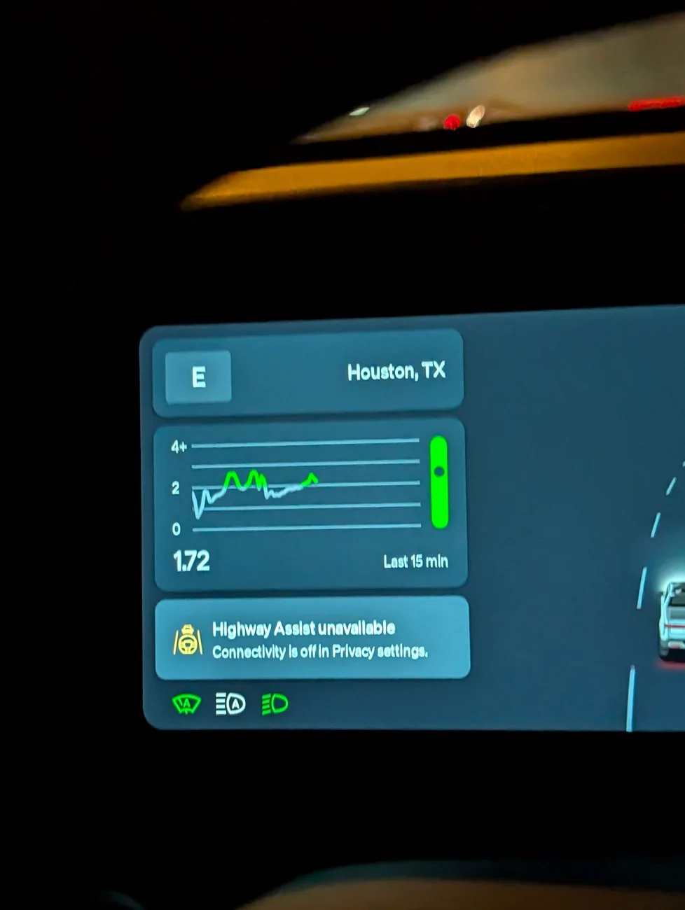

I'm Gen1, so no UHF, but no Highway Assist or auto cancelling signal after lane change. Haven't rebooted yet.
Did a reboot and have new error:
Rivian R1T R1S Is UHF Feature Down? 1000009864

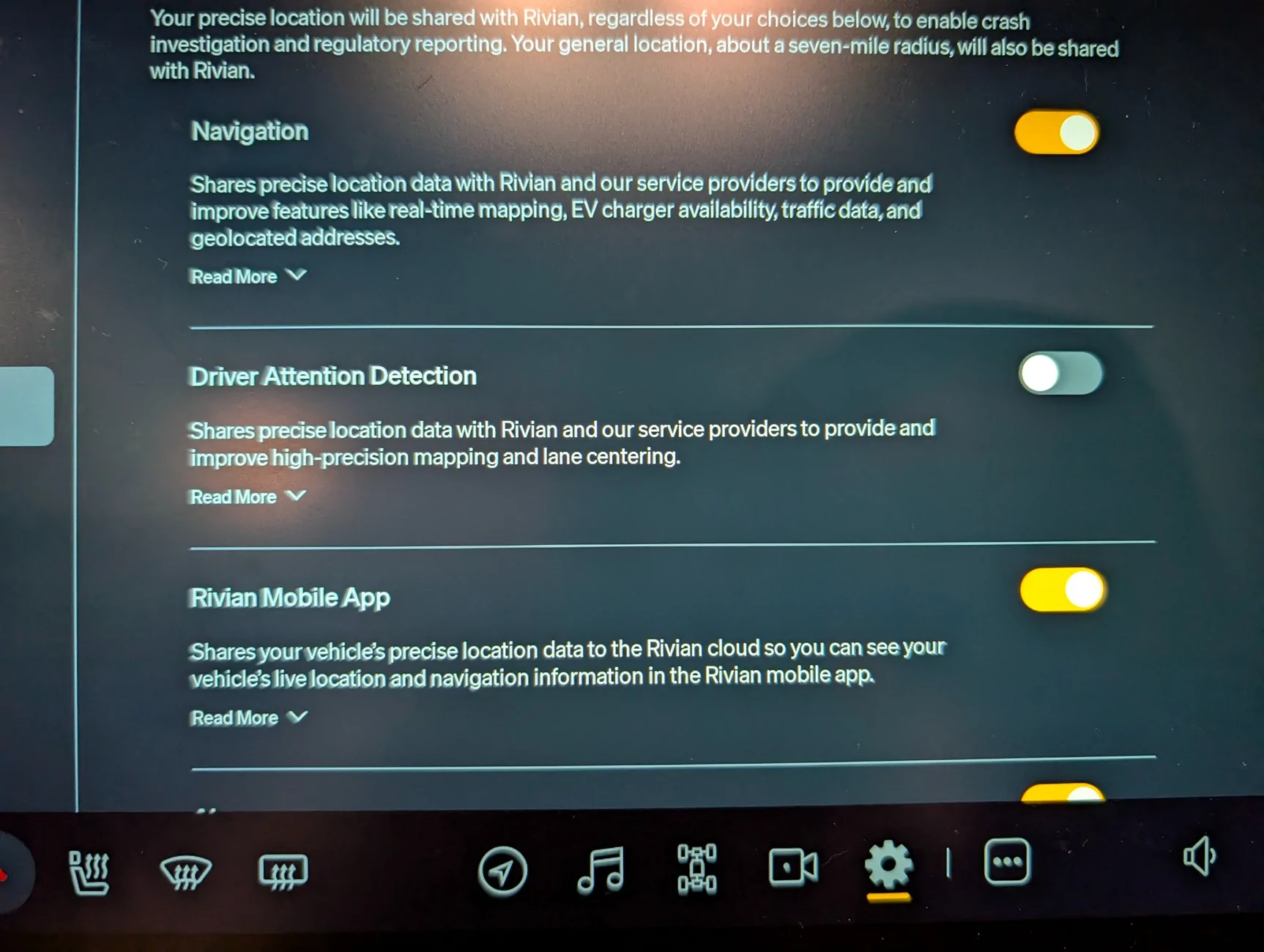

Then I went and found this:
Rivian R1T R1S Is UHF Feature Down? 1000009865
Pretty sure that's titled incorrectly, since that driver camera is disabled or flat not present in Gen1 vehicles. Plus why would sharing location make one bit of difference? Don't know if that fixed it because you have to be in park to enable it, and I'm parked at home for the night.
