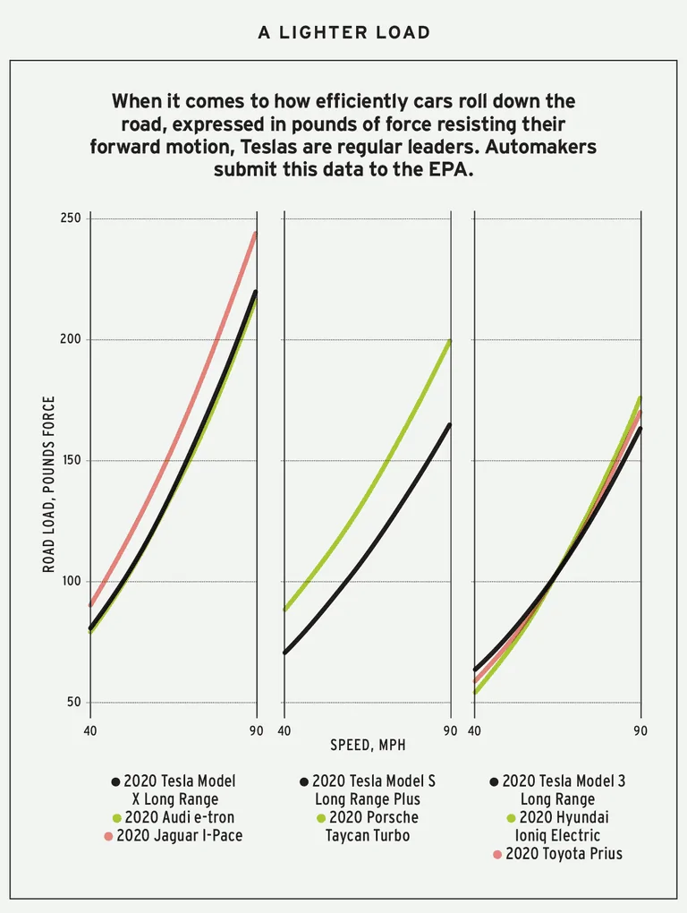

While manufacturers can't really sandbag the tests themselves, they do provide the numbers (aerodynamic drag, tire rolling resistance, and driveline friction) that set the road load on the dyno. Teslas numbers reflect a much lower road load than the Taycan. Tesla seems to be more aggressive in their road load and Porsche much more conservative (Teslas will indeed have lower road load, but probably less than the dyno settings reflect)
Rivian R1T R1S If the official EPA range is.... 1624132329323
Road load is measured through coastdown tests, wherein vehicles coast—hence the name—in neutral from about 80 mph all the way down to 10 mph. The resulting data of how quickly the vehicle slows is used to calculate the three coefficients for a quadratic equation that expresses the pounds of force resisting a vehicle's forward motion at a given speed. Those coefficients define the dyno's resistance during efficiency and range testing.
There are, of course, a number of guidelines in the SAE's 39-page J1263 document around this procedure, including requirements for tire tread depth and vehicle break-in mileage to ensure that the test vehicles are representative of what people actually drive. But automakers can and do try to piece together the best-performing vehicle—one with the slickest bearings and least drag from the brake pads—and run it on the smoothest surface they can find.
https://www.caranddriver.com/featur...-factor-tesla-uses-for-big-epa-range-numbers/

Read the article linked in the last post. Although the authors would clearly like to say that Tesla is "gaming" the system the information they present makes it clear that Tesla is not doing that. They are simply following SAE and EPA direction.
Sorry - maybe it comes off bad but they are. They are doing everything within the rules to make their mileage appear higher instead of more accurate. Thus I choose gaming. As someone with 2 Tesla's I'm ok saying it. Especially given it's one of many ways to report your EPA figures. I think Mach-E/Taycan are better examples for hwy speeds. Definitely reason for 2 figures in EV the same as fossil fueled cars.
The article says in so many words that the Tesla numbers are the best in the industry and indeed I find them very reliable predictors of on road performance. If Tesla wanted to produce a lower number to be more consistent with what you think they should be reporting they would have to deviate from the EPA and SAE recommendations. Is this what you want them to do?
