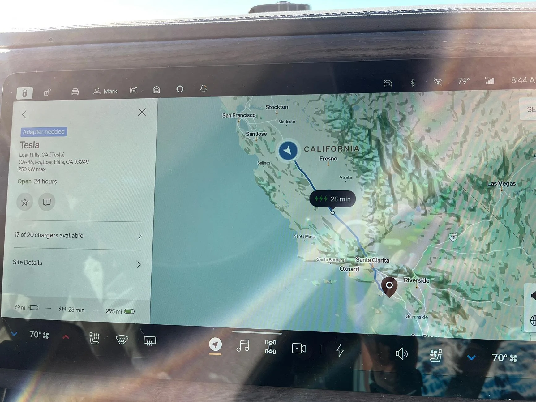

We found out on this trip that if you zoom out and then click on a desired charging location some distance away, the zoom-out will hold...most of the time. I don't believe that you even have to add the charging station. This gives you the ability to see upcoming charging stations and make a decision on where to stop without having to zoom out...again and again.
