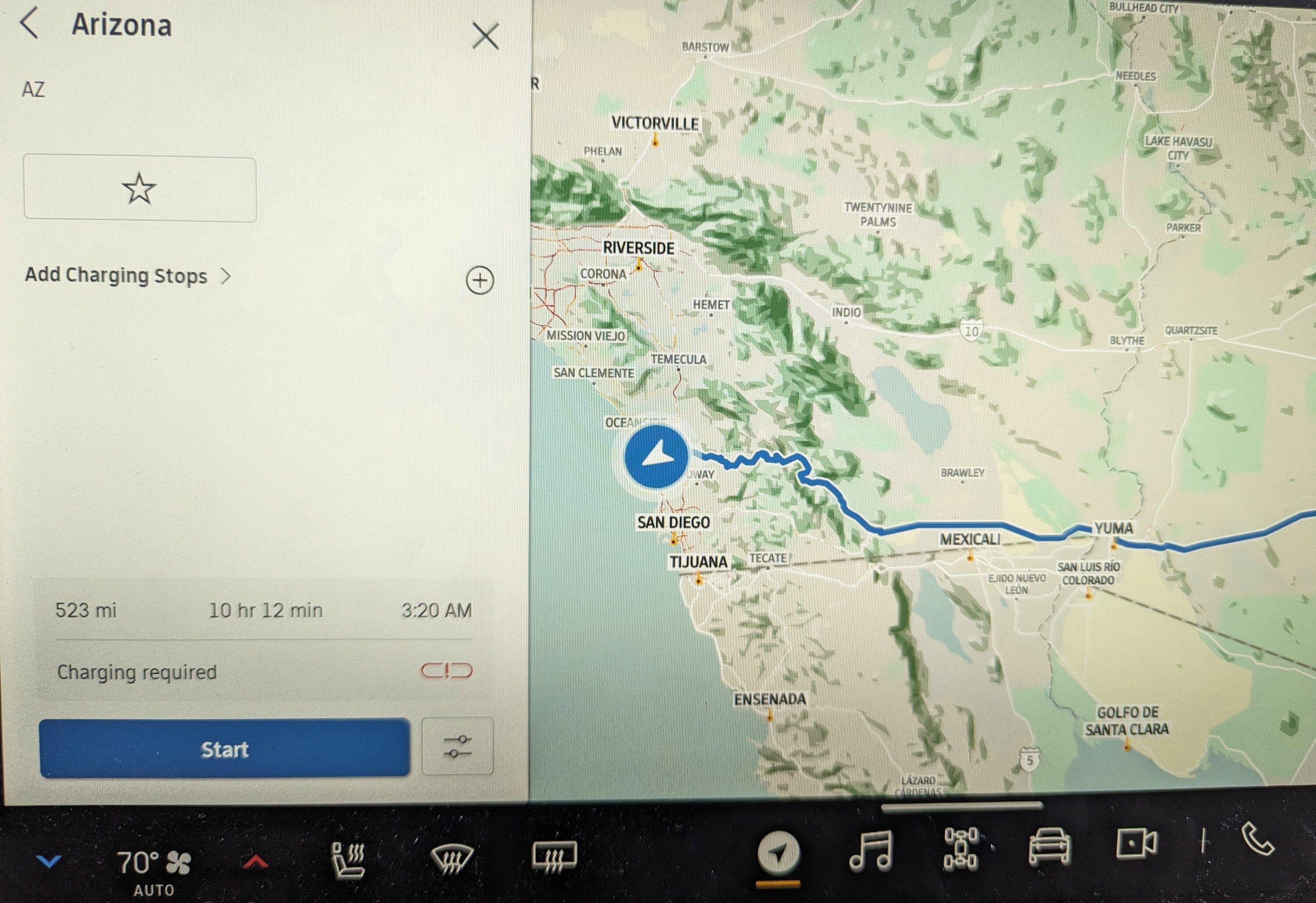

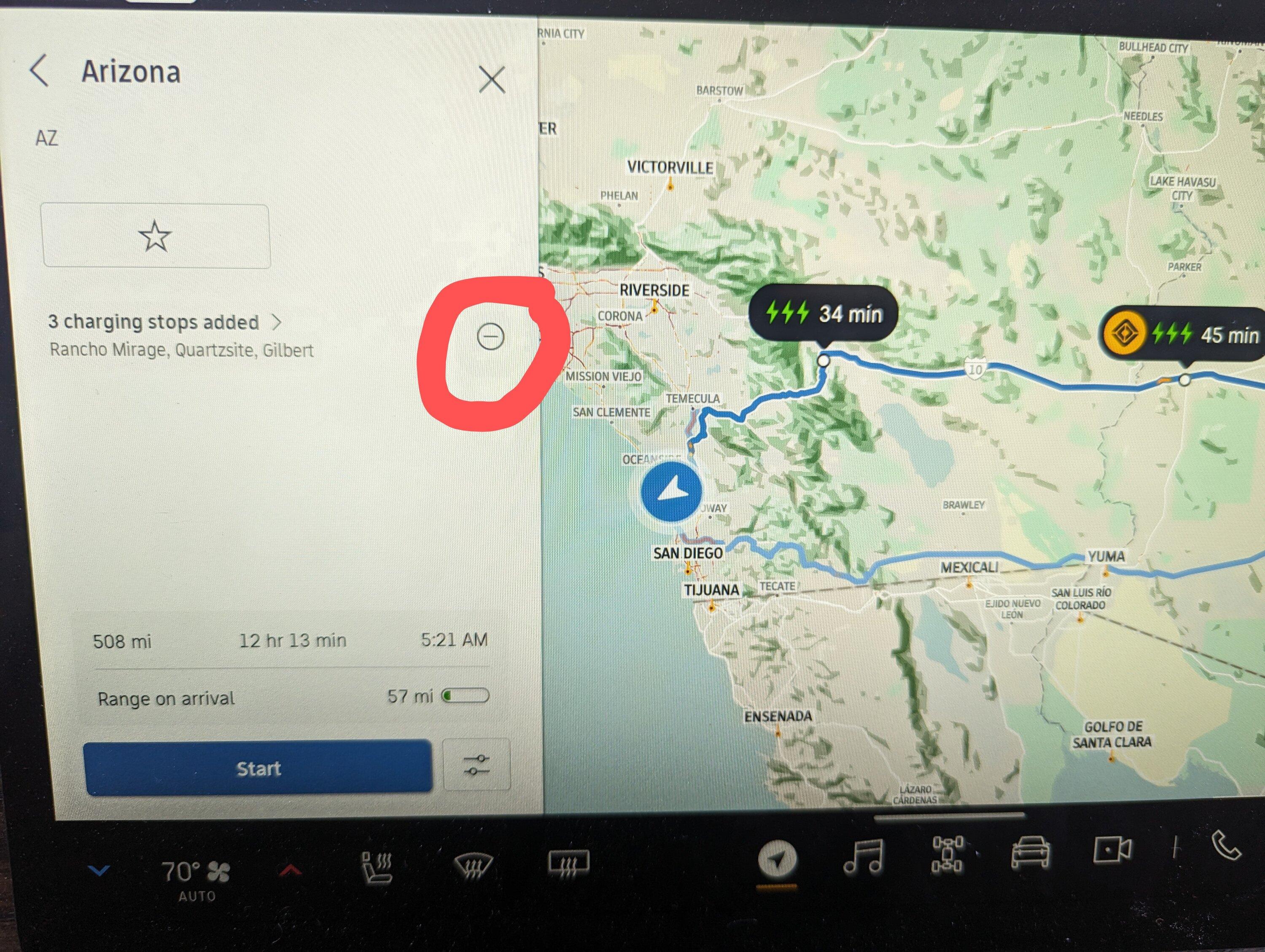

When you put a destination in, press the little circle next to the charging stops

After, it'll just take you from point A to point B!

Remove works until you start driving. Then it reroutes you and there's nothing you can do to avoid it. Super annoying.
