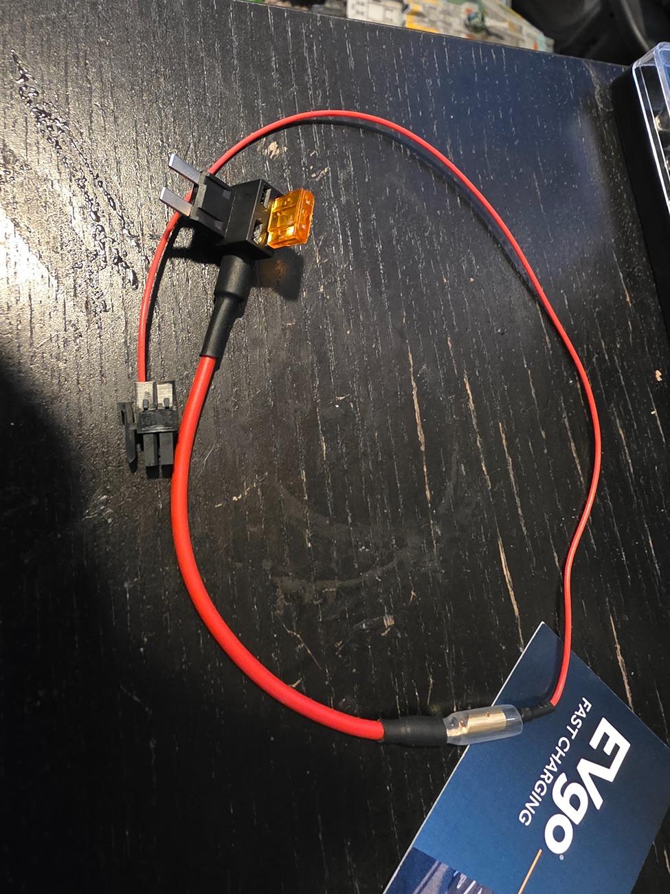

Harness tap for rearview mirror

By the looks of it, it's basically the same function as the pin taps, just made in plug-and-play form.

Has anyone tried this? Does it work?
I've used the FITDVR adapters in other vehicles and they work great, but there is none for Rivian.
bod925
Jan 17, 2025
Hickory, NC
2025 R1S
Not yet. I spoke with the owner of this company and the current harness only works with gen 1. He is working on a harness for gen 2, which I'm get when available. He said it would be another month or two before it's available.

Would something like this work for comma 3x? I don't have one so I'm not sure on power draw of the screen unit

Maybe, but the cable that runs down the A pillar isn't just for power, it's the connection to the AXM and CAN bus so you wouldn't be able to eliminate it anyway.

It looks probable, but that'd be another long cable to route from the mirror harness all the way down to the passenger footwell. Lukas is working on a power adapter that would tap into the passenger footwell fusebox so there's no need to route any long cables.
Rivian R1T R1S Harness tap for rearview mirror 1000007564

I just installed my dashcam w/ this harness. However, the power in always on / continuous. Is there way to turn off the power when the car is off? i don't want to drain the 12v battery.

Gen 1 or Gen 2? This harness is essentially the same as the more commonly used mirror tap. Have not seen anyone (gen 1) say their mirror tap stays on. If yours stay on, I think the only thing you can do is to make sure you turn your radar detector off manually (though the power draw should be very small if left on).
