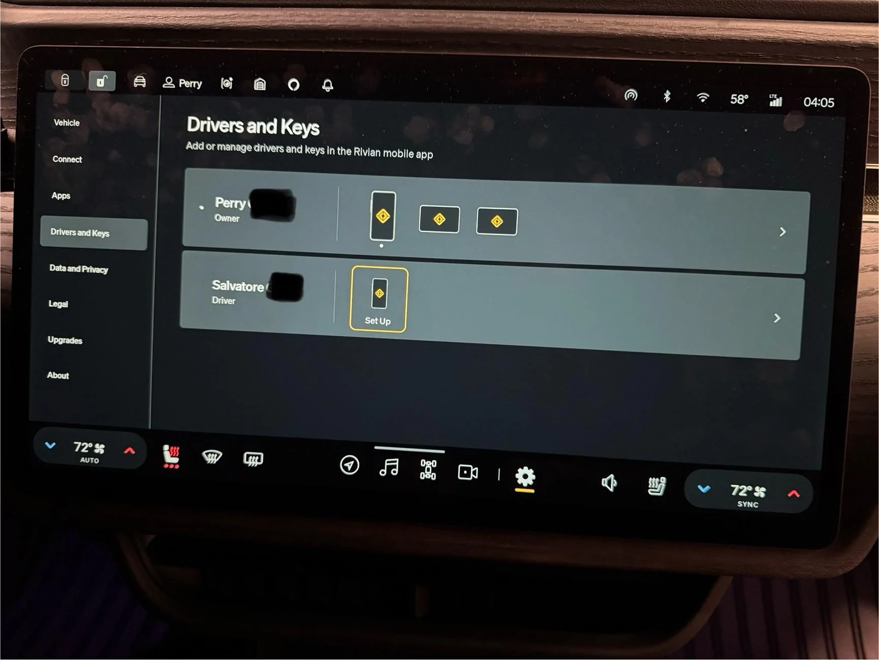

Hit a new issue that call center service nor Customer Experience can resolve - wondering if anyone has had this happen too/has suggestions.
THE PROBLEMS
  1. Gen2 Keyfob will not associate with vehicle (shows as key in app, not in vehicle); doesn’t work at all
  2. Unable to reassign RFID Key Cards between drivers - app shows reassigned, vehicle does not
  3. Additional driver’s phone key randomly got disabled by vehicle; will not get past “connecting to Bluetooth step” when trying to re-setup
GEN2 Keyfob issue
  • Went through setup via the App as directed, app shows it was successful
  • Keyfob never stops flashing yellow; doesn’t appear in vehicle under Drivers & Keys
  • Reset Keyfob multiple times - holding trunk/lift gate buttons, removing battery etc
  • Removed and re-added Keyfob through app multiple times
  • Hard reset of vehicle (left+hazards)
  • 5+ calls with service & engineering, no resolution
RFID Key Card Reassign
  • Reassigned through my app, shows reassignment successful
  • Reassignment does not reflect in vehicle’s Drivers & Keys
  • Multiple attempts to reassign back-and-forth; always works in app, never in vehicle
Additional Driver Phone Key (iPhone 15 Pro, current OS)
  • Flipped from working to “setup” when first trying to pair Keyfob - strange…
  • Setup through vehicle got stuck on the Bluetooth step - phone never prompted
  • Found Bluetooth on phone showed connection to vehicle already there (“Rivian######”)
  • Deleted Rivian app from phone
  • Performed network & settings, and full reset of iPhone (pain in the butt, but worth a shot) - force clearing
  • Redownloaded Rivian mobile app to phone
  • Created entirely new driver account with different email, new invite, etc
  • Drivers app shows vehicle info - charge state etc - but key setup continues to not work
SERVICE SUPPORT STEPS TAKEN
  • Had CE/Engineering reset vehicle association with my account (6 days to do this)
  • Service confirms vehicle is online and visible in their system; tested live connection by opening and closing doors to see if they saw it happening; they did
  • Multiple vehicle hard resets
  • Service Center appointment
Oddly, my mobile app & key (as owner) continues to work without issue - thank god. But frustrating no other keys are working as they should. If anyone has additional thoughts on how to fix, I would be massively appreciative!

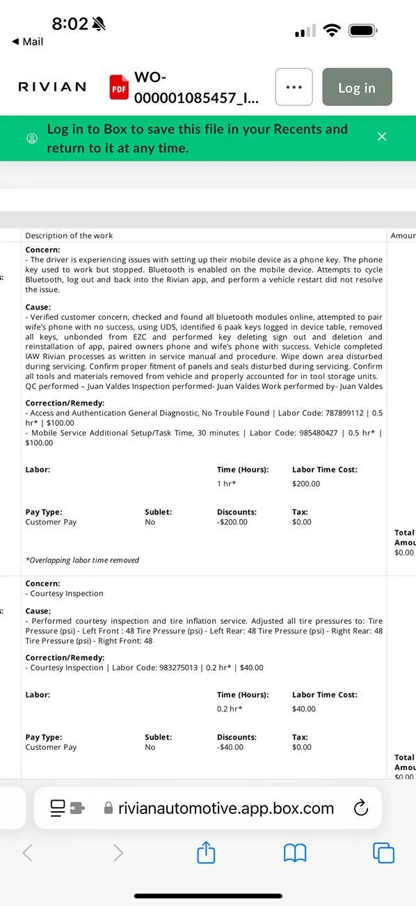

I just had this repaired by mobile service. I’ve attached the work order service recap so perhaps you can reference speaking with service. Basically there were 6 key profiles in the cloud from me trying to reconnect the phone. After Rivian deleted all on the back end. We deleted all keys on our phones. All from blue tooth. Deleted both apps. Reinstalled and re-paired which fixed it. Apparently next software update addresses this issue too.
