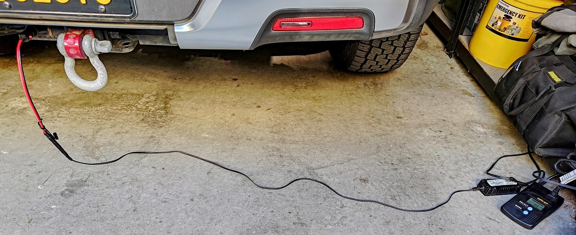

Okie dokie, well here we go...power draw started at 3w and then over a few minutes came down to 2w and is sitting there now while the software update installs :rolleyes:
Proximity locking & gear guard disabled (and at home anyway, doors unlocked), [email protected]%, and can leave it just sitting there unplugged from our L2 charger for the next 24h or so.
Rivian R1T R1S Gen 1 Vampire Drain (Possibly) Solved (or Hacked) P_20240815_175047~3
Food for thought, in Camp Mode, there was no power from the trailer plug. Tried that first and then had to wake it up to light up the port.
Good info on Camp Mode. Looking forward to the results!

Test Update: Starting at 10PM last night, the truck slept for just over 4 hours, woke up for 90 minutes burning .230kwh, probably thinking about existential issues and rolling over again and again...and then went back to sleep for 3.5 hours and counting.
