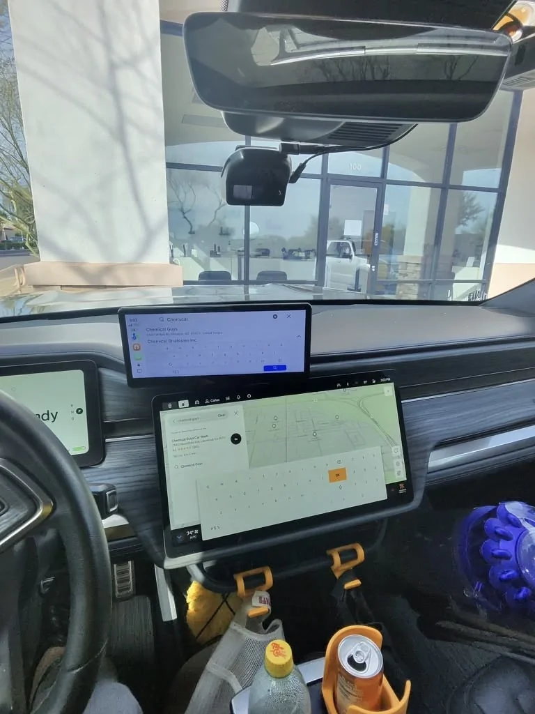

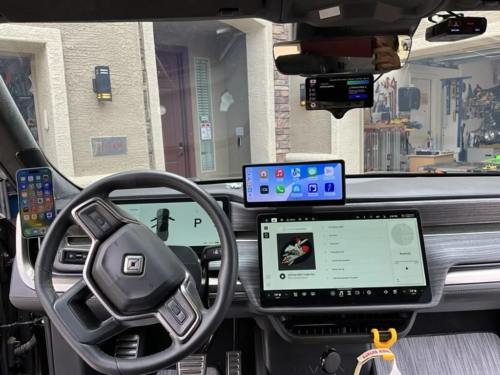

My only concern was how bulky it is to have a phone hanging under your mirror. Is the new Comma4 mount any cleaner in that respect? I assume it's just a hard cost of doing this as an aftermarket vs. OEM product, but maybe they've been able clean it up a bit.
SwampNut
Carlos
Apr 22, 2024
51
3,550
3,766
Peoria AZ
2022 R1T Launch Edition
Geek
The C4 is MUCH smaller, although it has to mount slightly lower too for cable space. Unless you want to cut a bit of the cover around the mirror. Definitely less visually obtrusive though.
Thanks! Yeah, it looks more like it belongs there. Appreciate the pic.
