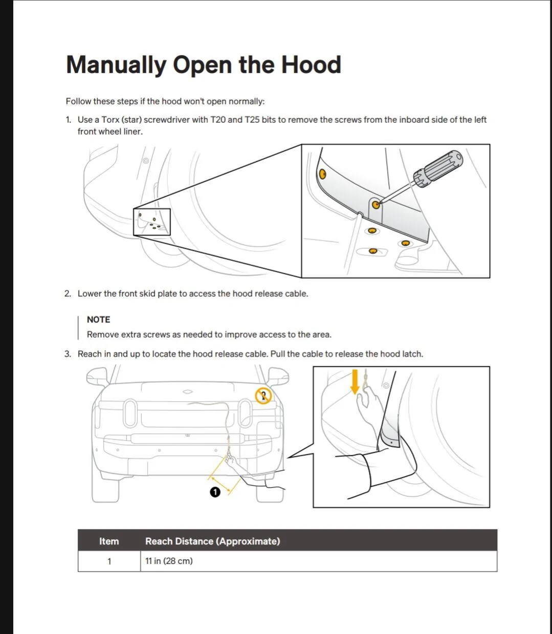

However, you need a T25 and T20 wrench or screwdriver (and ideally a 10mm socket wrench as well) to manually access and pull the frunk's emergency hood release cable (see Rivian's R1 Tow Operator Guide, page 36). The problem was figuring out where to stow a small set of these tools such that it can be accessed by hand without needing any additional tools.

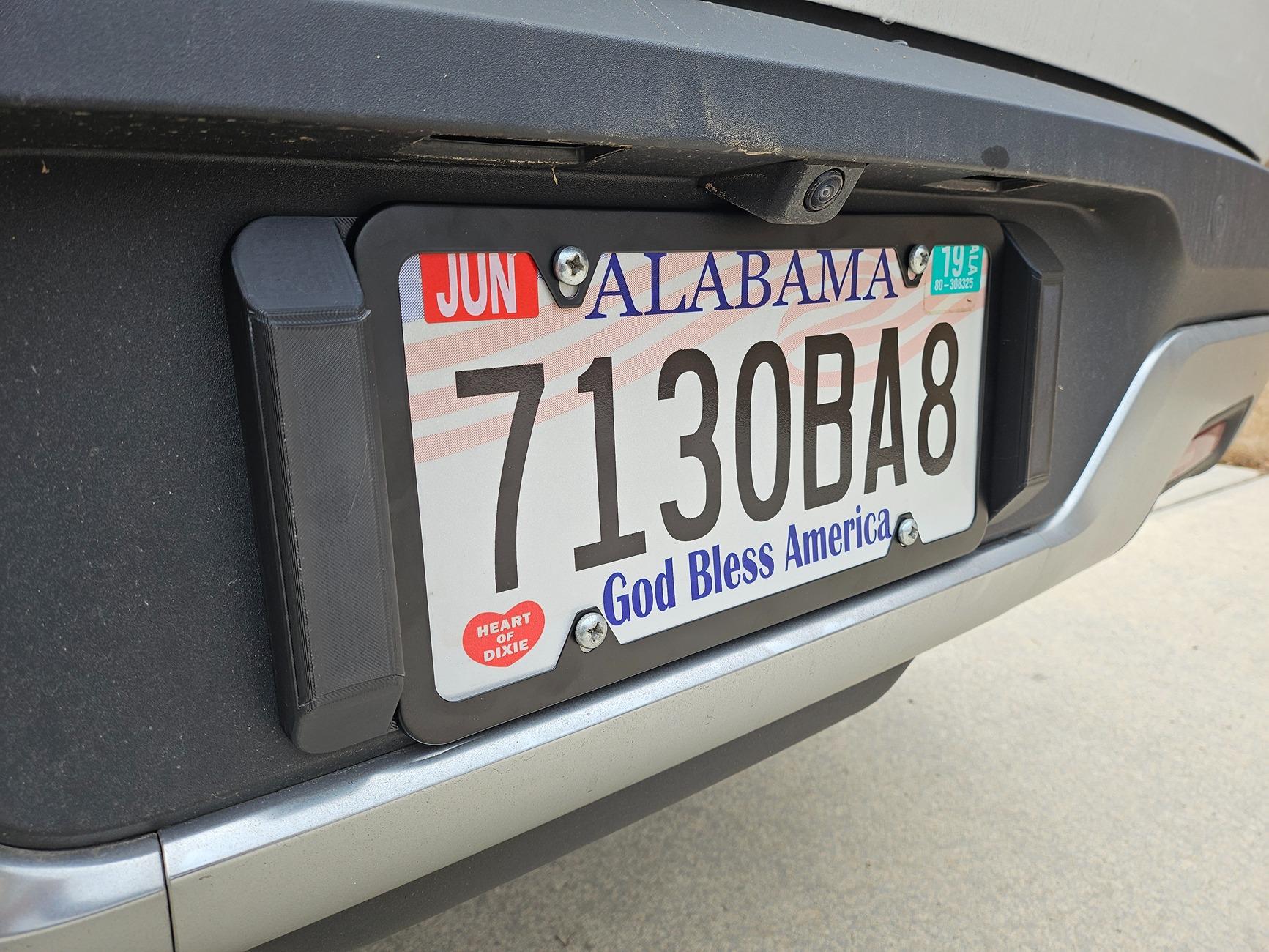

I've designed and 3D-printed a set of tool holders that can be mounted to the left and right side of the license plate. The holder set can hold just the bare-minimum tools from this tool set (affiliate link. Non-affiliate link here) to gain access to the frunk's emergency hood release cable, including:
  • mini ratcheting wrench
  • bit extension
  • driver-to-socket adapter
  • 10mm socket
  • T20, T25, philips, and flathead bits
The tools are placed inside the holders, and a removable, sliding cap closes it up. Although very tight-fitting (to ensure they don't slip off from highway speed winds, car washes, etc.), the caps can still be removed by hand. It's not waterproof, so I've stored the tools in small sandwich ziplock bags. I've also designed in a mini-sump in the bottom of the interior space of the holder to collect and route out any water ingressing into the storage volume, which connects to a small drainage port at the rear of the holders.
I also designed it so that there's enough space to fit around license plate frames, including the simple black frame (affiliate link. Non-affiliate link here) I used shown in the photos below, to help further blend (and reinforce the rigidity) of the tool holders with the rest of the vehicle.
Currently, I've got over 750 mostly-highway miles on the prototype, including in heavy rain conditions and below-freezing temperatures, and it seems to be holding up really well. I'm especially pleased by how well it blends in with the plastic trim of my R1T.

Looks like a clean install.

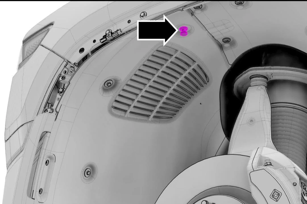

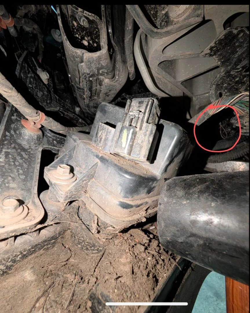

So once you get access, what do you pull? I was up in there recently for an unrelated reason, and I never saw it. I would be sketched out to reach around and pull on random cords.
Edit: I'm pretty sure I found it! Pic updated.
Rivian R1T R1S Frunk Emergency Access Tool Holder Idea 1000002880
Rivian R1T R1S Frunk Emergency Access Tool Holder Idea 1000002885
It got me thinking, would the cord reach to the wheel well vents? Could you secure it there instead? Or any other place much easier to access? (Ignore the arrow)
Rivian R1T R1S Frunk Emergency Access Tool Holder Idea 1000002883
Yeah, I used an expired out-of-service plate I had handy for the photos instead of my real plate. It's kinda of an Easter egg showing a 2019 plate on a vehicle that wasn't released until 2021; I'm sure future historians/archivists are gonna get a kick out of that ?.
As for easier access to the loop, I'm sure you could finagle something like tying a rope to that loop and routing it to the wheel well. However, I think part of the intent of making it hard to access was to deter thieves of opportunity from breaking into the frunk too easily.

That’s such a neat design I didn’t even notice the tool boxes until I read the body of your post. Nicely done!
