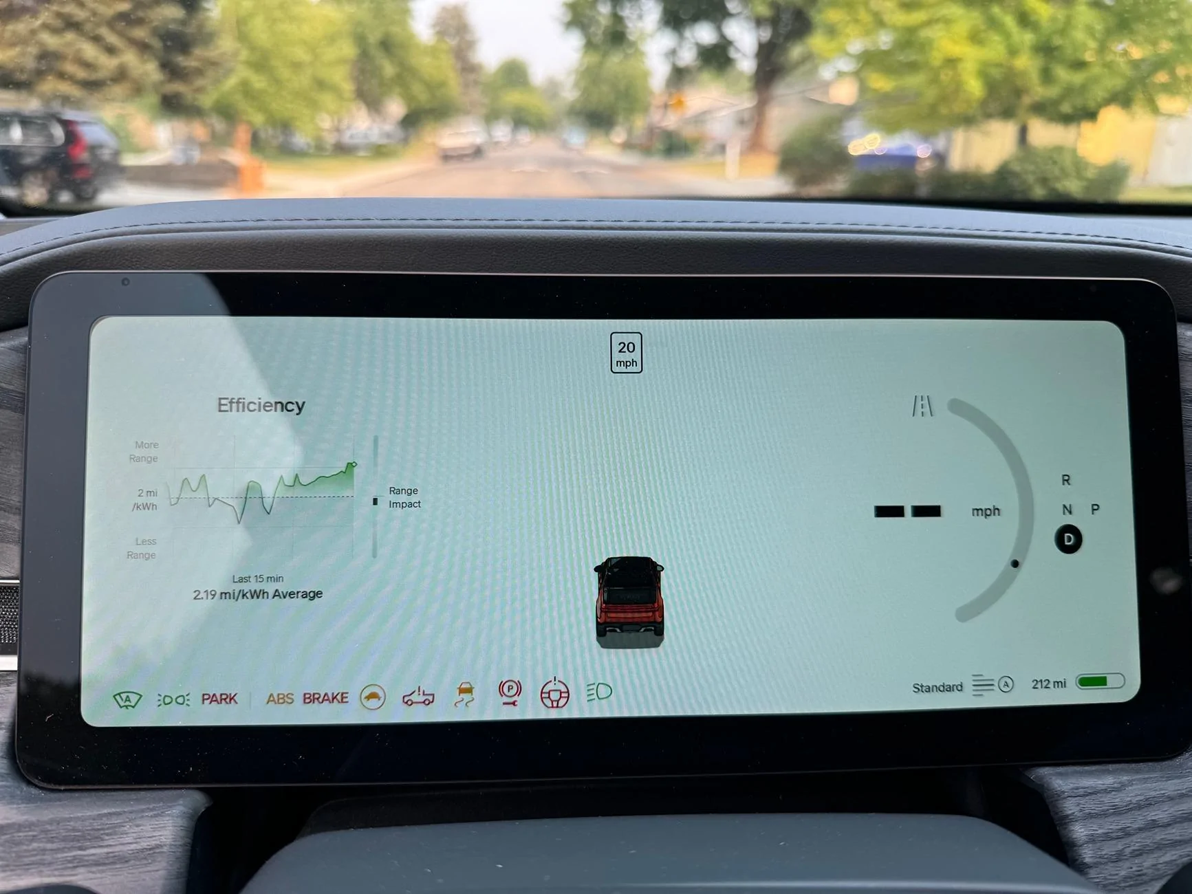

My screen stays frozen on camera mode. Anyone else experiencing this? Would hate to ask for service because it will be November - if I’m lucky.
Yes I also have random screen freezing and warning symbols that will not clear as normal. Mine happens when ambient temp is 100+ and began after latest update. Currently in the service center. I was told last night that the Rivian engineers in CA have been able to reproduce the error on their mock up lab model truck and are working the issue now. Glad for a loaner R1T.
