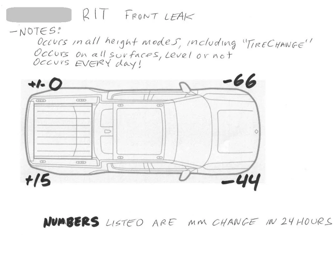

After almost 3 weeks at the SC, my R1T's suspension drop issue is resolved. In a nutshell, the front would drop as much as 66mm in 24 hours. It didn't matter what mode (including tire-change) or where it was parked. I came to the SC armed with a diagram of the vehicle with notes about exactly what sort of drop I was observing with other details to make it really hard for them to dismiss this as a "normal" behavior.
The fix: The first attempt was to replace a valve module. This may have improved things, but I got mixed info so I can't be sure. What seems like the real issue was, according to the service advisor, a "rolled" O-ring in a connection to the air tank. The leak was very slow and independent of "software" things so this makes sense. The invoice notes just say "Found leak at air tank".

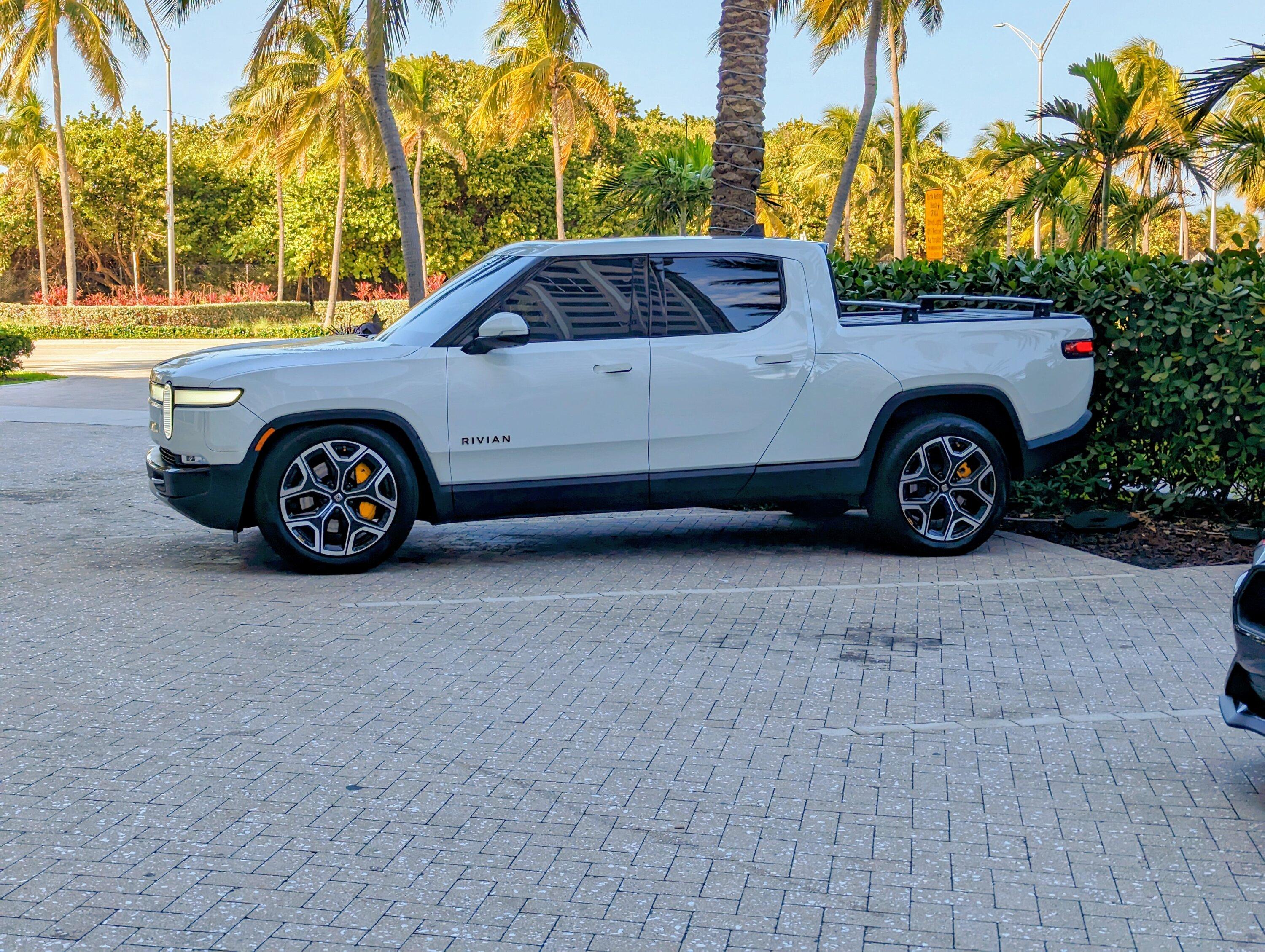

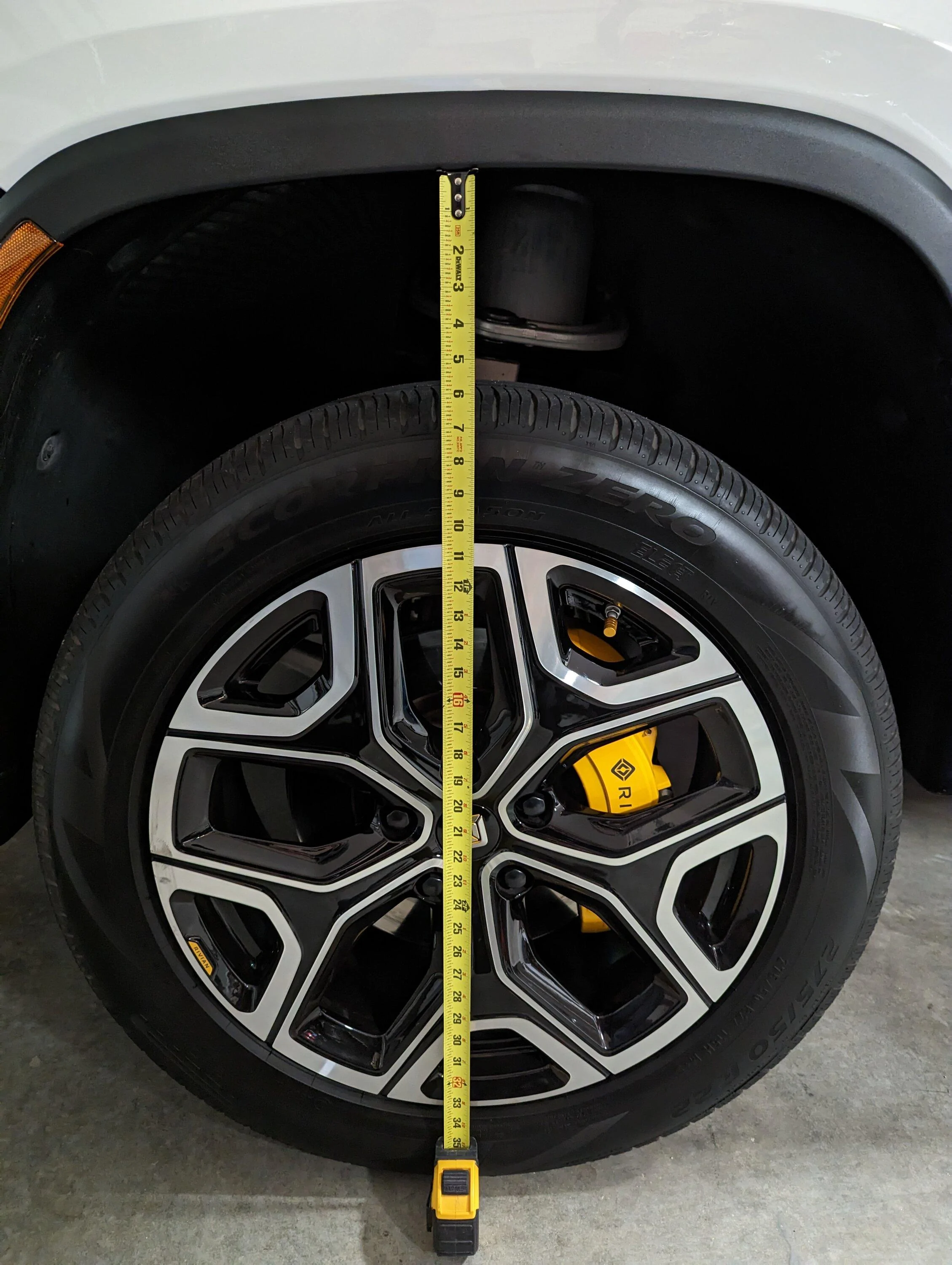

I'm running into the same issue. I set it to High ride height in All Purpose mode and come back 48 hours later and the front driver side lost 100% of its lift and the front passenger lost 75%. The rears lost about 25%.

My leak, since it was only in the front, caused the rear suspension to extend. Your leak looks like it affects the whole system. I gave the SC a diagram to help with debug (like shown below). They appreciated the info.

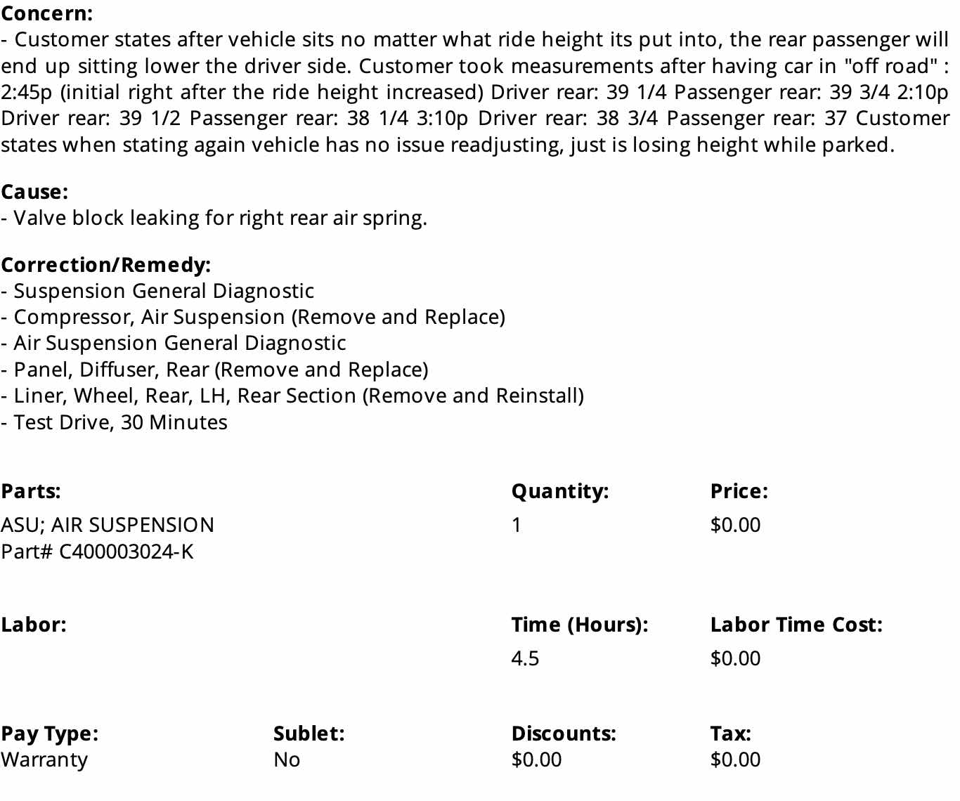

I just dropped mine off at the Richmond SC yesterday. Will update when I get it returned. Interestingly enough, mine was primarily on one side (rear passenger)...that side dropped an inch an hour (same in any mode, tire change or not).
BTW: Mine was delivered this way so not an issue that developed afterwards.

5 minutes after I posted this, they called me back. The found the air block for the right side was leaking badly. They replaced and observed and said it is good now. They said a little drop after setting for several days is normal and the right side tends to drop a little more but mine was way out of normal. Hopefully this takes care of the issue.

Thanks for the diagram. You've inspired me to do an overnight test. We'll see how much drop I'll get in 18 hours. Unfortunately I can't go 24 hours without driving.

They didn't but I just dropped my car off Thursday 8a and they had time to observe and make sure it wasn't leaking when they called me at 4p Friday.
I did exactly the same as the ruler test above which is how I got the 1" per hour drop. I would recommend you put it in tire change mode which should keep the suspension from adjusting itself. I sent the summary of the measurements by hour for several hours when I submitted the service request (as well as some pictures of the leaking side vs not).
Like yours, mine wasn't uniform - for me it was very clearly the back passenger side. The truck look just broken after sitting for a few hours.
I did see Madgrey's comments earlier about his being chasing gremlins so fingers crossed it is fixed (I live quite a ways from a SC) but he did seem confident so my guess is it was leaking badly and obviously.
