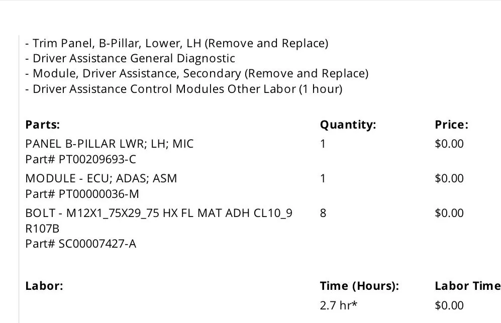

I finally had the car looked at, they replaced the ADAS module on my car. I haven’t had an issue since.
