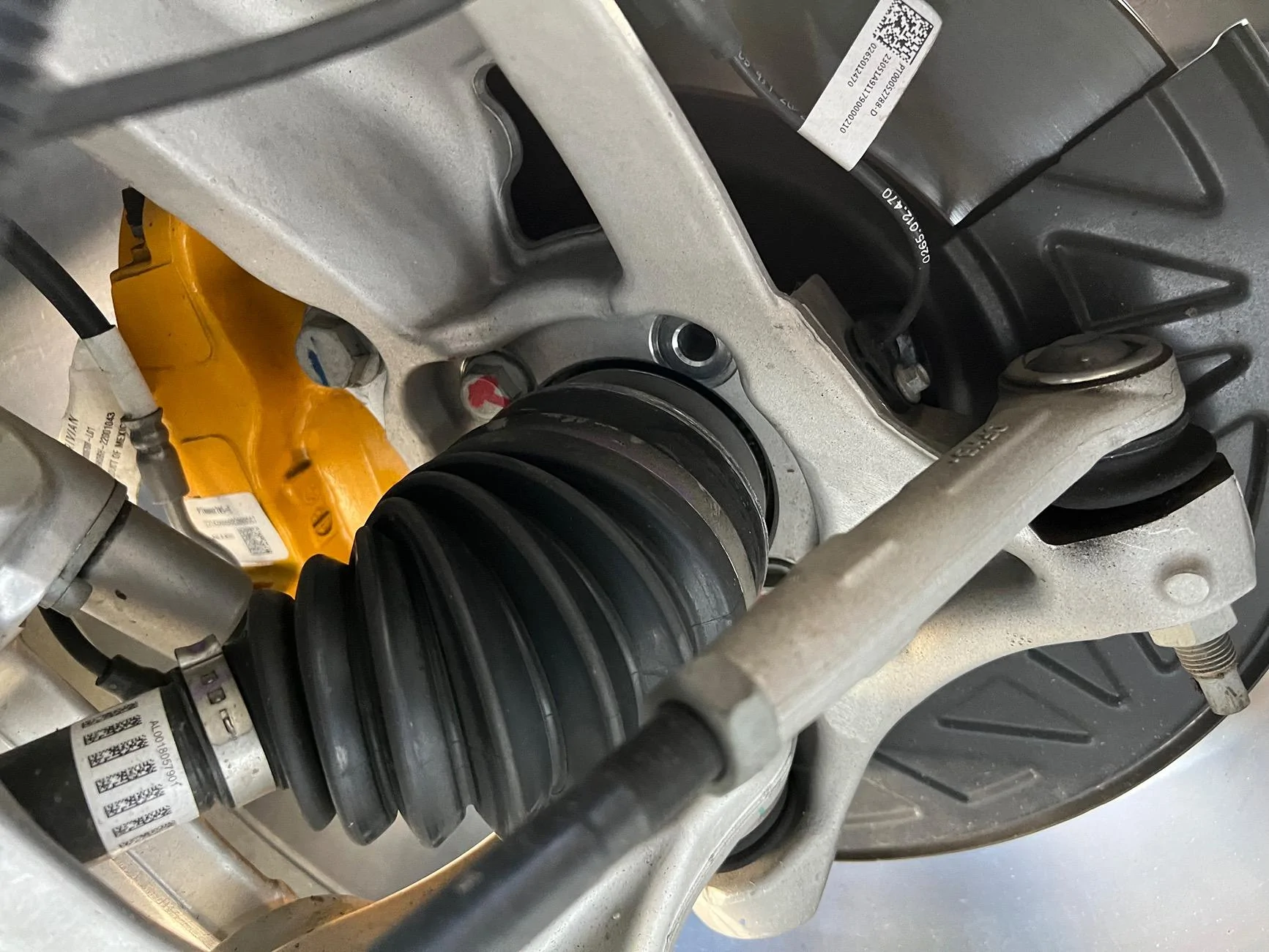

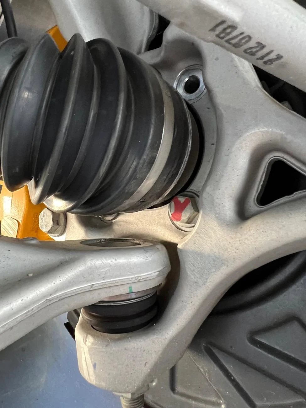

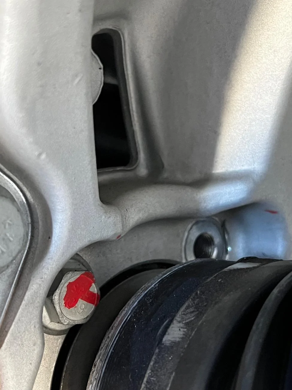

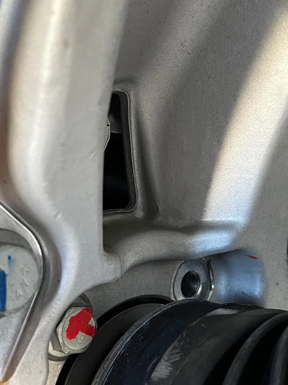

If it makes a loud metal on metal crunch noise could be a loose bolt like mine supposed to have 4 but as you can see one went missing and thats when the noise stopped . Its in the shop now.
Yikes...
