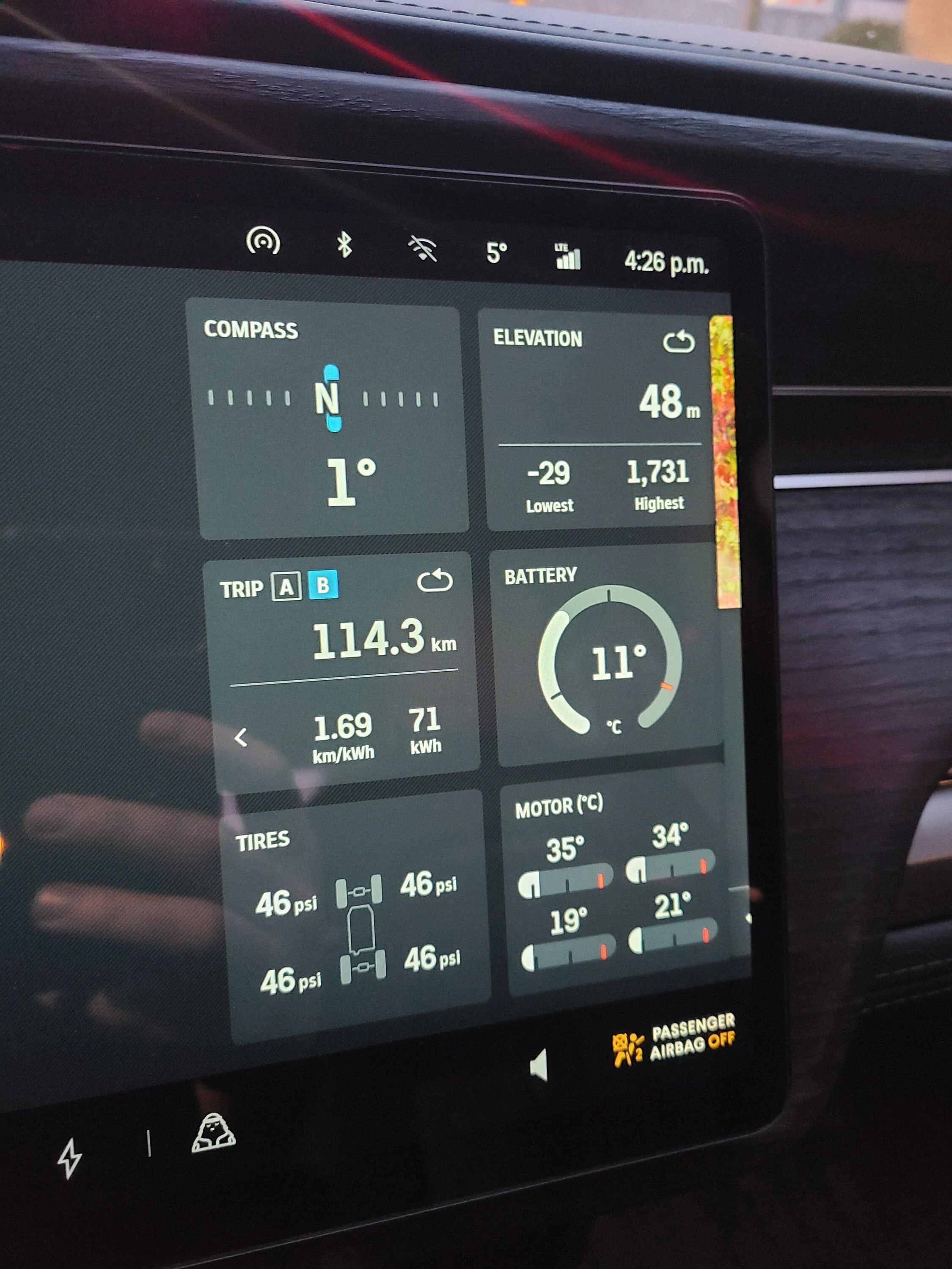

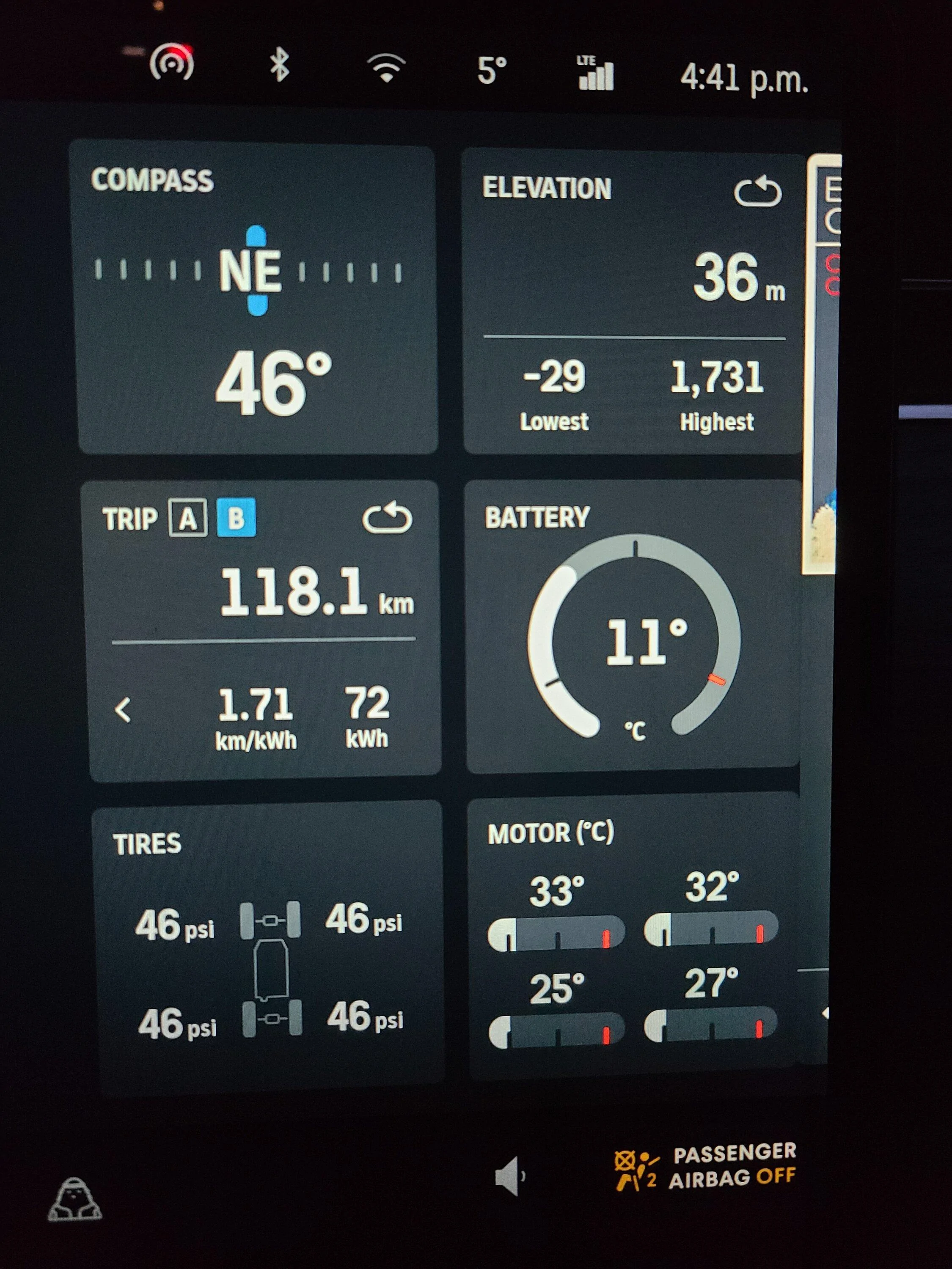

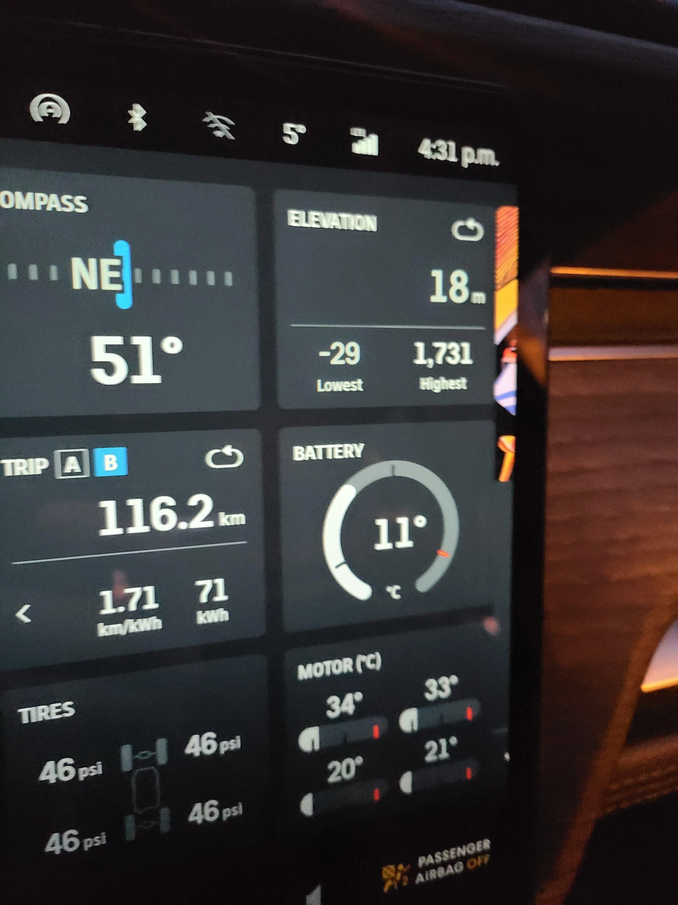

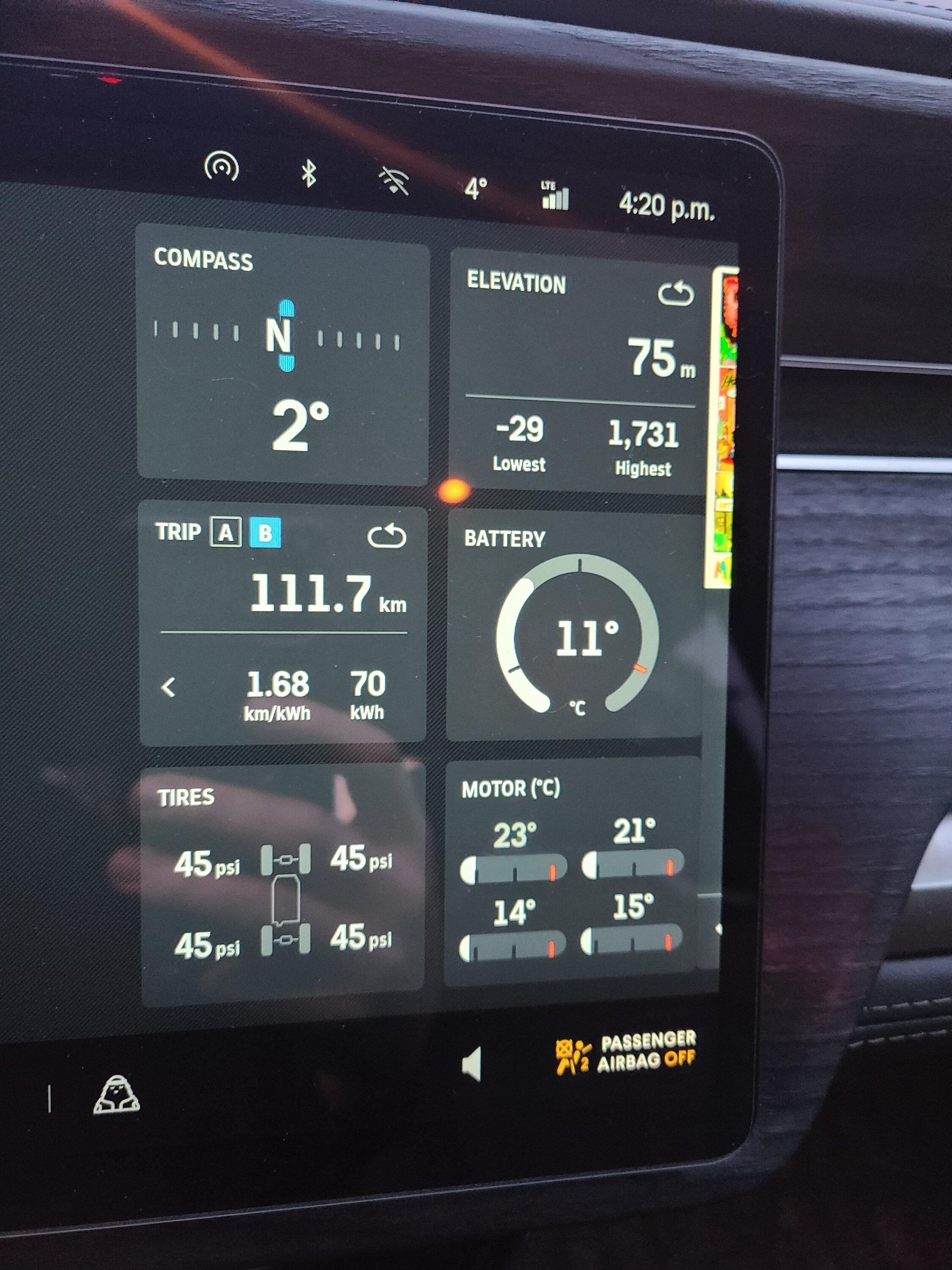

Further quad data point. No snowflake icon this time but nearly similar starting temps, same drive, same time of day
Also, @Riviot this one's for you buddy! Although admittedly I'm more of a Bing man myself?
Rivian R1T R1S Enduro Battery Heating 20231130_162001
Rivian R1T R1S Enduro Battery Heating 20231130_162621
