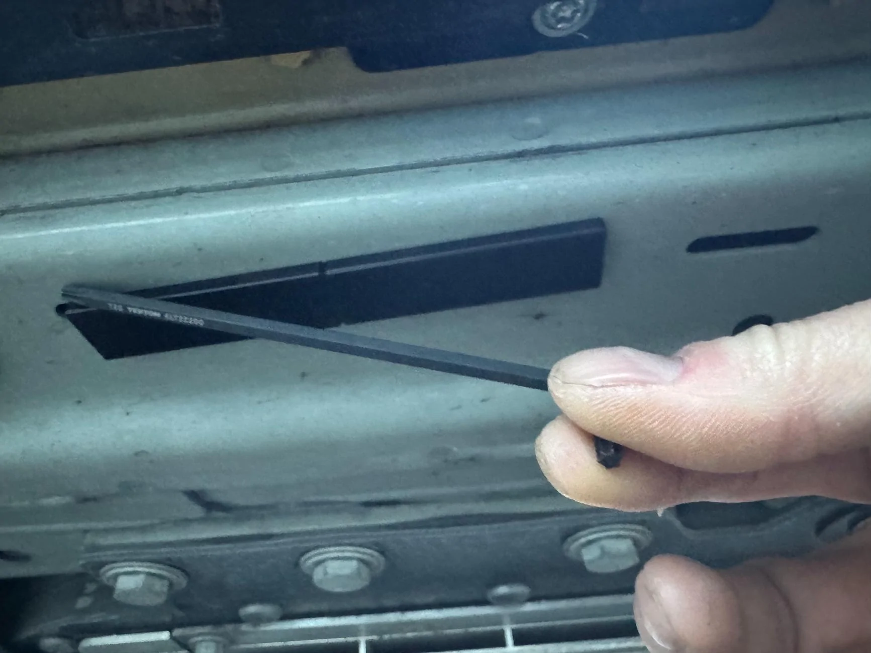

1. Placement of magnets and T20 key: I placed this under the drivers side on the frame. We'll see how well this holds up. If anyone has better ideas for a secure location let me know!

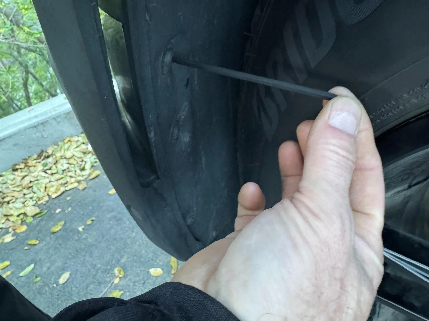

2. Opening the wheel well - There are 6 T-20 screws that must be removed, once these are out, pull out the panel from the trim just enough to fit your arm into the space.

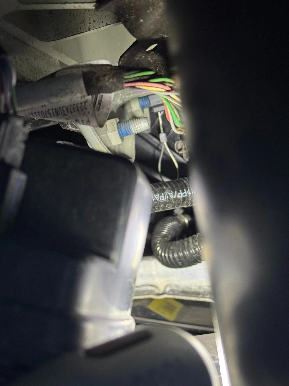

3. The frunk release - This is a bit tricky. The release is a small cable loop about 2 feet in directly horizontal to the opening that you make. Picture below shows it pretty well. Use your rivian flashlight to spot it then reach waaaaay in with your right arm and pull it. At the same time you need to either reach up with your left arm to push the hood up so that it doesn't re-latch OR have a helper do this.

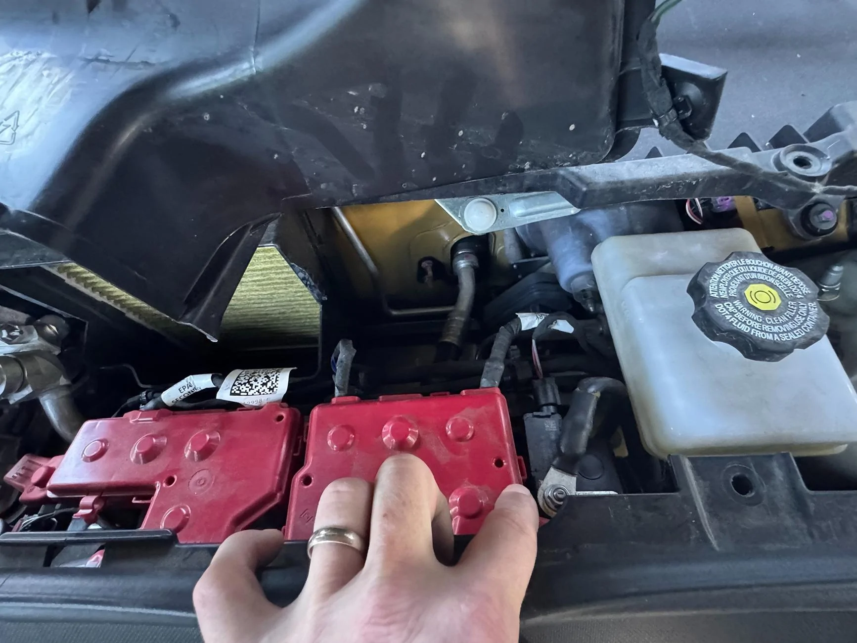

4. You now have access to the frunk and main 12v battery (On the drivers side) by popping off the panel above the frunk and lifting out the air handler. OR use your jumper at the rear to jump there.
