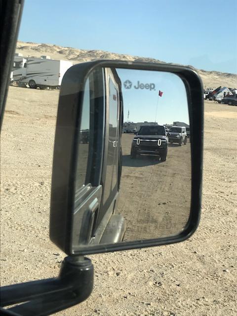

I'm glad to know you have had vast experience in both the QM and DM. I got myself a gen 2 DM performance with max pack. During my first month of ownership, it was in the shop for 1 month, so they loaned me a gen 1 QM r1s. I took it off reading, and it impressed me. I was 3 wheel titer totting, and no matter how scary the trail looked, this used to be a level 2 trail, now it was more like a 3.5 because of the rains of the last few years. The QM figured out every single obstacle out in all terrain mode.
Finally got my DM back and went off roading this time with a group.....man I got stuck 2 times, first one the r1s wouldn't go over some big rocks, had to get winched, then second time was a steep ascent, some 12 to 16 inch step ups, nope would not go up them, it felt like the computer just couldn't figure it out. I was quite disappointed, I had to get winched out again by a Jeep from the top of the hill. I was at 28psi. Using the AT factory 20 inch wheels and tires.
I tried all terrain most of the time, until I went to soft sand and then the vehicle seemed to start doing better climbing out of stuff.
My spotters were saying the wheels with no traction were spinning and no power was being sent to the wheel touching the ground or the boulder.
So I'm quite confused, with what you are saying, I shouldn't be struggling so much with the DM compared to the QM.
The trail we did was a 3.5 level run.
