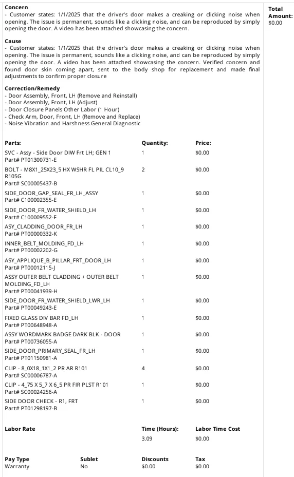

Here's the invoice for the door replacement, truck was at the SC/body shop 1.5 weeks or so, but there was snow in the south during that period so there were likely freight delays.
