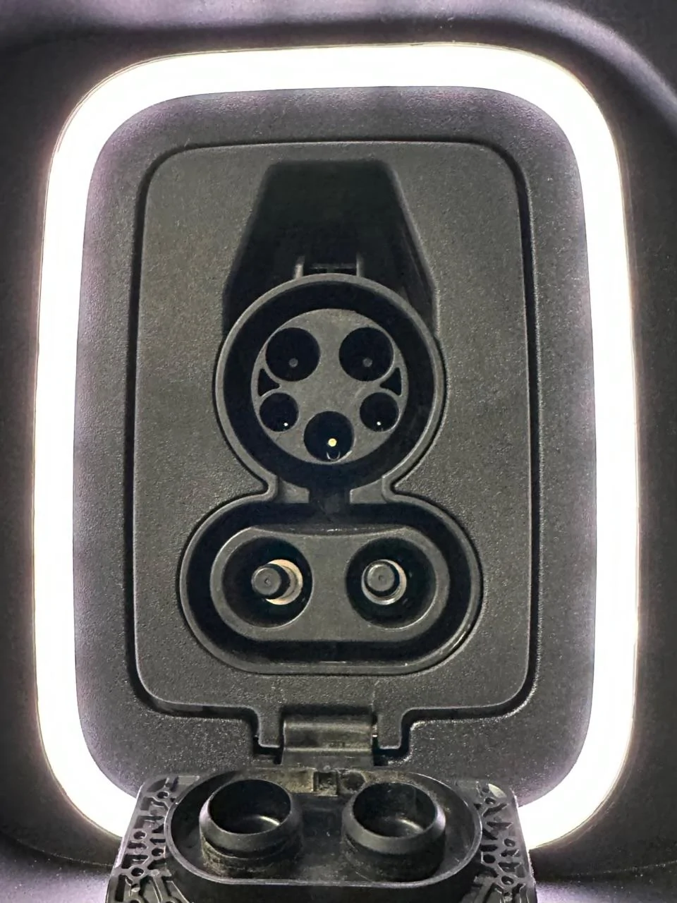

I’ve had that exact issue one time while at EA charger, the other time my speeds were limited to 100kw.
Is one of your DC pins looks bent like this btw:

My DC pins look fine. If it were a physical connection issue I would expect the problem to be more consistent.
