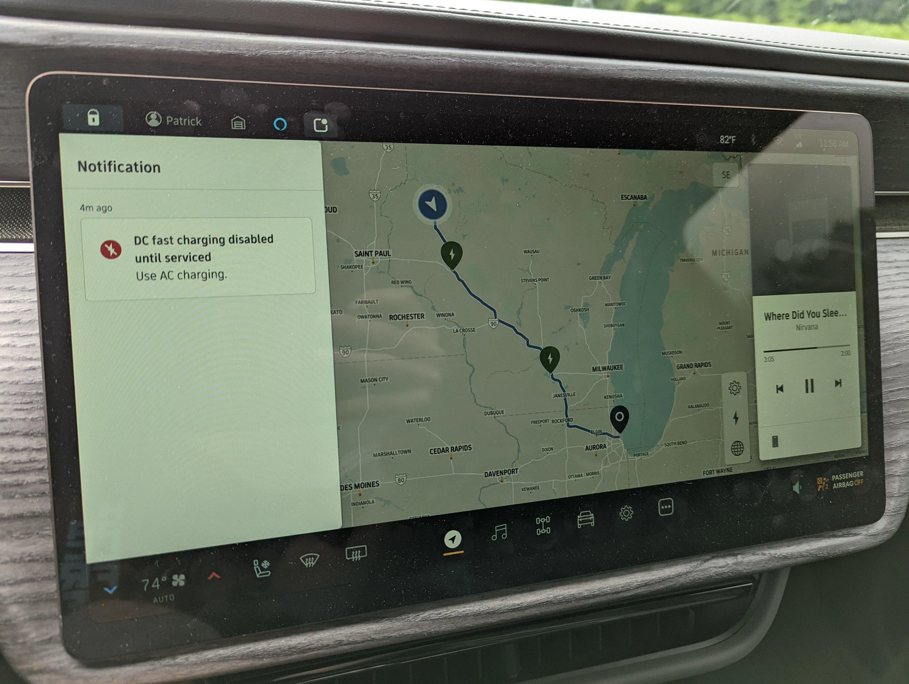

This scared me when it popped up on my trip this weekend. I got this warning every time it wanted to precondition. It had no affect on my ability to DC fast charge. I put in a ticket to see if there is something wrong. After a day of rest for the truck I told the navigation to route to a fast charger. It happily said it was preconditioning and didn't give me this error. Maybe it's intermittent. Hopefully it continues to not affect my ability to fast charge. Either way, I'm in the waiting for answers camp.

Has anyone ever gotten any resolution or updates on this? I've now had this error twice over the past couple of weeks.

After my last post, it never happened to me again. Not sure if it was the next OTA or what that "fixed" it. Have you submitted a service ticket for it?

Having the same issue here. Brand new R1S with 100 miles on it. 109xx vin. Have only charged with level 1 120v trickle charger since I took delivery. Kind of disappointed to have an issue so soon but hopefully it can self resolve without me needing to drive it 2 hours to Brooklyn to get it fixed (plus whatever amount of time I’ll be without it).

I was also having this issue on my new R1S 7XXX vin. The warning appears intermittently and I was able to fast charge two times when it wasn't there. Dropped off at service 2 weeks ago to address this and a couple other issues, zero updates so far. Frustrating to not be able use an 80k new car...

Have they been able to resolve your issues yet? I spoke to an SC and they suggested resetting the vehicle, which I did but the warning continues to appear. I was able to charge at a 150kw fast DC charger without any problems though.

The car is still at service but they said it was due to a faulty CGM (central gateway module) and instrument panel harness. They are replacing those so hopefully that fixes the issue.
