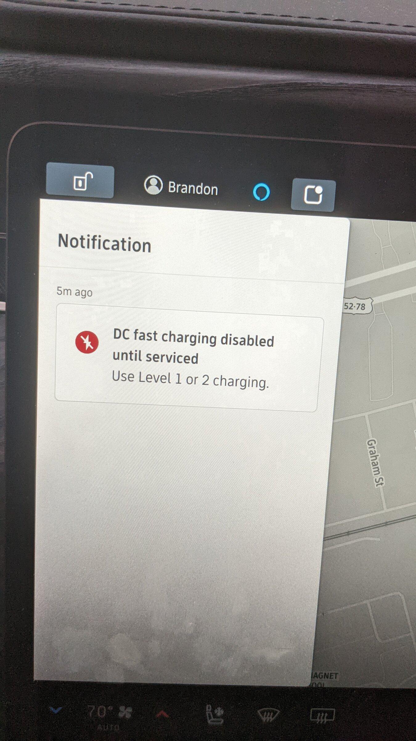

Rainy day. My wife unplugged the truck and called me with the error after she put it in drive.
Called service and they didn't see any issues.
We put the truck in "sleep" by locking and walking away with charger unplugged for 30 min.
Issue resolved.
Service said this process has been 90% effective at clearing these randomly occuring errors.

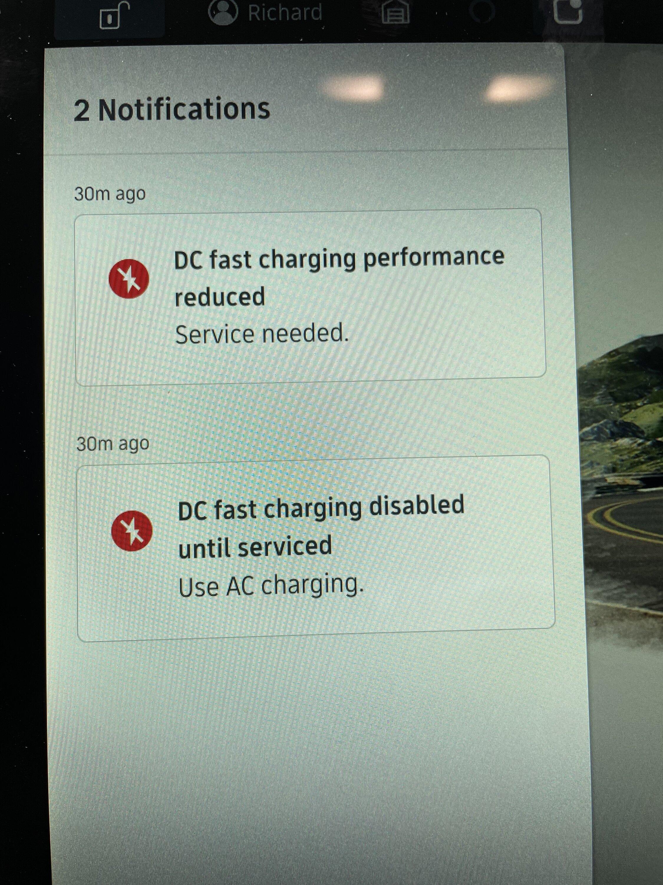

I’ve had this issue intermittently for the past 10 days. Mine was not occurring during or related to DC charging. My truck is currently at the Brooklyn service center.
Rivian R1T R1S DC Fast Charging Disabled until Serviced 9FF07FB4-140F-42D6-8616-92DF4F65C93C

I was able to do a few laps around the parking lot after my charge errored-out at 57%, but it would only pull about 45 amps.

I’ve been getting the warning for over a month, including time at the service center where they said it was not actually affecting dc fast charging. I’m skeptical as I’ve had some issues at EV America stations AND now at my home Rivian charger! Maybe some help in the soon to appear 2022.23.xx?
