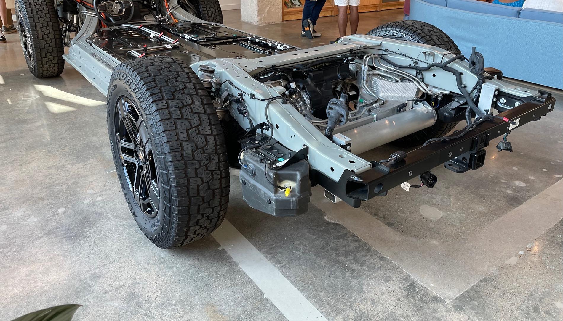

I assume the suspension compressor and not the inflator. The suspension compressor sits behind the wheel well and has a pretty large tank below the third row.
