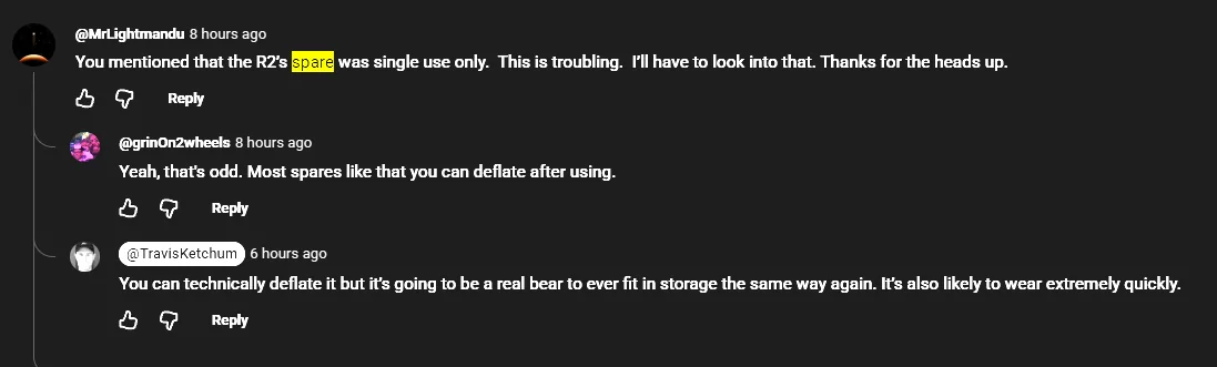

I checked for @travisketchum 's response in the comments in 1the video. He's saying it will be "difficult" to get it back into shape to fit back under the floor. If true - that's enough not to bother with buying one. My insurance will cover the costs of road service cheaper than spending $800 on a use once then it's an annoyance tire.
