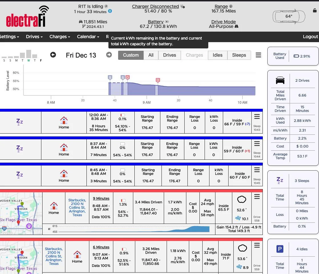

Also in Michigan. FWIW, I keep my gen1 T plugged in all the time in this cold with a max charge of 70% (large pack). My idea is to keep it plugged in to keep the battery warm. Watching Teslafi or the app will show the truck draw current even when I'm at my charge limit, presumably to keep the battery warm. However, I'm new to this so I may very well have this totally incorrect.

I normally keep mine plugged in for much of the winter also. I usually only drive it a few days a week, but it is nice to have the truck plugged in so If I end up wanting to go any significant distance on a cold snowy morning I can use the app to precondition in the garage on shore power prior to departure. It makes a significant difference on efficiency for the first half hour or so of driving to be warmed up.

Just because the vehicle is plugged into EVSE does not mean it is drawing current from the EVSE. Once you reach your charge limit, it will shut off until it drops back below the charge threshold needed to activate charging again, and top the batteries back off according to your set charge level. The draw you see from the truck is the truck operational systems functioning and the cause of "Vampire Drain" that seems to vary based on owner, environment, and vehicle settings/model/year.
The vehicle will not do anything to keep the batteries warm until they drop under a threshold temperature. Once they drop below temp "X," the BMS will activate the heating cycle. The motor coils/inverter are then used to generate heat, the heating/cooling loop then pumps fluid through the heating loop, absorbing the heat from the motors and moving it through the battery pack.
What I cannot find a definitive answer on is what temperature "X" is.

Based on this story, it's 14 degrees Fahrenheit.

What is Teslafi and what does it do if I can ask?
