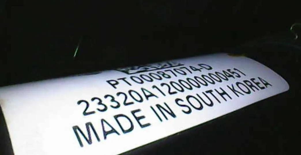

It's just odd that the quads and dual motor setup do it. Here's my Part # on my dual motor half-shaft.
Rivian R1T R1S Clunking sound from front end. 1726882394366-s4
