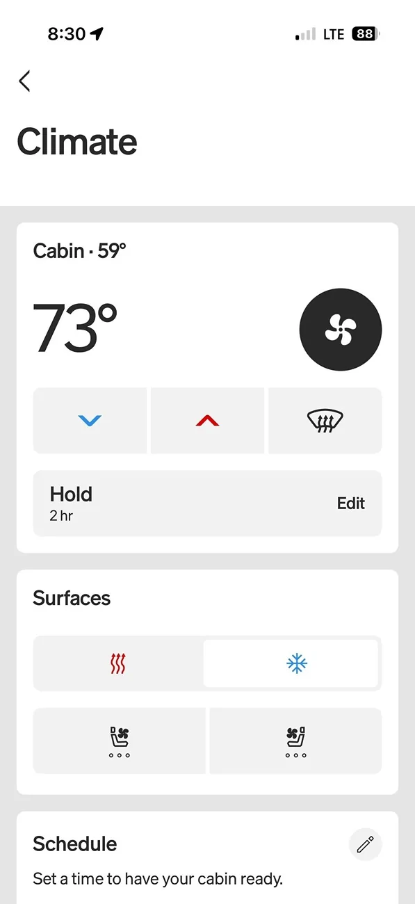

Hey R1S family. I took delivery of a gen2 R1S in April 2025. Consistently since delivery, if I use the in-app climate preconditioning feature to turn on the heat, I see the following behavior, and I'm curious if others see it too, or if it's just me.
Assume an outdoor/ambient temp of like 55F degrees (i.e. pretty mild). If I set the cabin target temp to ~70F, then watch the interior temp as reported by the app, it pretty quickly increases to around 61F < 5 minutes and 63F over the course of 10 minutes. 30 minutes later, it'll still be at 63F-64F. It never gets anywhere near 70F, as reported by the app.
It's totally possible the actual interior temp is 70F though. It just seems... suspicious... that the in-app temp shows such a low value. That can't be normal/expected/right. It's certainly not true in other comparable cars. Would love to hear others' experiences.

Thanks everyone for the responses.
I tried it. There's a huge delay in the temp display in the app. Probably some attempt to minimize power/cellular usage. About 8 minutes after remote starting it, the display is showing low temp, but I walked out and it was warm in the car.
Nope, not a power/cellular thing. Persists across pull-to-refresh, app re-opens, waiting many 10s of minutes, opening the car door, etc.
it is really meant to monitor when the vehicle is moving not standing still in either the cold or the sun.
Why not monitor in both conditions? It's absolutely doable. Tesla handles it just fine.

55F ambient temp was to illustrate how even in the gentlest conditions, it couldn't hit 70F. What do you think happens with 20F ambient temp? lmk if you need a hint, smart guy :)

Nope. Car is awake the entire time. As above, persists across pull-to-refresh, app restarts, 10s of minutes, car plugged in, opening car door, etc.

I'm specifically referring to the temp as reported by the app, not how it feels in the car. More on that below...

You might want to skip it and save yourself the trouble. I've actually brought my car in 3 times now, each time reporting this issue (among other things), complete with very clear data included in the service request etc.
The first two times, they pretty much just ignored this problem. They dealt with the other stuff in my request, did some completely irrelevant HVAC test, and said it was fine.
The last time was this past week+ (got my vehicle back today), explicitly for this problem, which the service manager acknowledged as something they would look into prior to my bringing it in. They spent a week trying to troubleshoot it. They easily reproduced it. Then eventually, they decided it was expected behavior after consulting whoever they consult on the inside. They measured the actual in-cabin temp, and it was the expected 70F (or whatever). So the app just reports some imperfect temp for various reasons. Basically: SW bug.
Which is fine. As long as the vehicle is actually getting to the expected temp, I'm content. They should probably improve it (again, Tesla handles this just fine), but just wanted to let folks know this info for their own sanity.
As for feedback, I use the in-app feedback liberally (I'm probably blacklisted). Also, my $800 loaner rental plus paying service techs for the all the troubleshooting also might start to grab their attention.
